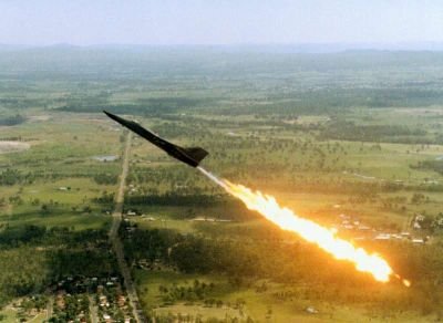

http://www.defencetalk.com/pictures/showphoto.php/photo/2442/size/big/ppuser/785
http://www.tim-beach.com/f111.htm
What's this got to do with the B-1R video? Everything, it and this are both fantasies that have no purpose other than to tickle the mind.

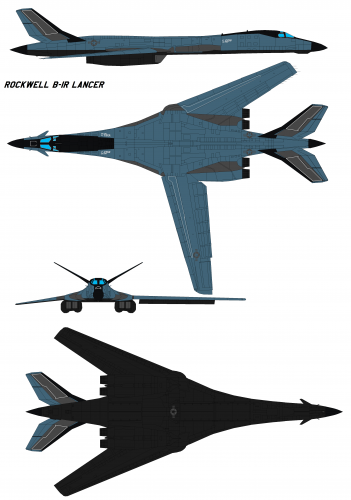

i put gun under nose becuse if there acting with in fighter role it might be good idea an way i seen some B-1B drives i would not put it past them to lock up some one just to to have bargaining rights after all they are pilots

The speed may not be for missiles per se. Wing kitted SDB's getting flung by a fast B-1 that's loitering is nothing to sneeze at, considering the available bomb load in the internal bays alone. Save the hardpoints for real missiles then? Don't forget that the B-1 is ostensibly the main test platform for the new high energy electric laser demo as well. So a DEW equipped B-1 (consume both forward bays), with SDB's in the rear bay and missiles on hardpoints makes for a mean beast. Engine inlet tricks like a previously identified compressing inlet mesh grid which can double as a blocker would work well with the nacelle redesign work to accomodate the new engines, and perhaps a diverterless inlet design as well. Now, do you consume a hardpoint slot for that Sniper XR pod, or integrate something like the F-35's EOTS nose module like Predator C does? If that Sandia work for laser guided .50 cal bullets pans out, we might see the return of gunships even.
A few unofficial drawings show a V or platypus tail for the B-1R, but if you are bringing in engines from another program, then perhaps getting in on the F-135 buy coupled with thrust vectoring nozzles could allow you to go tailless, and open up the tailcone for more defensive systems.
An underlying issue is LRS-B and nuclear treaties. If the nuclear mission gets offloaded to LRS-B, then it frees up B-1's for conventional work in not-too-hostile areas by declaring them non-nuclear. However, if I remember correctly LRS-B will not be initially nuclear capable, which pushes the chances of of a B-1R being made even lower.

i wondered why the B-1 in the video hadn't made use of its internal bays.. seems to me that designing a launcher for AIM-120's that slots into the existing weapons bay would offer better carriage options.. external racks seem rather limited and inefficent.
The engine nozzles are probably too close to the center of gravity for the thrust vectoring to be very effective.
