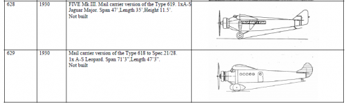

and I think the Avro-628 was also submitted to Spec. 21/28 as Avro-629,right ?.
Almost certainly. However neither is likely to have been considered acceptable as one of the key requirements for the mail carrier was high speed.

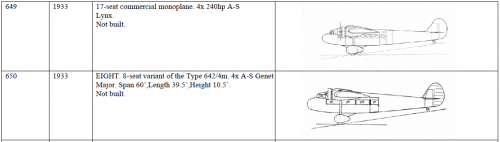

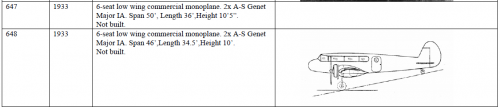

also Avro-645,Avro-647,Avro-648,Avro-649 & Avro-650,which specification they were submitted
to it ?.

These are civil aircraft so they would have been speculative projects aimed at the smaller UK airlines, such as Hillman, and the growing Australian market etc.
Yes,I see,but a big lost if they didn't intended for a specification.
That was fairly normal for the smaller British airlines in the 1920s and 30s. Their requirements were generally reasonably well known so formal specifications were not issued very often. Imperial Airways were slightly different at their routes were more complex so they did provide outline specifications.
I doubt that these Avro projects were developed to any great level of detail.

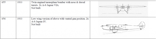

Maybe that's right;
and for Avro-655 & Avro-656,we have two Specifications, B.9/32 & 29/33 ?.

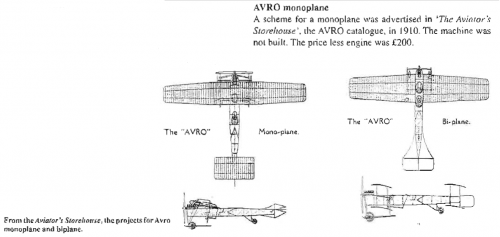

here is early Avro two Projects from 1910.
British Aircraft before The Great War

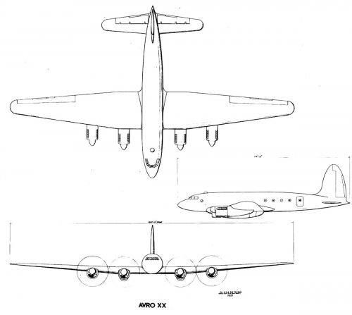

I can't imagine what the shape of Avro-687 ?.

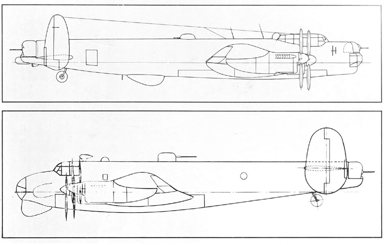

Really? It says it was based on the Type 694 (Lincoln) which will give a clue. What other transport projects were based on Lincoln flying surfaces? Ah, the Tudor Type 688. ;)
I think I posted a 3-view of the XX here somewhere. I'll check
edit. Here it is

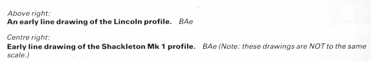

Avro also submitted a proposal for Spec. B.20/40,but no more Info is available ?.
Perhaps an updated version of the Type 676/Type 677?
From, Shackleton at War and Peace.

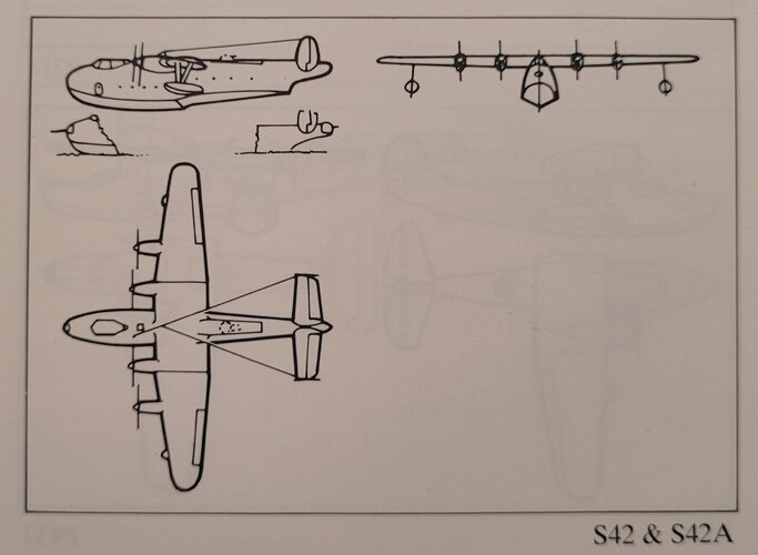

Curious, apart from the general shape of the main wings, I cannot see a Lancaster there.
From Putnam's 'Saunders and Saro', page 306 -7 :-
"Saro S.42 and S.42A
Submitted to Air Ministry July 1942. Employed wing and engines of the Avro Lancaster bomber married to a hull similar to that of project S.40.
S.42
Overload weight 70,000 lb, maximum speed 250 mph at 9,000 ft, range at overload weight 3,750 miles.
Armament: one cannon in nose, two machine-guns in dorsal turret, four machine-guns in tail turret.
S.42A
A freight versIon. Armament deleted. 35,800 lb cargo at overload weight.
Maximum speed 240 mph at 12,000ft with Rolls-Royce Merlin XX; 260 mph at 16,000ft with Bristol Hercules VI.
Not ordered because of the increasing use of landplanes in the transport role."
There's also a mention in Tagg & Wheeler's 'From Sea to Air', but i don't have that to hand atm . . .
From the illustrations it would appear that the S.42 uses the wings, engines and tail surfaces of the Lancaster, along with a modified Lancaster canopy. I wouldn't be surprised if various Lancaster system were employed as well.
