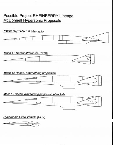

XP67_Moonbat said:
Here's the first image showning the Mach 6 methane interceptor and Mach 12 demonstrator. Remember this is all in an early phase. Eventually I'll get around to doing it on computer.
More on topic, nice work Moobat ! So, you saw that drawing of the Mach 6 GIUK Gap interceptor from that tech article too !
Thanks. Yeah I still remember article on AmericanAntigravity.com. Very informative. I still have the printout tucked away somewhere.
As for my drawing, I did it on AutoCAD. I just need to label everything and put a title block. I'll try and put it on here next week. Let see how busy I get in class.
Moonbat
Moonbat,
May I ask where you got the dimensions for the McDD vehicles in your first drawings, or are they your own estimates? I'd like to make a 3D model of the GIUK interceptor but haven't found any dimensions for the vehicles anywhere.
Also, if minor criticism is allowed, I think your Mach 6 interceptor is a bit too thin (or alternatively long). :)
They're my own guestimations, although in the Paul Czysz interview article BEYOND AURORA, he did mention that the "Mach 6 interceptors" (plural) were "on the order of 60 to 70 feet long." I'll have to go make some adjustments when I go back to school in the fall.
Now info on the Mach 12 demonstrator you can find here:
http://www.secretprojects.co.uk/forum/index.php/topic,2867.30.html
The whole thread's pretty informative. Enjoy!
Moonbat
Thanks, though perhaps I should have written "any more precise dimensions" ;)
Also, I'm just personally wary of basing the dimensions of the Mach 6 (or Mach 12) strike/recon vehicles on those of the demonstrator.
