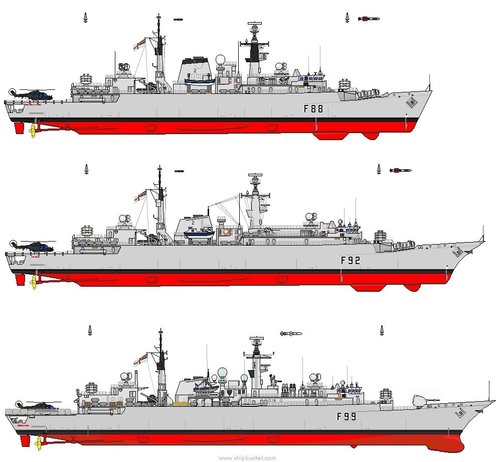

A Type 22 with Hood's suggested weapons fit would have been an interesting looking ship. One for Shipbucket?
I always thought DS.381 with the following changes would make for a very handsome and very powerful alternative history RN GP/ASW ship:
  1. Limbo removed to allow for a larger hangar and flight deck to accommodate a Westland WG.7
  2. A second Sea Wolf launcher installed between the Ikara launcher and the bridge (Type 22 style)
  3. Olympus/Tyne machinery (associated uptakes and enlarged funnel)
Especially as DS.381 was probably designed for the fully nuclear capable, complete with deep storage for the warheads, Ikara system that Bristol was designed for but never received. Bristol got a simplified system instead.

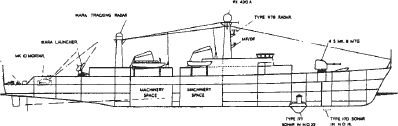

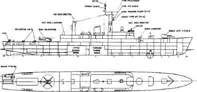

For reference. Three different Ikara ships featured in the 1966 Fleet Working Party study described in Rebuilding the Royal Navy by Brown/Moore
Fitting Ikara to the Type 22 would have needed the removal of the forward Seawolf launcher on Batch 1 and 2 ships. The Batch 3 would replacr the 4.5gun.
