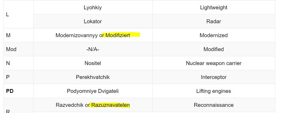

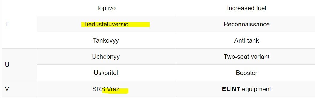

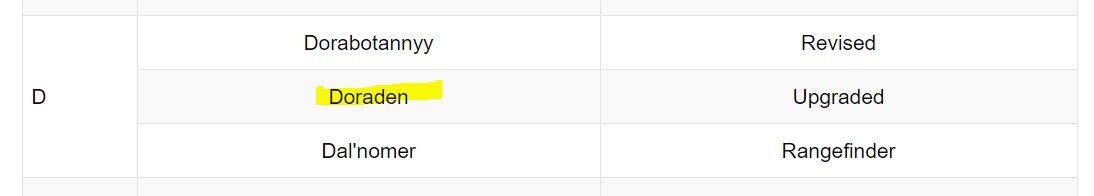

As a native speaker, I have many questions...

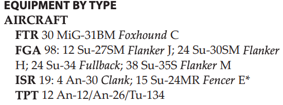

FLANKER G1 = Su-30MKK
FLANKER G2 = Su-30MK2
FLANKER G3 = Su-27UBK
FLANKER J mod = Su-27SM3
it makes no logical sense for 27UBK to be a G. It's probably a C. It also precedes MKK and MK2 chronologically so I think the author made a mistake.
