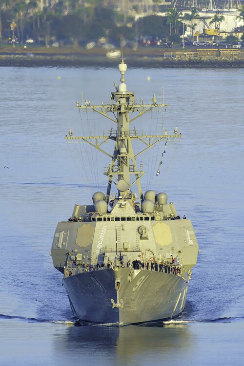

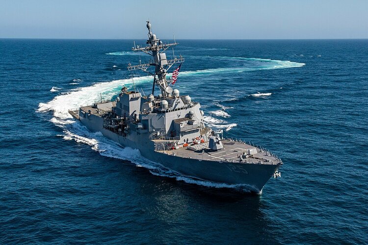

I'm no shipbuilder, but should anyone start having concerns about topweight and stability here? Trying to fit 10 pounds into a 5 pound bag. Is that added superstructure of aluminum construction?
I'm sure they've done the math here, but yeah, these ships are absolutely maxed out and may well need ballast.
My understanding is that a significant part of these new 'cheeks' is in fact empty space - an enclosure to make it easier to work on the SLQ-32(V)7 while the ship is underway. Though SLQ-32(V)7 is bulkier than past SLQ-32 versions, you can also still clearly see that it's not taking up the entire cheek and the enclosure is sort of a natural progression to what we've seen o DDG-125_acceptance_trials.jpg n older Burke's. Even if it's still ugly as sin.
