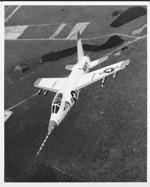

Just went to Pensacola NAS museum yesterday. Tiger is a very small, slim fighter more akin to an A-4 size than an A-7 or F-8. The F-3 was very thick and tall, closer to size of an A-7 or F-8. F-3 is not so small. Its amazing how tiny the Tiger is, seemed almost smaller in some ways than some F-5s I've seen. And like an F-5, it looks like a toy compared to most others. If anything the Tiger maybe should have been marketed as a contender for allied airforces as a light fighter. Two sidewinders look as if it would have been a heavy load.

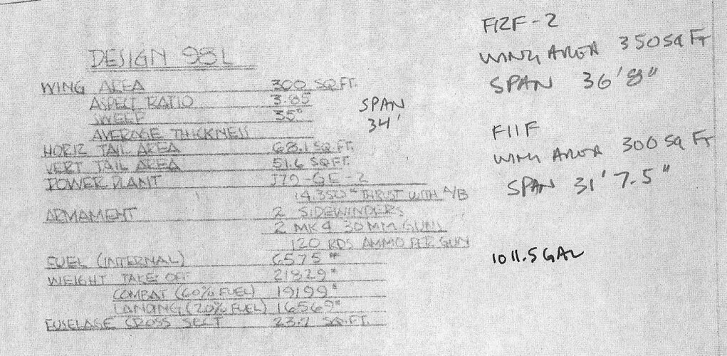

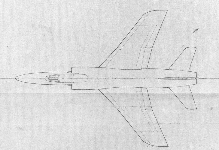

My fantasy aircraft in post 1 could be seen as a joint proposal by North American and Grumman (you know for the LOLZ), but lets work from something based on the 98-L for more serious discussion of putting a reheated Spey in this puppy. I will repost a couple of images for easy reference(they were posted pages back).
so the Spey is going to weigh 258 pounds/117 KG more than J-79... so with the 300 square foot wing and off loading a wee bit more fuel on launch all the prior work Orlovsky did in working out what CATS the 98-J could use should still apply.
