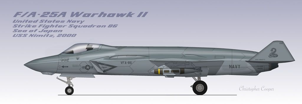

Mind you, I too did always find the McDonnell-Douglas/Northrop-Grumman/BAe team submission, very attractive. In fact, I had someone do some profiles of a developed operational version (developed along similar lines that the X-35 went through to become the F-35) for a story I did on another forum a while back:
***NOTE: Pure Fictional Rendering!***
