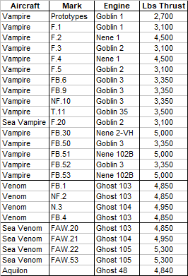

Note the engine names in italics... you put Goblin in one place where it should have been Ghost, and the Gnome is a late-1950s turboshaft that went in the Sea King.
Venoms (and Vampire FB.1) had Ghosts (4,400 lb.s.t. to 5,300 lb.s.t) - Goblins only produced 2,700 lb.s.t to 3,350 lb.s.t..
Nenes produced from 4,600 lb.s.t.* to 5,400 lb.s.t..
* This was the version in the Vampire F.2.
As you're criticising my poor proof reading skills. To my knowledge there wasn't a Vampire FB.1.

Over 10 years ago (more like 15) I had saved the data from this website: https://jet-engine.net/miltfspec.htm
It showed the following lines:
de Havilland Ghost 48 Aquilon 4,850 - - - - 1 - - 1C 1 - - - Notes - - -
de Havilland Ghost 50 XJ 29 4,400 - - - - 1 - - 1C 1 - - - - - -
de Havilland Ghost 101 Vampire FB.1/NF.2/NF.3/FB.4 5,060 - 1.020 - 87 4.5 - - 1 - - 1C 1 - - - Notes - - -
de Havilland Ghost 103 Venom FB.1, Venom NF.2/NF.2A 4,850 - - - - 1 - - 1C 1 - - - - - -
de Havilland Ghost 104 Venom NF.3, Sea Venom F(AW).20/F(AW).21 4,950 - - - - 1 - - 1C 1 - - - - - -
de Havilland Ghost 105 Sea Venom F(AW).22/F(AW).53 5,300 - - - - 1 - - 1C 1 - - - - - -

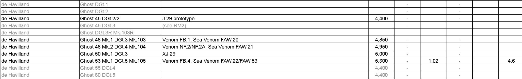

I just went back to the website, to find there have been several edits - with engine variants and designations changed... and none of the Ghost versions list "Vampire" as an application. Ah, well... that's the problem with internet sources.
Note: grey - denotes optional engine selection or no nominal application for engine, and I had deleted those in my copy.

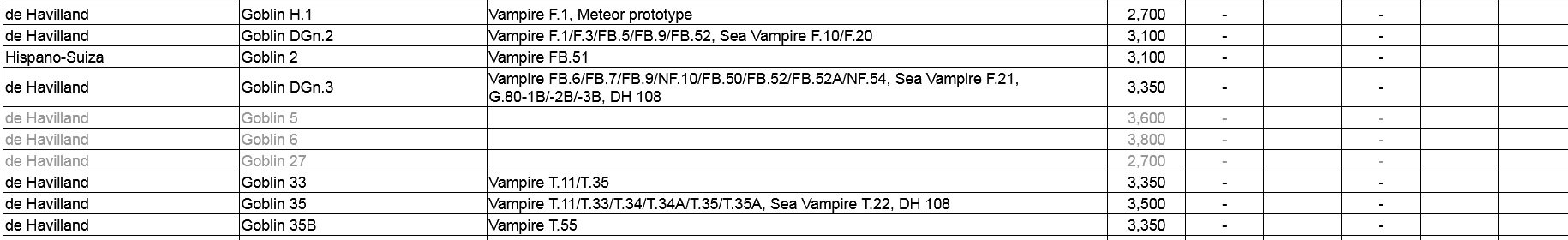

For comparison, here are my copy of the Goblin entry and the current one:
de Havilland Goblin DGu.1 Meteor prototype, Meteor F.2, F.9/40 2,700 - - - - 1 - - - - - Notes - - -
de Havilland Goblin DGu.2 Vampire F.1/F.3/FB.5/FB.9/NF.10/FB.20 3,100 - - - - 1 - - - - - - - -
de Havilland Goblin DGu.3 D.H. 108, Meteor F.2, Vampire FB.5/FB.6/FB.50/FB.52/FB.53, G.80-1B/-2B/-3B 3,350 - - - - 1 - - - - - - - -

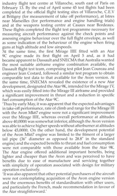

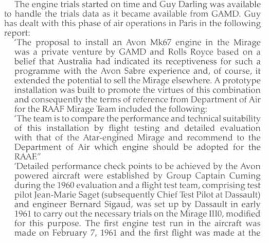

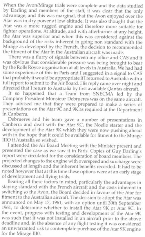

From here:
We have the following:
Image 12-2-2025 at 9.58 am.jpeg Image 12-2-2025 at 9.59 am.jpeg Image 12-2-2025 at 9.59 am.jpeg
Try also looking up "Comparison of Atar 9C and Avon mark 67 for Mirage IIIC for installation" in the National Archives. A full scan of the file is available online.
I had a look at that document, it appears that the Avon would have provided a fatter performance envelope. That said it wouldn't be a straight forward swap, development work would have to be done on the 36" afterburner and to fit the starter fluid which might be problematic.

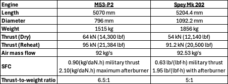

Not sure if a Spey version would have been beneficial. Doing a quick comparison:
Generally the Spey is a bigger, heavier engine thus necessitating heavier airframe structure. It also has lower thrust. airflow would be much the same so intakes for F1-M53 should be fine. Spey only really wins in terms of SFC though given the need for heavier airframe, I suspect that advantage would have been voided.
Thanks for the technical data for comparing the M53 and Spey, and thanks for your view.
I'm opting for the Spey for a few reasons and as you'd appreciate, that SFC you so kindly allude to, is one of the principle reason, given the necessity of range/endurance in and around the likes and size of Australia.
I'm also conscious, that at the time of the Mirage F1E/F1 M53, the M53 turbfan had only started flight testing started in July 1973 (using a Caravelle flying test-bed) and the engine first went supersonic in a Mirage F.1 test bed at the end of 1974. This means, if the RAAF went with the M53 engine, it's reliability wouldn't necessarily be truely reliable, unlike the tested and proven Spey Mk.202, which by ~1974 had been flying in RAF and RN F-4M/K Phantom II's for what, close to six years?
Again, as I've alluded in my earlier post, the notion is importantly the economics of commonality, with the RAAF and RAN operating respected derivatives of the Spey-powered McDonnell Douglas CA-4E/F Skyhawk.

We should be comparing the M53-2 (1976) which had 54.4kN dry (12,200lbf) / 83kN AB (18,700lbf) thrust, or the slightly improved M53-5 (1979) which had an improved reheat with 88.2kN (19,800lbf) thrust.
