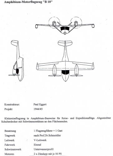

Hi guys,
I`ve just found this reference to a projected twin engined twin seat amphibian developed by this famous academy. You could see it here.
http://en.wikipedia.org/wiki/Akaflieg
It`s from 1944, one year after the remarkable B 9. Does anyone could add more on this? Thanks.
A RARA AVIS !!!
From a publcation of the Akaflieg Berlin
Designer was Paul EGGERT .
The purpose was travel after the war ,for instance following the storks from Germany to Africa : beautiful dream when we remember the Berlin of 1944 !

Hello Richard,
many thanks. What a beautiful bird this would be.
I think they were fixed.
Some elements of the fuselage were built !
Work ended in february 1945 !

Fixed! Hmm, ok so either there is a lot of inherant stability that I cant perceive, or the aircraft rests with one wing down and the other pointed at the sky... That'd make taxiing interesting.

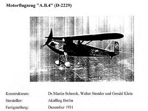

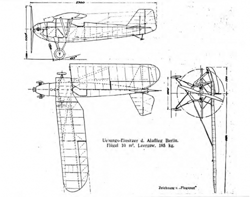

The FF or AB 4 is a well known very light hight wing single seater (D-2229) flown in 1932. and the B 9 prone pilot bimotor .
Here is the AB.4.
That tip float configuration eases docking.
Look at some of the Grumman Geese that were modified after WW2. They were retrofitted with retractable tip floats (ala. Consolidated PBY Catalina flying boat). When approaching floating docks, they retract both tip floats and "lean" on the outboard float. This lifts the inboard float well above the dock, preventing float damage or knocking dock handlers into the water. The raised (inboard) wingtip also allows them to dock with mere inches between their passenger hatch and the dock.
Floating docks are popular at fishing and logging camps along the West Coast of Canada.
