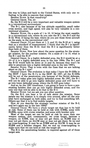

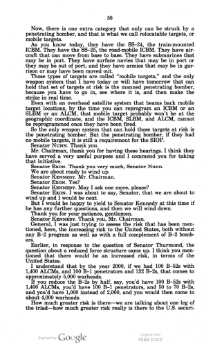

As far as the B-2 SRT mission, see attached from "Testing and operational requirements for the B-2" testimony. There are many other examples in the public record of the B-2 SRT mission.

As you might imagine this problem was studied to death at the time and the outcomes did not agree with that position. The B-2 was more than capable of accomplishing its mission given the current and projected threats at the time.
