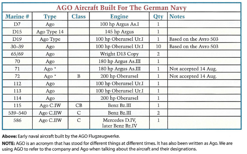

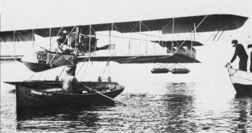

Indeed, my dear Hesham, there was a "D15", but this wasn't a type designation, but the German Navy registration of one of those Otto designs built by AGO. Hereby a photograph of the D15 I found on the internet some time ago (but where?).
The German Navy registrations till number 24 were preceded by D (Doppeldecker) or E (Eindecker).
From the AGO company there was also D7, another Otto type, and D19, an Avro 503 copy.

On the D15, what are the 2 cylindrical objects below the wing? auxiliary floats?
Your source for the photo could be the article at "flying machines": http://flyingmachines.ru/Site2/Crafts/Craft28888.htm
Not sure, that they were actually below the wing. The spacing and the fact, that there were two
of them, could indicate, that they were positioned under the twin booms, or better struts of the tail.
I think Jemiba is right.
I found the following in Schwipps, Schwerer als Luft - Die Frühzeit der Flugtechnik in Deutschland (1984), p. 222: "Mit seinen Bodenseetypen war Ago dann im folgenden Jahr beim Vergleichsfliegen auf der Marine-Versuchsstation Putzig in der Danziger Bucht erfolgreich. Auch hier handelte es sich noch um einen herkömmlichen Gitterrumpf-Doppeldecker mit hinterliegendem Motor und zwei Hauptschwimmern sowie zwei kleinen Stützschwimmern unter dem Leitwerk".
Other Ago seaplanes had only one auxiliary float under the tail.

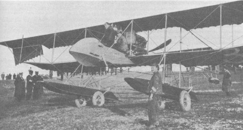

And here a photograph of a variant with a single auxiliary float under the tail.
It is the amphibian variant at the 1913 Bodenseeflug.
Source: Schmitt & Schwipps, 20 Kapitel frühe Luftfahrt (1990), p. 123.

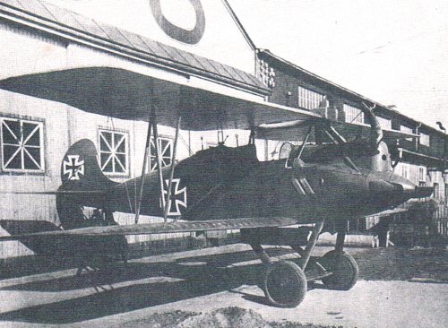

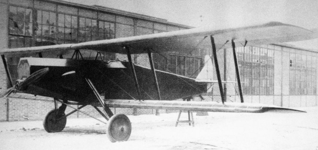

This one is identified as " AGO C V " ( 220 hp Benz Bz 4) in the "German combat planes" by Ray Wagner & Heinz Nowarra .
Both C V and C VI were develloped from the C IV: C V with a singele N strut, and C VI with two parallel struts.

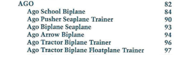

We can add for Ago list;
A.II,A.III,A.20,B,C.I,C.II,C.III,C.IV,C.IV,C.VI,C.VII,C.VIII,C.IX,School Trainer,Pusher Seaplane Trainer,Biplane seaplane,Arrow Biplane,Tractor Biplane Trainer, Tractor Biplane Floatplane Trainer,School biplane II,E.I,S,S.I,DV.3,D Recce ?,W,W.II,F-1 Seaplane,R-Project

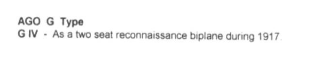

G.IV was a two-seat recce biplane of 1917 ?.
Do you have a source? This 'G/IV' designation is seen as an online typo for the AGO C.IV - "a two-seat recce biplane of 1917".
It's not C.IV,in the source,the C.IV was from 1916 and G.IV from 1917.
