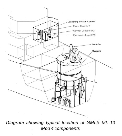

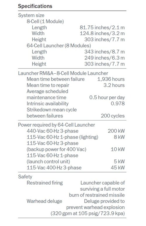

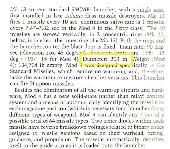

What OHP has 32 VLS? I have never seen one with more than 8 I will definitely need some sources on that claim if yours
No, nobody fitted an OHP with a 32cell Mk41 that I can find. Just the Aussies with an 8 cell forward for ESSM.
As for the single arm launcher it’s RoF is inferior to VLS, and it’s magazine capacity for SAMs is also inferior to VLS
point granted about the rate of fire being better for the Connies, but if we were designing the OHPs in the 1980s alongside the Ticos, they would have gotten a 32cell forward and Harpoons in a separate launcher.
Connies are basically the same weapons package (allowing for VLS differences) as the OHP in a package that is a LOT bigger.

How big is the Mk13 below decks? it holds 40 missiles and the center of the mechanism is open. volumetrically, there should be space for a 32rd Mk41 in there, even if you have to leave it with the mid-length cells unable to fire Tomahawks.
do you have sources for this information about the 32 cell VLS being able to fit?
Mk 13 magazine is 203" diameter...
Mk 41 8-cell is 82" x 125".
The smallest a 32-cell set can be packed in a square is 207"x207"*... so it does look feasible.
Thank you!
