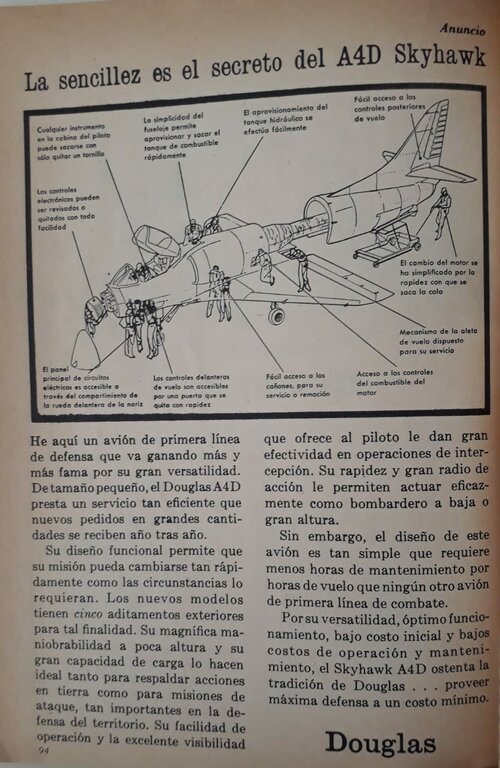

Ad from 1962
"Have here a first line defense aircraft thats gaining more and more fame, thanks to its versatility. The small sized Douglas A4D gives a service so efficient, that new orders for them in large quantities are made year after year.
Its funcional design allows it to change its mission as fast as the circumstances allow. The new models have five external supports for that purpose. Its magnificent maneuverability at low altitude and its great armament carrying capacity make it an ideal to support actions on the ground or for attack missions, so important as the defense of territory. Its easy operation and excellent visibility give te pilot a great effectiveness in interception operations. Its speed and great action radius allow it to efficiently act as a altitude bomber.
Nonetheless, the design of this plane, is so simple that it requires less hours of maintenance per flight hours than any other comparable plane. For its versatility, optimal operation, low initial cost, low costs in operation and maintenance, the Skyhawk A4D carries the Douglas tradition...provide the maximum defense at a minimum cost."
It really follows the "KISS" rule made by Mr.Heinemann (Keep It Simple Stupid!!!)

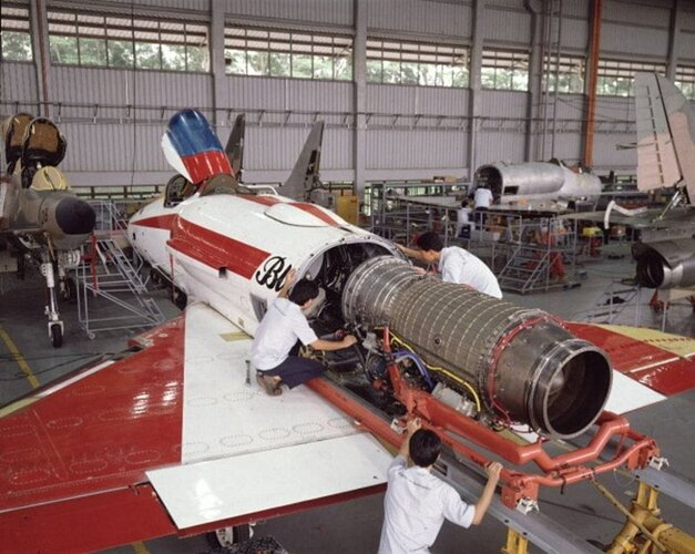

What you describes looks very much like the late incarnation of Singapore's Skyhawks. We had them training in Cazaux, near Bordeaux, for quite a long time. They have now been retired.
One of them was even donated to the local museum at Bordeaux Mérignac airport / air base 106, the CAEA.
