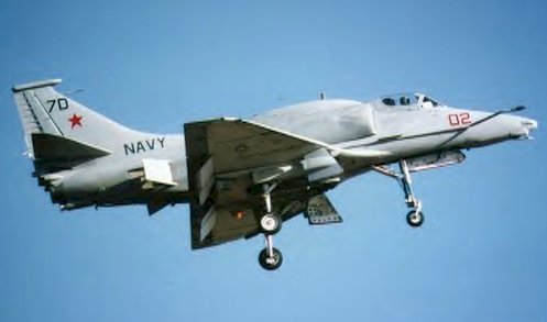

The a-4 was absolutely loved by its pilots. Cheap and versatile (less than 600k ea when first introduced) Heinemann's hot rod was built for simplicity, ruggedness and performance. It was even more agile than the Mig-17s according to pilots. The last F404 powered version for Singapore (A-4SU) was spectacular in its performance.
Any thoughts on a next generation, rugged, simple, and cheap A-4 type aircraft built with the same things in mind that made the A-4 so great?
For the modern day add some stealth features, light weight materials, an f404 type engine, flyby wire, advanced shaping, etc. Have an air to air version, strike version and possibly a STOL version for the Marines. (I know, sounds like the JSF) BUT KEEP COST DOWN and the aircraft small like the A-4 was.
I talked to a person in the Navy who wasn't a big believer in the modern ever increasing complexity and cost in the new systems. He said many wanted more of a "numbers" philosophy that the A-4 represented, badly needed today. He also said many times on the ships the encrypted communications systems would fail or be jammed, and the simple morse code transmitters (80+) years old, would be able to punch thru the jamming for ship to ship and ship to aircraft communications. Just something to be said about simplicity in combat, and the things that work. That was the underlying philosophy of the A-4.
Anyway, back to the A-4. Would like to see some personal sketches of you're idea of a 21st century/modern A-4 would look like. I will add some of my sketches if others are interested, and are A-4 fans.

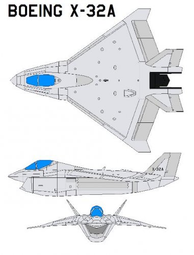

Here's my suggestion...
1) Have Boeing dust off their X-32 JSF design--not the proposed production model, but the delta-wing design that actually flew which didn't meet the revised maneuverability requirements but carried lots of fuel internally.
2) Strip out anything related to the STOVL variant and create a single CTOL/STOL version suitable for carrier use or, with double wheels/bigger tires, STOL use from short, rough strips.
3) Dial back the avionics to use instead off-the shelf, current-generation equipment from various aircraft in service right now, focused on a primary attack mission with secondary air-to-air capabilty for self-defense.
4) Offer the new Boeing F/A design as a capable, stealthy strike aircraft, an alternative to the F-35 at half the price.
;D
Wouldn't be much point to the Boeing JSF without STOVL. Engine is in the front to accommodate direct lift.

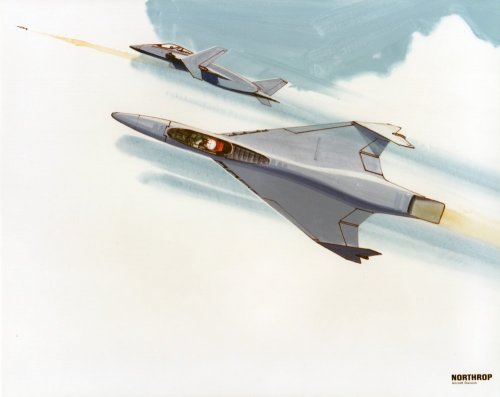

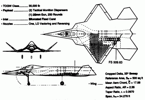

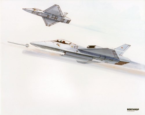

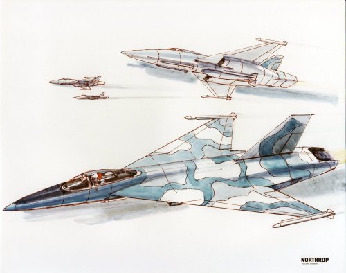

Northrop had some appropriate ideas... e.g. Cooperative Fighter, Missileer, Compact Efficient Fighter.
Co-operative fighter takeoff weight is 17,700lb which is squarely A-4 class. Add a bit more stealth shaping, single afterburning F-414 engine, and Bob's your uncle.

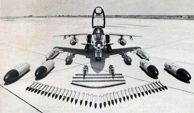

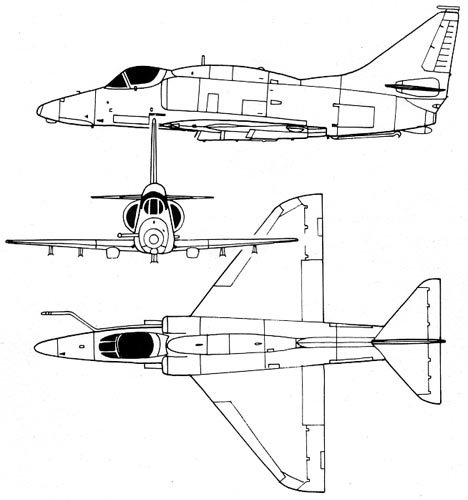

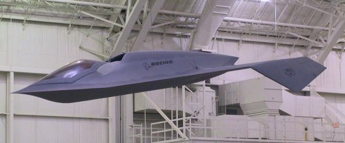

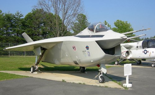

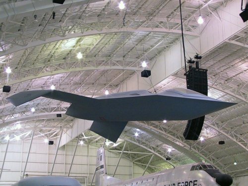

Modern A-4 ?

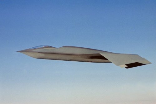

;D
Mole, I liked the x-32 for a number of reasons too. The one-piece wing that was CHEAPER, easy to make (I think they molded it together like a Rutan design!) and held tons of fuel, I liked the lifting body shape of it too. It just wasnt popular and the brass thought it was UGLY. I think the STOVL would've worked too--as good as the Harrier--, but not as good as the F-35, even though it is a Billion times cheaper/simpler to build direct lift like the Harrier/ x-32 had.
Now, get it down to the size of the A-4 and I'm interested.

kcran567 said:
Modern A-4 ?
The Boeing Bird of Prey was a pure test-bed and wouldn't be any more combat capable than the X-1. You can't have a tiny VLO fighter because of the necessity for internal weapons and fuel... period. The principal Mr. Heinemann used for designing the A-4 was "take as much as possible out of the airframe." In order to do so, he actually contributed more than most people realize to the modern concept of external stores. With VLO platforms, the principal is opposite; everything that would normally hang out the outside (largely thanks to Heinemann's innovations) has to go back inside.
2IDSGT said:
kcran567 said:
Modern A-4 ?
True enough, but then again the trend toward smaller and lighter smart weapons also means that a modest internal ordnance load can be remarkably effective. Just 500 kg payload gets you:

Wow, the Gnat looks very small. Really like these types of aircraft though. Max ToW 9200 Lbs.
The A-4 empty was around 10,000 Lbs and fully loaded with fuel and weapons at 24,900+ Lbs Max ToW
I don't know if a modern Gnat is do-able at this time, maybe when anti gravity engines are available :)
But an A-4 type with smaller higher thrust engine, light materials, smaller weapons like Mole said seems a great idea!
  • McDonnell Douglas A-4 Skyhawk
    – single seat, carrier-based light attack bomber
  • First flight – June 22, 1954 (XA4D-1)
  • Total production – almost 3,000 over a 26-year span
  • Powerplant – one Pratt and Whitney J52-408
    - (A-4M version), 11,187 pounds thrust.
  • Wingspan – 27 ft., 6 in. (8.38 m)
  • Wing area – 260 sq. ft. (24.16 m2)
  • Length – 40 ft., 4 in. (12.29 m)
  • Height – 15 ft., 10 in. (4.57 m)
  • Weight – 10,800 lbs. empty
  • Maximum takeoff weight – 24,500 lbs.
  • Speed – 677 mph at sea level
  • Ceiling – 40,600 feet
  • Armament – two MK-12 20 mm cannons
    and up to 10,000 lbs of bombs.

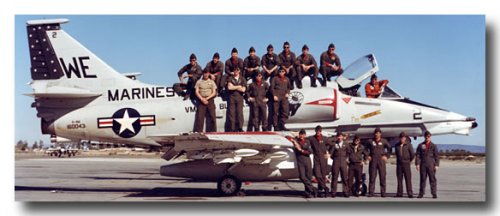

bring the A-4 back
means to bring robust airframe, simple mechanic system and Instruments,
that imply also the flight computers !
oddly, there were US pilot very happy about this uncomplicated A-4 system.
The pilots of US Blue Angels, how switch from F-4 Phantom to A-4 Skyhawk.

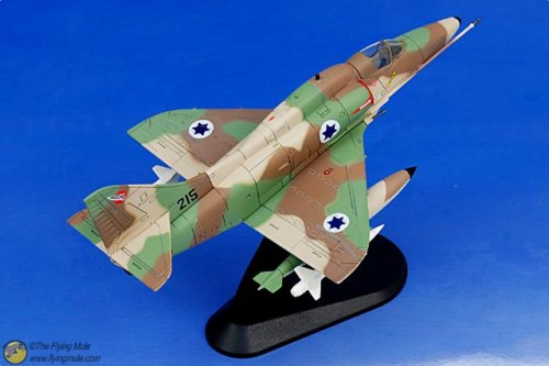

Wasn't this already done?
The RNZAF did up the Kahu modified A-4. Wonderfully capable aircraft with HOTAS, glass cockpit, 1553B data bus, AN/APG-66 radar, INS, Maverick, and LGB. The wings were reskinned and the wiring replaced. The only things that were missing are OBOGS (A-4AR) and re-engining to the F404 (as done with the A-4SU Super Skyhawk).
It is interesting to note that A-4SU aircraft of 142 Squadron won the annual Singapore AF Hotshot competition in 2005, a month before retirement, against F-16s.

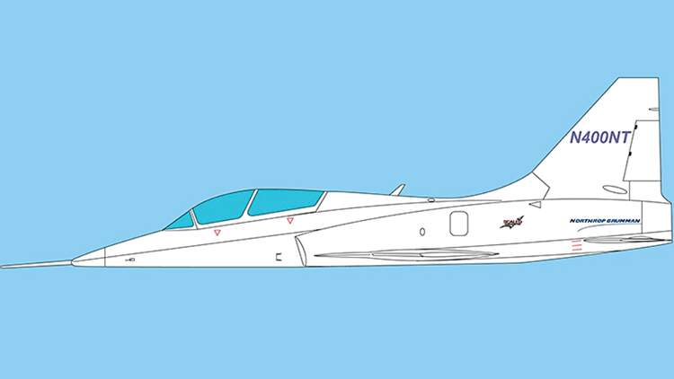

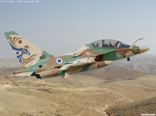

The A-4-like market is covered by armed jet trainers (Hawk series, L-149, MB.339 - even single seaters!).
The concept of a simple, agile and austere ground attack aircraft is not fit for a modern battlefield because such an aircraft would be too vulnerable to modern air defences. The A-4 already struggled badly in face of ZSU-23-4, SA-7 and SA-6 = 1960's threat systems.
The sales for such jet trainer-derived aircraft are few in part because the military niche is limited to bush wars, and even there you would do much better with a small cargo aircraft with plenty civilian peacetime uses plus a gunship kit for wartime use.
Don't grow a crush on sexy concepts based on sexiness; do a tactical-technical analysis and find the niches of practicality (tactical feasibility, fiscal feasibility, superior efficiency compared to alternatives).
Since all of the other exciting threads are too politically charged today ::)

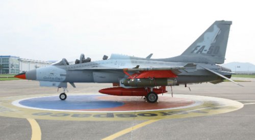

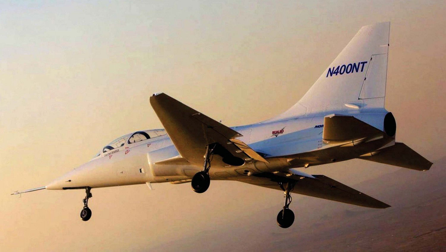

I offer what I think are two excellent canidates for the "New A-4"

The T-X designs do seem to have some potential, more than the Scorpion IMHO. Essentially the T-7 Red Hawk is a « T-50 equivalent » with very modern aerodynamics. But my favorite candidate would be Northrop’s N400NT... light and super simple with a non-afterburning F404. Takeoff weight clean is 15,400lbs, almost spot on compared to an A-4. I could totally picture adding some wingtip AAMs and a light bomb load.

The challenge is designing an airframe that looks stealthy and has internal weapons bays that can carry a variety of latest generation ordinance ... BUT ... expensive accessories and avionics are only sold to wealthier nations that can afford them.

Why not a modern take on the Northrop N-102 Fang?
-a General Electric F414;
-fly-by-wire flight control system;
-diverterless supersonic inlet;
-AN/APG-80 AESA radar;
-composite materials incorporated into fuselage and wing.......

e.g. Any Air Force still operating F-5s, Su-25s, light attack / trainers. Many of these can’t afford more than half a dozen aircraft or so, so not a great market…
I don’t think this would be a fighter aircraft… there’s already the FA-50, JF-17, Tejas for that.
--one 1,000 lb or two 500 lb bombs, smart or dumb, iron or cluster or napalm;
or
--four GBU-39 small diameter, GPS-guided bombs;
or
--14-19 70mm rockets in their launcher(s) (more or less, depending on warheads) with the option to go for compatible precision-guided rockets;
or
--two AIM-9 Sidewinders and two AIM-120s AMRAAMs;
You get the idea. So a total payload of 1,000 kg or even just 500 kg can still make for very effective light strike aircraft. VTOL or STOVL capability is not necessary for the majority of small air forces around the world, but simple STOL capability and rugged landing gear would allow for flexible, and when necessary, forward basing.
