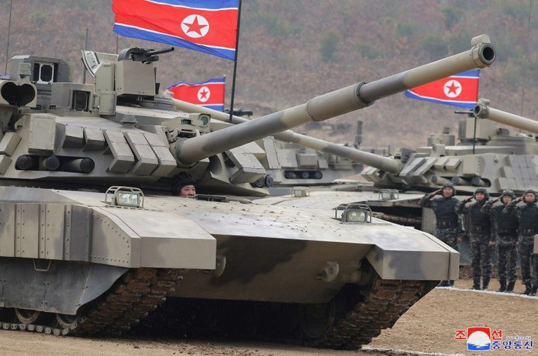

One of the thins that he say, that the tank have a 4 crew turret with a 115 mm gun
DPRK has been building tanks with 125mm guns for decades, so i would find incredulous that they would return to 115mm for some reason.
With all the electronic gizmos these days, i would think it would be possible to accurately measure the gun calibre from the pictures seen?

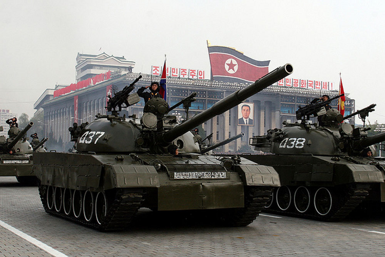

Songun-ho​
This is a 125mm gun

M2020
seen don´t have the same gun.
Im not a expert, im only say what he said in the video.
The turret is a 4 crew maned, and se claim that he heven saw a 125mm manual loding.
Looking that gun is to small for a 125mm, maybe a long barrel

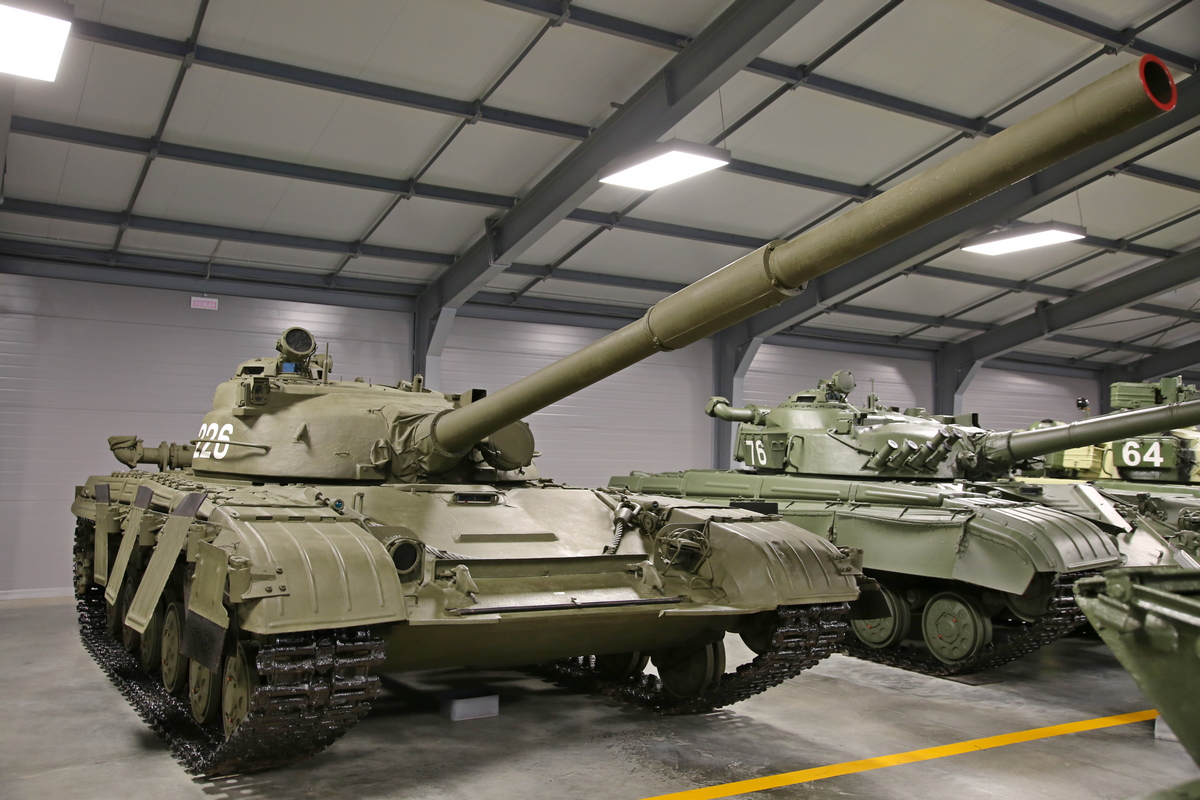

Crew of 4 in the tank makes me think T-62 based. Which means 115mm gun.
Just because it MAY be derived from a T-62 doesn't automatically make it still a 115mm cannon since they can obviously accommodate a larger 125mm barrel (see any number of T-62 upgrades marketed over the years).
The M-2020's barrel is also noticeably distinct from other more recent North Korean designs like the Songun-915, with the bore evacuator being in a different position along the barrel (somewhat closer to the turret) plus the likely sighting mechanism added at the tip of the barrel.
Plus the vehicle's overall dimensions, road wheels, hull shape (especially the front which extends further forward with a completely different slope), etc are also quite different. Calling this newer tank "T-62 based" at this point would be the equivalent to calling late-production T-72 or early T-90 tanks "T-62 based" since that family of tanks also descends from it....

What that even means? Various Chonma tank variants had completely new welded turrets for decades (plus new chassis with 6 wheels and so on).
If anything, the new tank might be a descendant of the 125mm Songun-915, new chassis with 7 wheels, new welded turret housing the 125mm gun etc.

Well, the reason may be that Songun-915 was an attempt on a heavier, different tank more or less based on an incomplete t-72 TOT from the Soviet Union.
If M2020 simply continues the good old t-62 development line - 115mm gun is where it always was.
M2020 very clearly spots it: it's visually U-5TS, not the D-81T; the latter even without a thermal jacket just looks different.
There is nothing wrong with it anyway - while 115mm gun is weaker and much less accurate at extended ranges, it, on the other hand, can have long rods, just like 120 NATO. And for longer ranges, M2020 has those big ATGMs anyway.

I'd rather have a 115mm gun with 750mm+ long rods rather than the ~500mm long rods out of the 125mm 2-piece ammo.
North Korea never received transfer of technology for T-72 because it never got license for it in first place and they only got at least one example of it between 1985 and 1992 from Iran that captured it from Iraq during Iran-Iraq war of 1980 to 1988 along possibly perhaps maybe T-80BV from Belarus in early 1990's.
All main battle tanks that North Korea has in active service do not have autoloader and have four crew members including Songun-ho that has 125mm smooth bore 2A46 cannon while do keep in mind if thermal sleeve/jacket/shroud was put on 115mm then it would be hard to distinguish between the two without scrutiny.
Another is since Songun-915 has no autoloader thus has 4th crew member that is human loader hence no limit on length of APFSDS which Soviet and Russian main battle tanks have due to carousel autoloader limited by inner turret ring diameter which is not the case with Songun-ho because it is manually loaded along turret ring such as of T-62 that is far larger than T-72 and bigger than both M60 and M1 Abrams.
Longest APFSDS projectile for 115mm is 640mm and can penetrate 500mm at 2km.
Those antitank guided missiles mounted on right side of turret on swivel mount are Bulsae-5 that are clones of Russian 9M133 Kornet and it is possible components of fire control system of that weapon are integrated into commanders cupola sight which includes 1PN79 series thermal optics, laser range finder and illuminator.

D-81 without thermal jacket:
it's a very distinctive gun even if naked.

125mm smooth bore cannon barrel of 2A46 outside turret of tank in millimeters:
4400 ~ 4600 - T-72 ( depending on model, turret cheeks thickness of T-72B versus T-72A aka T-72M1 ? )
4600 - Songun-915
115mm smooth bore cannon barrel of 2A20 outside turret of tank in millimeters:
4200 - T-62 ( early model 212mm turret armor )
125mm or 115mm smooth bore cannon barrel outside of turret tank in millimeters ?
5000 - Chonma-216
5100 - M2020 ( most conservative estimate )
5600 - M2020 ( conservative estimate )
