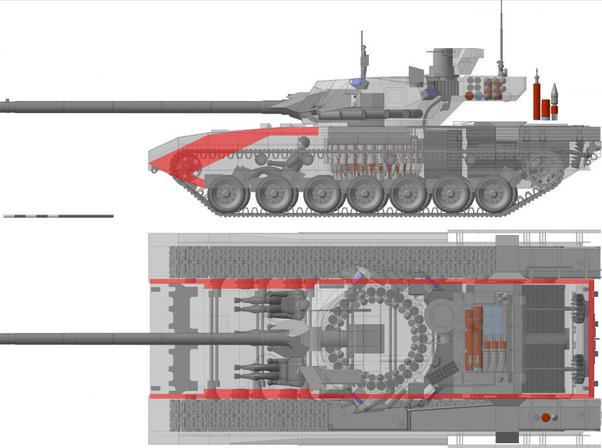

It's most likely that the Norks engineers took design cues from Armata and ported the APS layout to a manned turret. All in all what the little armour coverage said engineers removed at the bottomost corner is barely comparable to the gigantic hole they made right next to the gun mantlet which I haven't seen anybody complaining about...

I'm going to guess since modern-day Russian and Chinese tanks are still using the carousel there is a high probability that they are using the same concept since North Korea likes to copy other nation's creations. This is the T-14----------------- 1710804485594.png
