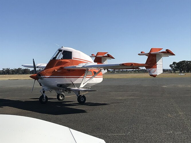

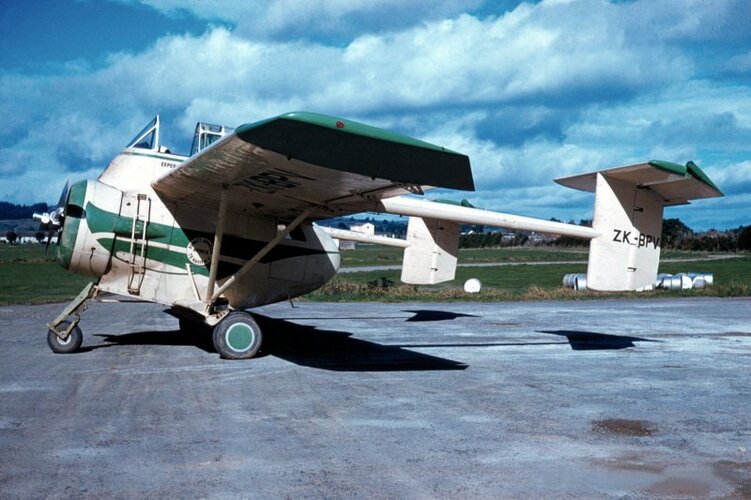

New Zealand is hard to beat on the ugly aircraft front:
Bennett Airtruck
Which was developed into the Aussie Transavia PL-12 Airtruk

Edit on the ugliest aircraft ever...i've just read Chris' book again and he mentions the Blackburn P.139B as being 'condidered to be the ugliest aircraft to come out of a British aircraft manufacturers design office'. He then goes on to describe some other competing designs for NAST.6166 and....well........
Bennett Airtruck
Mhhh, some of the other designs Chris lists look a bit like these.......
