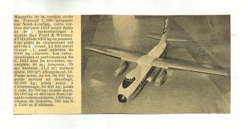

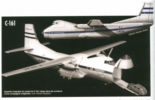

Dear Boys and Girls, here is an earlier description in French of the Transall C-161 as a short-range commercial turboprop freighter. It shows the degree of commonality with the standard Transall C-160 airlifter......
The article comes from the 15th March 1967 issue of Aviation Magazine International......
Terry (Caravellarella)
  • Transall C-161 - Aviation Magazine International - No. 463 - 15 Mars 1967.......jpg
Smashing, Terry!! But you forgot to say something: « This is not "secret" but it is a "project"... » ;D ;D ;D ;)

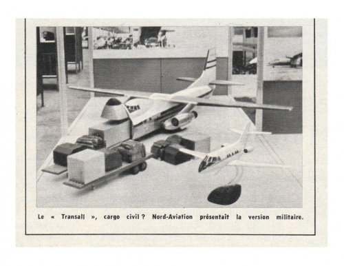

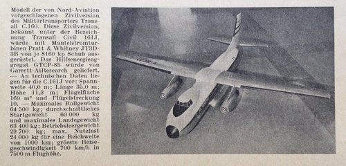

Dear Stéphane, I'm so inconsistent ;D. Here is a picture of the Transall C-161J as displayed and promoted by Nord Aviation at the Turin show in June 1968; I believe the smaller jet model displayed alongside is the original design for the Sud Nord SN.600 Corvette......
The picture comes from the 1st July 1968 issue of Aviation Magazine International......
  • Transall C-161J - Aviation Magazine International - No. 493 - 15 Juillet 1968.......jpg

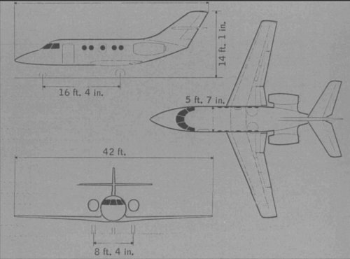

I think so, too. In Aviation Week May 1968, there was a 3-view of it. The prototypes and
series aircraft had evenly allocated windows.

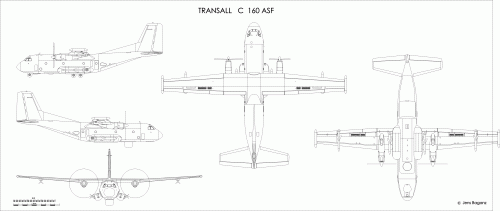

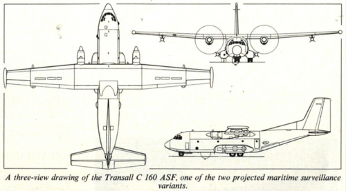

From Air International 4/1981,
the C-160ASF projected variant.

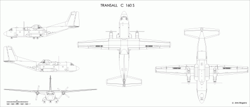

The C-160ASF was an armed version of the proposed C-160S for sea surveillance, fitted with a search radar,
several observation blisters and launching tubes for smoke and other buoys.
In the ASF a retractable radar under the fuselage and pylons for up to four AM 39 Exocet missiles or other
stores (e.g. homing torpedoes) would have been added.

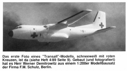

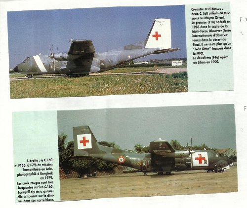

From Flugzeug 01-1990,
was this an amblance version ?.
Hi Hesham
From "le fana de l aviation"
humanitarian mission

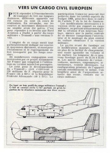

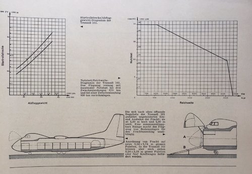

The C-161;
C160 Transall de 1967 a nos jours
