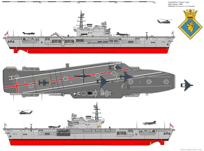

Hermes has a special refit 1964-66 in which one of the BS.4s is removed while the second is replaced by a 151ft stroke BS.5 and a 199ft stroke BS.5A is fitted in the waist. She also receives a Type 984M radar, ADA & DPT. Centaur is brought the same standard in a 1967-70 refit that also sees her upgraded to operate Phantoms. Hermes is Phantomised in a £25 million refit 1971-73 instead of being converted to a commando carrier. Meanwhile, it's decided to refit Albion to Standard A instead of Eagle. The refit takes 5 years and costs £31 million, but the ship carried the same size air group as Eagle with a smaller crew and had an AC electrical system. This ship was Phantomised in the late 1960s or early 1970s too.
Thus the RN had 3 Phantom capable strike carriers which saw it through the 1970s and were replaced in the 1980s . . . Wait a minute! I'm having an attack of déjà vu!

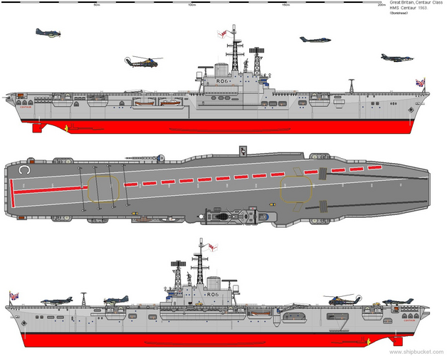

Centaur
Hermes

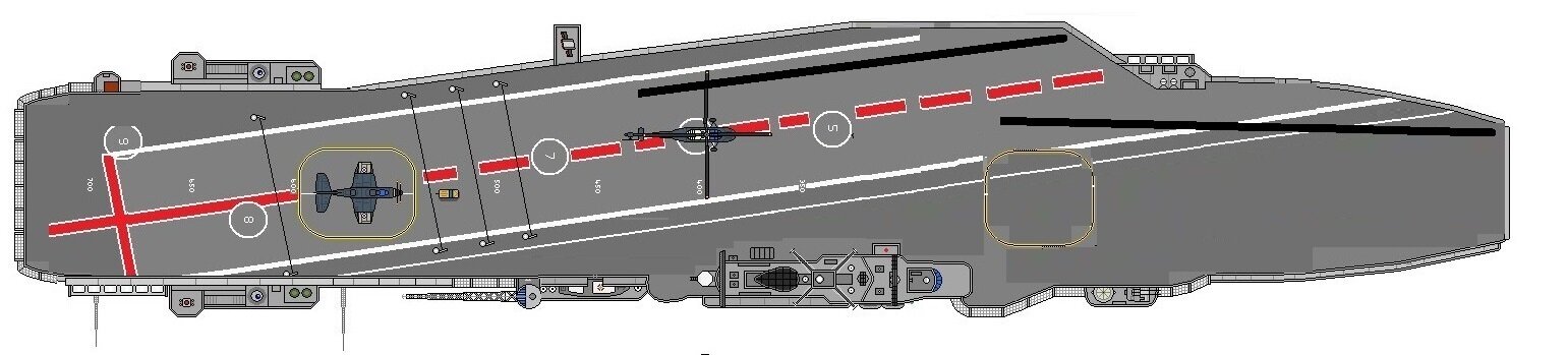

Your idea is something like this
I have in my mind, a question about the posibility of refit the Centaur witn the angled deck of the Hermes.?
One thing I do was using the modification some thing of the Black Bat242 (moving the foward lift and 2 cat

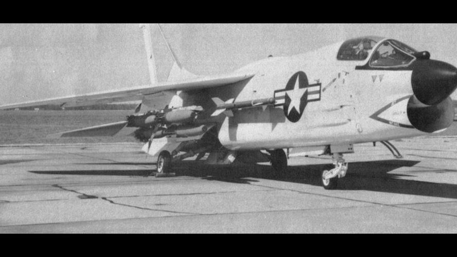

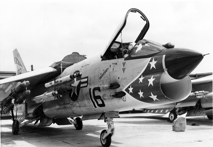

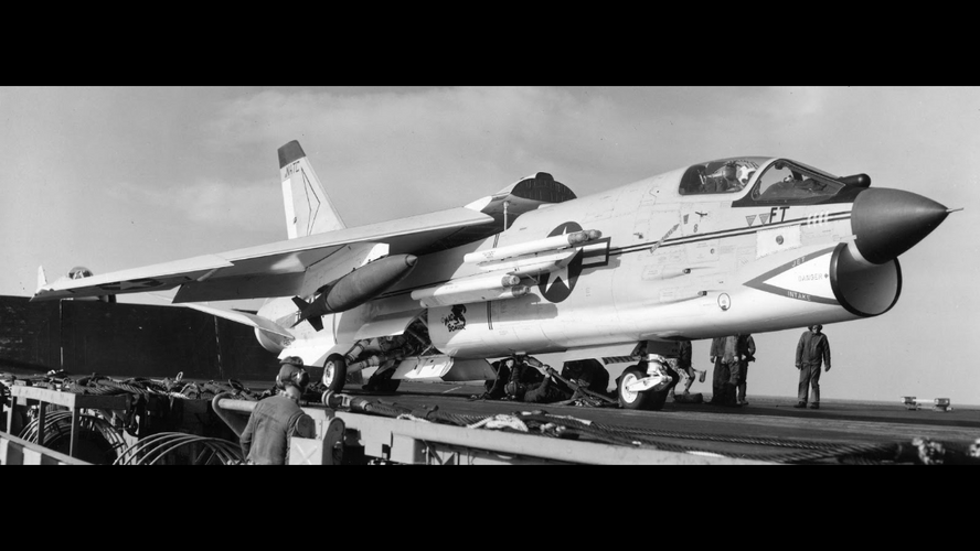

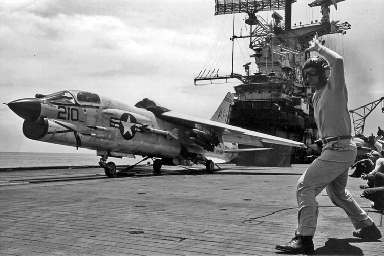

With the caveat that the F-8 would need at least the 175 ft bs5, better the 199 ft version.
Why so? The 150ft BS5 as on Clemenceau should be sufficient for launching F-8s in air defense configuration. Hermes' extended 175ft port catapult would be useful for A2G loadouts.
Here is what I have in mind for the Centaurs... same angle deck and catapult arrangement as Hermes, but retaining the centerline forward lift. I also added a deck park behind the island.
Dont forget that you can use the F-8 as a ground attack plane

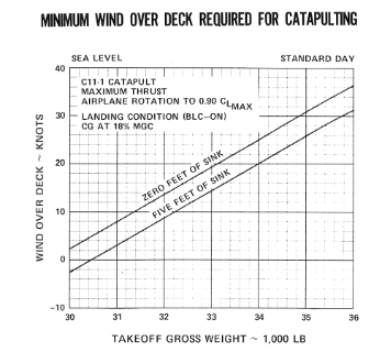

I think we have to take the F-8J as starting point, not much room for further carrier optimization.
Hopes for performance due to Spey did not materialise with the F-4K.
Internal fuel, 4 sidewinder: ~32k lbs
CAS: ~34k lbs
This means 8 resp. 20 kts wod with the c-11 catapult.
For the 157ft BS4 on the Clems add ~25 kts. Fighter ~33 kts wod. Which probably caused the switch to:
The 169ft high pressure BS5 on the Clems - add ~12 kts. Fighter ~20 kts wod.
For the 199ft low pressure BS5 on Ark etc add ~12 kts. Fighter ~20 kts wod.
For the 151ft low pressure BS5 on Ark etc add ~25 kts. Fighter ~33 kts wod.
For the planned 175ft low pressure BS5 on Hermes add ~18 kts. Fighter ~26 kts wod.
The latter is rather marginal with 25 kts ship speed and maybe another 5 kts needed in tropical conditions. Might work if you manage to squeeze another few kts reduction out of the design.

Various Folland Gnat developments.
Blackburn Buccaneer variants.
Saro scaled up for twin Gyron Junior or single Gyron offered at the last minute to a desired revised F.155.
Due to fusilage increases in cross sectional area, structural weight and weight shift.
F8 wouldn't suffer such in any detrimental form.
Getting reheated (water injection) thrust over 20,000lb static ought to offset lower pressure catapults
Assuming that is correct as it might more relate to acceleration limits of the airframe.
Again having new build for RN carriers ought to allow strengthening for higher acceleration on the catapult.
Potential thrust increases might follow the real world mk205 engines to 25,000lb
The Spey has a higher air mass flow I think. So redesign the inlet.
A larger radar? Redesign front section/nose.
We all know the history of UK aircraft procurement. F-8K will suffer the usual problems.
As for catapult performance:
- I don't think airframe limit is a problem, the F-8 being launched from the more powerful C-11 or Clem BS5.
- Usually engine power is worth 3-4 kts. Full AB launch allows a few kts reduction, maybe from the safety margin.
- I think the SAC is based on stall speed+safety margin vs (full) catapult power+engine allowance.
For the 151ft low pressure BS5 on Ark etc we have with the F-8J Fighter ~33 kts wod, CAS ~ 45 kts. Tropical maybe +5 kts extra.
Can you bring it down more than 10 kts?
