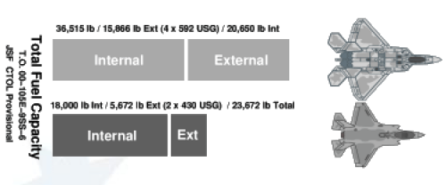

Where do you get the 14,400 lbs of fuel from? According to Technical Order 00-105E-9 Segment 12 it's ~20,700lbs of internal fuel (3082 gallons). ??? (Yeah, I've seen the 18,500 figure too but don't know the original source of that.)
Where do you get the 14,400 lbs of fuel from? According to Technical Order 00-105E-9 Segment 12 it's ~20,700lbs of internal fuel (3082 gallons). (Yeah, I've seen the 18,500 figure too but don't know the original source of that.)
I was using the 18,000 lb figure. However, for the purpose of being accurate I assumed the aircraft to spend 10% of its fuel for take of, acceleration to Mach 1,5 before the mission. Then after on return to use 5% for landing and 5% for emergency situation.
14,400 is 18,000 - 20% ;)
Its the actual fuel you have available for super-cruise assuming you do not have a tanker to help you.
0.664 lbm/lbf/hr seems like a rather low value for the F119 SFC cruise, just based on comparison with other engines.
As I explained in my post, I believe the F-22 is on about 82% throttle setting when doing Mach 1,5 at 40,000 feet. SFC is bond to be at most 88% from the full dry setting of 0,8 lbm/lbf/ht, hence 0,664.
The 18,500 lbs figure is from USAF. While the fire fighting TOs say 20,700 lbs they are wrong. Most likely because a fuel tank has been deactivated - its there in the aircraft but you can't fill it with fuel but the fire fighters take note of it anyway.
Actually, sfc @ M = 1.5 and 35-40 kft would be around 1.2 - 1.3. But then, military thrust under these conditions would only be half of the static sealevel value, so both mistakes cancel. (Data from D.P. Raymer. Aircraft Design, Appendix E, p.855)

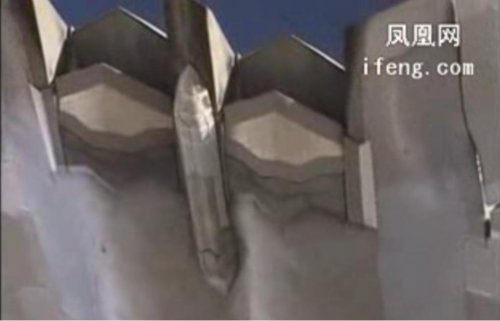

This is a very interesting speculation. Because of weight concerns the USAF deactivated/removed several of the fuel tanks so the aircraft can meet a certain performance requirements. That means if additional engine power if obtained trough upgrades, the fuel tanks can be activated/instaled.
Sort of like an internal fuel expansion slot. Very clever. I hope its true.
If it's from a public consumption document from the gov those things are mostly BS. They have the Seawolf at 800 foot diving capability and 25 knots speed. HARM at Mach 2 at 25 mile range, and so forth. I'd be far more inclined to believe a TO than a sanitized, guaranteed-not-to-get-anybody-fired doc released to the public on a government home page.
What source do you have that is better than a TO?
There is at least one very respected author/engineer who will very much disagree with you. His name is Dr. Carlo Kopp and he's got plenty of analysis of the case for/against F-35 to justify his point of view.
Some would strongly dispute this comment. Please remember that CK is extremely biased.
Regards,
Greg
USAF's offical statements and those from Lockheed to Congress... There are many different types of technical orders. That people like APA cling to a TO for firefighters as the basis of their capability analysis of the F-22 is not a good idea. If the F-22 could carry 20,000 lbs of fuel it would have better range than it does now.
I'd be interested in the relevant cites.
USAF Requirements Office confirming that the data on the F-22 fact sheet http://www.af.mil/factsheets/factsheet.asp?fsID=199 is correct and the Fire Fighting TO is wrong. Of course you can think this is all a conspiracy to fool the North Koreans just like the moon landing...
Fuel Capacity: Internal: 18,000 pounds (8,200 kilograms); with 2 external wing fuel tanks: 26,000 pounds (11,900 kilograms)
However the clincher is of course the publicly released radius of action figure http://www.f22-raptor.com/technology/data.html
Combat Radius (NM) Mission 1 (Sub+Super) 310+100nm
Which one hopes the F-22 can perform with 18,000 lbs of fuel rather than the more thirsty 20,000 lbs...
However if you do wish not to accept this or any of the other data released by USAF and think its all lies (which I'm sure Congress would not be so happy to hear about) then I can refer you to somewhere you may be happy:
http://worldwidewarpigs.blogspot.com/2008/10/air-force-association-takes-5th.html
In this fantasy world of F-22ism you can feel free to edit the flight envelope as you see fit.
Had to fix this one. I added the red part. The graphic is an approximation, but much closer to the aircraft's real envelope.
When you believe in something so much anything can happen...

I've seen the f-22 nozzles from its underbelly view many times, but only until today did I see this (don't know what's wrong with my eyes). It's a small tube shape right between the 2 exhaust nozzles. Does anyone know what it is and what's its function?
