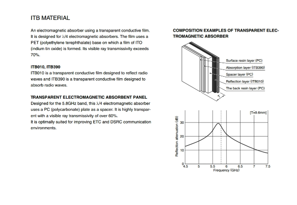

technically speaking, there are transparent RAM

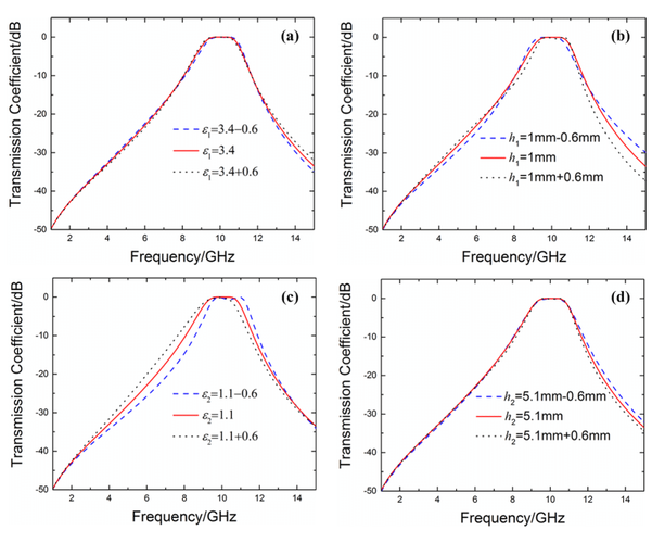

The short answer is frequency selective radomes. Which are very difficult to get right.
Yes I am aware, they in the end are band pass filters with certain attenuation characteristics. For example:
Sensitivity-of-the-frequency-response-of-the-FSS-radome-to-the-variations-in-structural.png
Obviously they need to be transparent to X band, which is the frequency in which the radars of other fighters also work, so this "getting them right" so that the diffracted field created by 2,000 antennas is not visible outside of the radome looks tricky indeed.

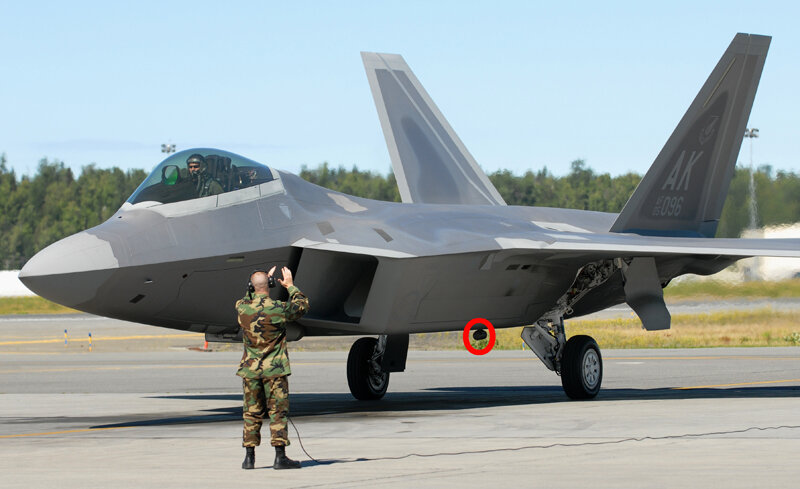

The pitot tubes in both F-22 and F-35 are already similar in dimensions to the RCS given for the whole plane. I wonder why such values are not questioned but the Su-57 is.
I dont know about F-35(although im sure they do have a solution.) but the Su-57 is going to have an easy time giving the fact that it has a flat antenna tilted upwards.

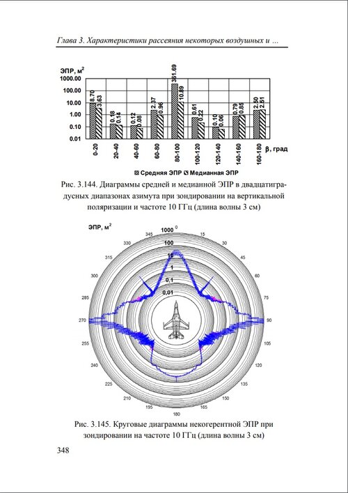

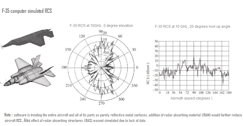

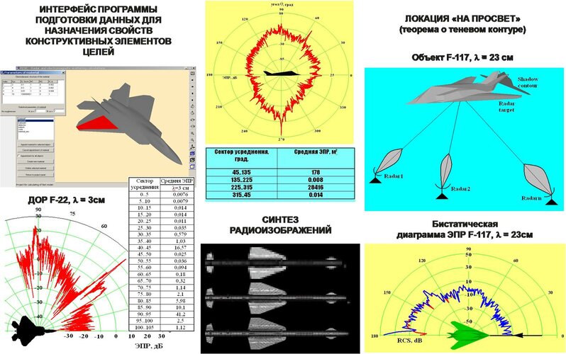

Averaging the RCS in every possible direction isn't meaningful because the stealth aircraft RCS has large spikes in certain specific directions. Any radar energy not absorbed by RAM/RAS must reflect somewhere!
How wide are those spikes? Considering the (many) curves on planes like the F-35, the width of the illuminating beams and the effects of frequency, it seems to me they can be many tens of degrees wide, but feel free to correct me.
If you believe the RCS requirement for F-22 was 0.3-0.4 sq m, then you may be interested in an investment opportunity in Nigeria I recently received in my email.
If you believe that RCS is a single value then then you might be interested in a post as a janitor in my recently built company over at Nigeria
Of course it’s not a single value. However stealth only works with reductions in RCS of multiple orders of magnitude. Reducing RCS from 10 sq m (F-15) to 0.4 sq m would not be tactically very significant.
The art of stealth design is arranging the spikes in the least useful direction for the enemy, and also planning your flight to minimise the chance of your "spikes" pointing in tactically useful directions.
If you imagine a stealth aircraft with a large spike pointing directly down to the ground - this isn't tactically very useful to its opponent as you won't detect it until it passes directly overhead - and that assumes the radar even has a useable elevation capability of 90 degrees.

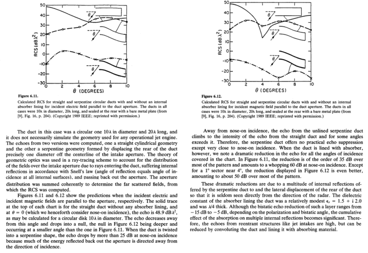

A frontal RCS of 0.3 to 0.4 sq m would be less ambitious than Typhoon or later model F-16/18 and result in no useful stealth capability at all.
Ehem.. Why did US reduce its RCS of F-18 intakes and HAVE BLUE on F-16's?

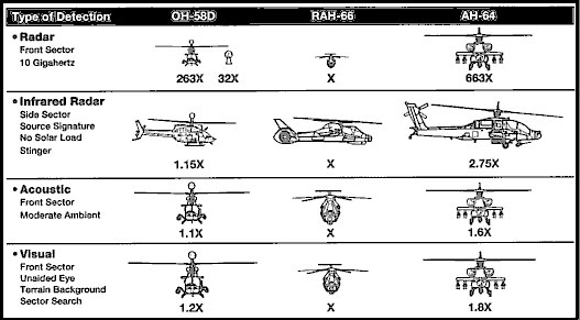

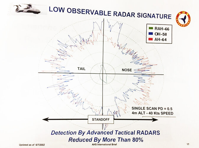

First, I was involved in LO analysis for the LHX project, in the early 1980s. I was not involved in F-117, B-2, A-X, F-22, or F-35 programs or their competitors, so my perspective is fairly narrow. My information is also about 35 years out of date, and any comments I make are solely based on public sources (which may include that long-term gift to foreign intelligence services, Aviation Week). Second, my LHX work was mostly on acoustic detectability, which is significant for helicopters, but completely irrelevant for high-speed aircraft.

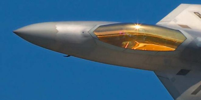

I don't think canopy of stealth fighter have better transmissivity than 60-70%
And i don't think you're right in your assumption. After all, studying transmissivity by photos is practically the same level of "expertise" as studying RCS.

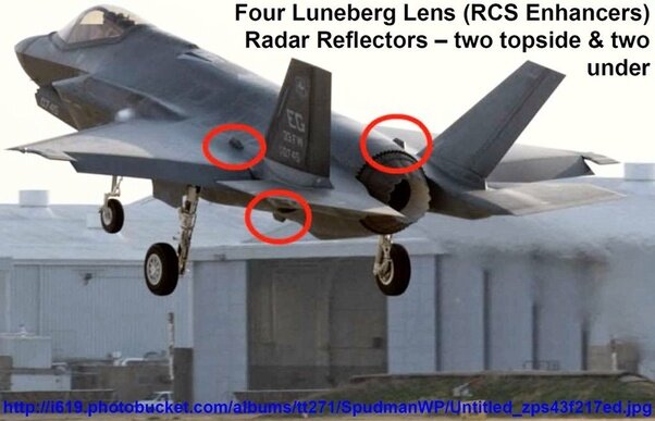

Keep in mind that stealth fighter are stealthy enough that they need to carry luneberg lens in peace time so that air traffic control can keep track of them whereas F-16 and F-18 even in clean configuration never have to carry these things.
When we take the 0.4 m2 value and compared that with fighter which has small RCS such as F-16 or F-18 at 1 m2
No way F-16 or any other 4,5gen will have 1 m2 RCS with EFTs and missiles
I don't see why that would be impossible, air to air missiles have tiny RCS, especially one with tiny fin such as AIM-120. EFT have greater RCS values but they aren't always carried and can be dropped.
You talking about LHX remind me of the RHA-66 comanche. Detection range reduction over AH-64 is 80%, that equal to around 3 order of magnitude smaller RCS.

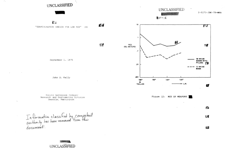

If their RCS wasn't a critical factor no one would hide them inside the fuselage. Even being tiny, they may produce huge parasite re-reflections, refraction and so being a "bright point".
And?... By how much times, do you think, Luneberg lense can increase the RCS?

The Luneburg lens can be set up as retro-reflectors, sort of like a passive transponder.
If RCS of stealth fighter are actually around 0.3-0.4 m2 then the RCS of air to air won't be a critical factor. The fact that the RCS of missile is critical factor for stealth fighter indicate that their RCS values are smaller than 0.3-0.4 m2

Keep in mind that stealth fighter are stealthy enough that they need to carry luneburg lens in peace time so that air traffic control can keep track of them

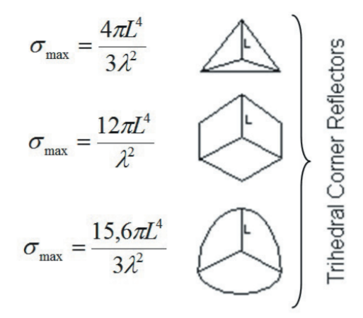

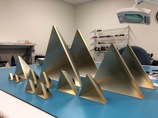

There are equation to calculate the exact maximum RCS of corner reflector.
L is length, λ is wavelength. Air traffic control radar operate at 2.5 GHz so λ = 0.12 m
Cross section diameter of the lens is about 20 cm at most, so L is about 10 cm = 0.1 m2
So maximum RCS at 2.5 Ghz of this luneburg lens is 0.02 m2 if it is the triangle type and 0.26 m2 if it is the hexagonal type
Wrong. Parasite re-reflections and refraction on elements of missiles, pylons and airframe are always generating huge RCS peaks, very similar to those we can see on the purposely designed corner reflectors.
Huge compared to RCS of stealth aircraft, but not very hug compared to RCS of conventional fighter, even 6 MK-82 bombs with pylons only generate RCS above 1 m2 in very narrow direction

they won't need to carry luneberg lens so that air traffic can track them
Who told you Luneburg lense is for air traffic?! This is a myth, coz even in Syria F-22 flew with them, knowning our Russian ELINT assets watching them. Luneburg lense prior purpose is to distort and increase the real radar signature, but this doesn't mean these lenses increase RCS by hundreds of times. The real multiplier is 10-15, in average. So if you belive in magic 0,0001sqm for F-22 and F-35, these lenses simply wouldn't help to civilian radars which has pretty crappy resolution, in comparison to military radars.
You misunderstood how a luneburg lens work, they don't multiply the current RCS of the aircraft carrying them. If you take the luneburg lens on the F-22/F-35 and stick them on B-52, the RCS of the lens won't suddenly increase by a thousand times.
Luneburg lens are nothing more than a retro-reflectors made up of metal plate perpendicular to each others or a parabolic dish, it has a fixed RCS value. If you know the size of the len you can estimate its maximum RCS, as I already did for you above. Before you say: " how can true RCS be hidden if the RCS of the luneburg lens is a fix value?". The answer: You can only calculate the maximum RCS of the lens if you know the size, and the size of the reflecting lens can be smaller than the plastic cover outside

12a-jpg.647482
I have seen more than a dozen radar scattering charts like that even the one measured in anechoic chamber, they all have the same problems:
1- The aircraft surface are treated as pure metal with perfect reflecting capability, RAM (radar absorbing material) and RAS (radar absorbing structure) aren't taken into account because there is no way for them to actually know the absorbing capability of the radar absorbing material and radar absorbing structure used on these fighter. This isn't a matter of taking an arbitrary absorbing value then applied to the whole radar scattering chart, because even when you used the same type of RAM on all location, the absorbing rating still isn't uniform. For example: the S-duct inlet will accumulate the absorbing capability of RAM by 5-6 times because it can make the wave bounce multiple time before reflecting back.
2- Leading edge and trailing edges treatment aren't taken into account
3- Most of them don't even model the inlet properly, this is important but also understandable because compared to the outer shape, there aren't many photo of the inlet and its exact curvature. The wave also bounce inside the inlet multiple time which is very resource consuming for a computer to simulate

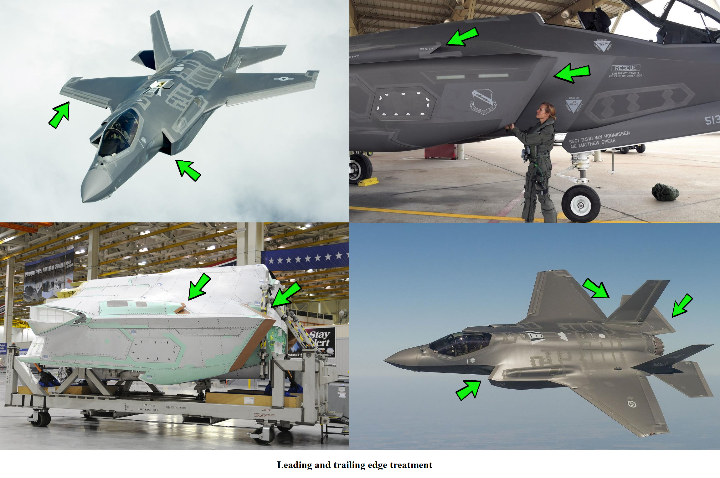

So if RCS of stealth fighter such as F-22, F-35, Su-57 is 0.3-0.4 m2 then they will reduce detection range by about 20% compared to F-16 and F-18 with RCS about 1 m2.
1- The aircraft surface are treated as pure metal with perfect reflecting capability, RAM (radar absorbing material) and RAS (radar absorbing structure) aren't taken into account.
3- Many of them don't even model the inlet properly
I dont think guys working on one of the main Air Defense Research Institutes don't know how to make RCS chart correctly. BTW, above the F-22 RCS chart you can see a screenshot for RAM characteristics adjustment.
