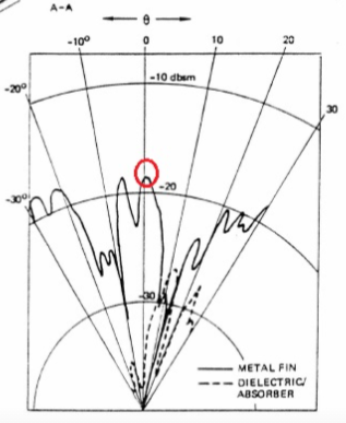

Yeah.great. Becuase no one was talking about the angled and ortagonal oriented planes. Swept fin with a side of 0.5m always has lower RCS than swept wing with a side of 10m. So frontal RCS of F-22 can't be equal or even lower than RCS of the tiny fin. Because size DOES matter, even if we talking about RCS. :rolleyes:

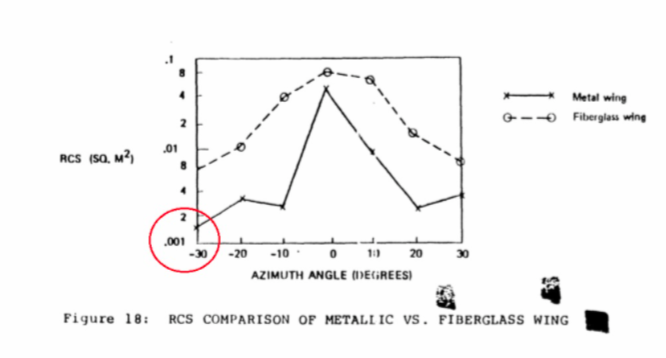

We literally just see above where the metal wing with 10 times lower RCS than a small fin even though they are both sweep
Show the wing edge? What is its size and shape? I can see the fin. This is a cone. I can estimate the fin size too. But the wing, no.
Actually, we don't have the cross section area of the edge for either the fin or the wing, so you can't estimate the accurate size at all.
But logically, wing camber are always thicker than fin because they are main lifting device

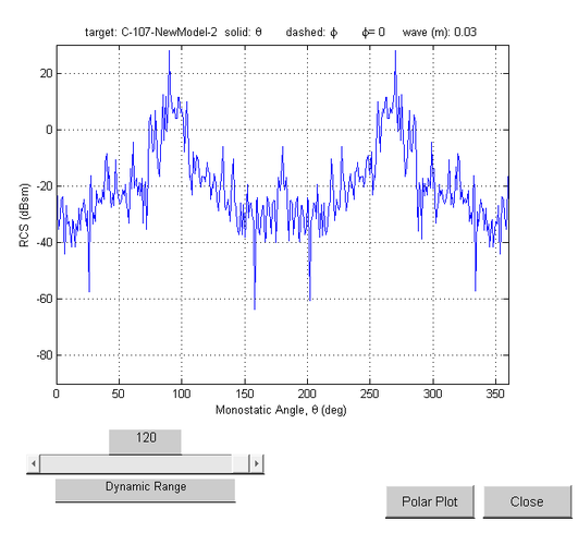

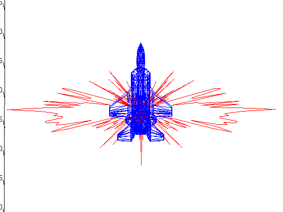

So this is a plot i made using my aircraft model.
From the graph i extracted some values from the angle. Well it's 10 GHz frequency, Co-polarized
Now if i were to present this measurement result to someone. How should i go with it ? Should i just take 1 angle ? or should i average them ?
and if i were to average them, what angle constitues the frontal aspect ? 0-30 ? or other angles. Or is there any special conditions e.g the potential threat radar.
Say i have a threat radar with 3 degrees beamwidth. Should i average say 0-3 degrees ? Thus if i have a threat radar with 4 degrees beamwidth then the average would be 0-4 degrees for frontal aspect.

Your model shows -20dBsm RCS except for 3 or 4 spikes in the front quadrant. If you could reduce these below -20dBsm by shape alteration or application of RAM/RAS, you could say this aircraft's RCS in the front quarter is about the size of a large bird like a Seagull.
If I may ask, what is the method of analysis? Physical optics or also others?
It's a PO from Pofacets.
The point however is not the accuracy but to find something which everyone could agree with. You see US loves the peas and insects and apparently satisfied with just 1 angle. The Russians likes to average things. Now i have a result.
Now if i were to make the calculations and measurements and have X-result with 2 sides disagrees on each other how it should be presented. That is a problem. Should i be averaging the value or should i just take 1 from an angle and present it to e.g journalists waiting for information ?

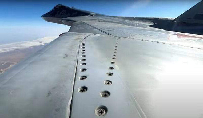

Ew... i noticed people got their OCD up seeing that 510 image. Saw some people make a fuss of it in facebook and twitter.
I wonder why all the power to scrutinize those screws not diverted into something more productive like actually agreeing on how one should present result of his/her RCS estimate.
Don't look at other "more" stealthy airplanes up close or you'll be disappointed.

People, these are machines that fly who knows how high and fast, on different weather, pressures, vibrations, left out in the open, out on top of a carrier, etc. What do you want? butter smooth skin and no panel lines? How are they going to work on them? Do you want the maintenance crews to walk around with spray paint and body filler every time the thing lands?
Just look at production plane #01, before you jump to such absurd conclusion.
Well that got me by surprise, its like that one time the Su-57 was accused of having bulb shapes compared to the elongated bulb thing on the F-35.
Faith in aircraft restored I guess.
It should also noted that that image of the SU57 wing screws is like one of this imagines I have seen of the SU57...
3 years ago.
I have a feeling that that is of one of the pre-production models during a test flight.
Yes, it's one of the prototypes.
