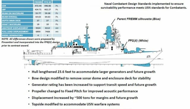

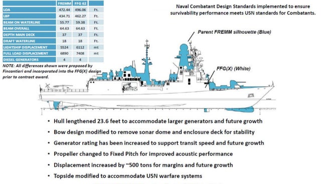

Do we know if the drawing with armament and so forth in the article is specific to the Greek examples?

It will fit four 3MW MTU 20V 4000 M53B replacing the Isotta Fraschini 2.8MW DGs and the shaft mounted electric motors by DRS replacing the FREMMs two Jeumont 2.5 MW motors. Have seen no details of the DRS motors, assuming more powerful as Constellation 500t heavier at 7,400t and its quoted it can cruise at 16/17 knots on its motors whereas FREMM 15 knots.Will use the same engine configuration (i.e. CODELAGOG) of italian ones ?
Yes, with upgraded diesels and fixed rather than controllable-pitch props.
The usual term for this configuration is CODLAG (Combined Diesel-eLectric And Gas turbine).
No, in our navy there is also the option to run on gas turbine only: as the single turbine is fuel efficient only on full power only we can disconnect the diesel electric so achieving a sort of fast cruise mode hence it mans CODLAG + Or Gas only.Will use the same engine configuration (i.e. CODELAGOG) of italian ones ?
Confusion reigns, my post below said the four 3MW MTU 20V 4000 M53B replacing the Isotta Fraschini 2.8MW DGs, made no mention of the single L2500G4+ GT which hasn't been changed.For Cordy
FOUR MTU 3MW engines instead of a single L2500G4+!!!!!
Man, are you sure that is a CODLAG at all and not just a COGAG?
What is sure is that you has made confusion between Horizon and FrEMM as it is the former one that sport two TAGS, Bergamini has only one .
Advantage of CODeLAGOG is precisely there , you spare a TAG thank to electrical boost, Aquitaine having only a Codog can reach just 27 knots instead of 31.
There's also the change of props from CPP to fixed pitch, plus lengthening changing the hull form and therefore the hydrodynamics. LCS is a pretty good example of how engine reliability issues can seriously compromise a vessel, and the FFG(X) requirement was meant to take them away from the weaknesses of LCS.Well, if such changes only interest the type of diesels used to power the electrical generators of the CODLAG system, the change is minor at least.
