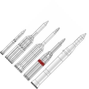

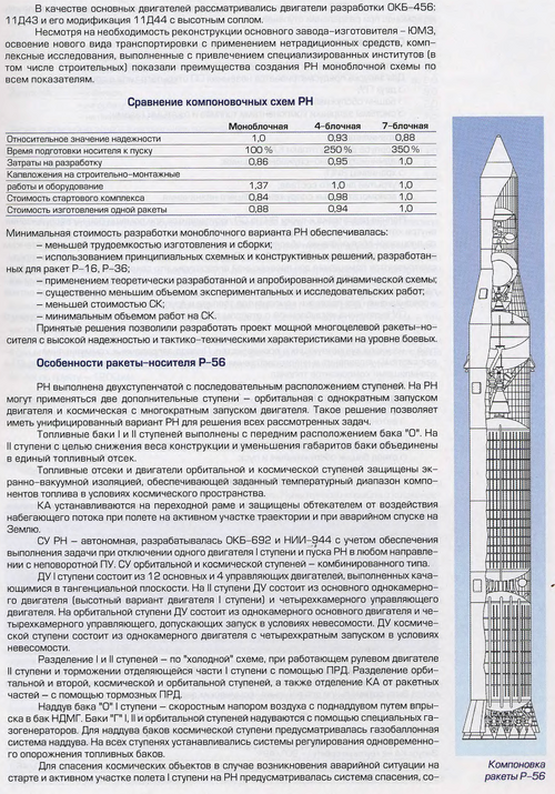

Hello there.
I just found some new information about the Soviet lunar program. It turns out that there was an intermediate link between "vostok/voskhod" and "soyuz" called "sever" (translated as north), had the indices 5k and 3k. See the first 5 photos. They show: 1 test ship "sever", a kind of Soviet gemini 2. sever 3 upper stage 4 docking of upper stages; then the north docked with the" train " of upper stages. 5 sever is ready to fly around the moon. The flight was planned to be manned. Unfortunately, the program was quickly closed, immediately switching to Soyuz.
Now just about that. The first project of "soyuz" was called soyuz-a. 6 photo - its model (there should still be solar panels, see below). Then it docked with the upper stage soyz-b and went to the moon (7 and 8 photos). Pay attention to the similarity of Shenzhou with this project. Well, as a bonus, I attach the final project of a manned flyby of the moon, 3 variations of the r-56 Yangel rocket and Afanasyev's book "non-light ships", from where I took most of the information. Enjoy

r-56, that was the name of Yangel's rocket, and it existed. Three options were worked out: six-block, four-block and monoblock. We stopped at the monoblock, but then the government said: Korolev works for the media, a man for himself, and who will work for us? Stop worrying about any Moon there, strengthen the defense. However, they took part in the H-1 program. We made Block E for the lunar lander. This is the LC propulsion module, which was supposed to carry out a soft landing on the Moon and launch from it.
They haven't really developed a rocket either. They have been shut down at this stage. And there was no talk about the ship. the r-56 was closed very quickly, there were already a lot of projects.
