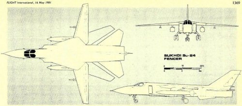

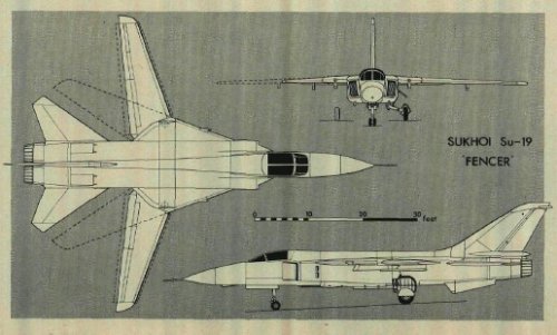

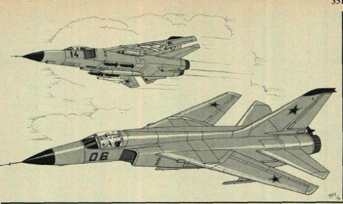

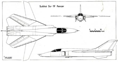

I am after either a side profile drawing or a 3-view drawing of one of the early impressions of the West's take on the Sukhoi Su-19 'Fencer' (that's right the Su-24!)
I have checked out the subject 'Soviet aircraft misidentifications' on Secret Projects - but non to the artist profile I have posted.

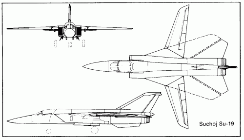

From Angelucci "Weltenzyklopädie der Flugzeuge - Militärflugzeuge 1914 bis heute":
Two impressions from Flight International July 29th 1978.
Regards Bailey.

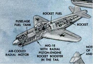

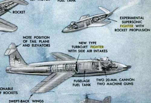

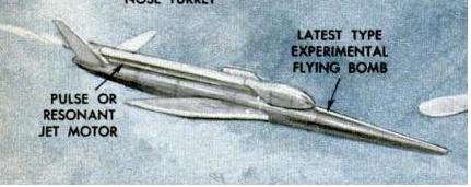

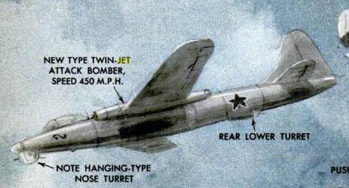

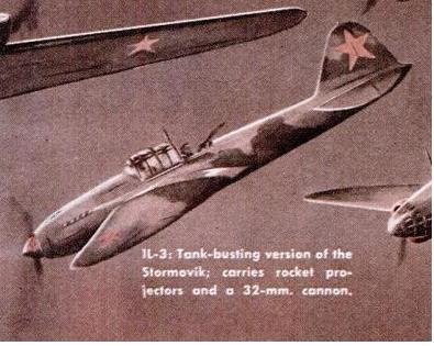

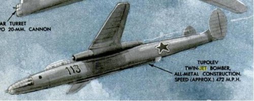

the Ilyushin Il-3 was tank-busting version of the Stormovik aircraft
as they thought in 1947 in Popular Science magazine.
http://books.google.com.eg/books?id=jiQDAAAAMBAJ&pg=PA86&dq=helicopter+Jet-propelled&hl=ar&ei=7Au7TPG3OMmBOqPo-OoM&sa=X&oi=book_result&ct=result&resnum=3&ved=0CC8Q6AEwAg#v=onepage&q=helicopter%20Jet-propelled&f=false

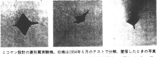

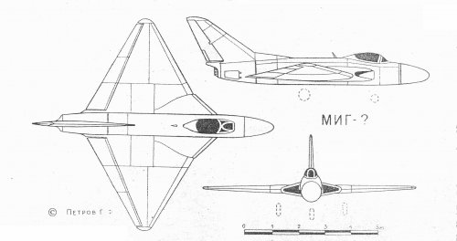

I know this is very late but I'm rather interested in the Romboidal wing fighter posted about by Matej (August 25 2006) , pometablava (October 01, 2006) & boxkite (October 14, 2006).
Were there any speculations about armament, engines, weight etc? (For example in one of the pictures posted by Matej there appear to be eight missle/bomb rails fitted under the wings (four a side))
Graham1973 said:
I know this is very late but I'm rather interested in the Romboidal wing fighter...
A verbatim quote from the "Nevsky Bastion" Issue № 3 dated 1997. 02.
in article "Mysteries of History Military Equipment" by G. Petrov (p.55)
"... So far, none of the local KB is not claimed to have conducted in the years of work on the jet fighter with a diamond/romboidal wing. However, be said that the pictures - the falsification impossible, as in the years 1950-1952 in TsAGI were working to determine aerodynamic performance fighter with a diamond/romboidal wing (wing RK-1, RK-1M, RK-2) "
Next G.F. Petrov proposal his reconstruction of the fighter.

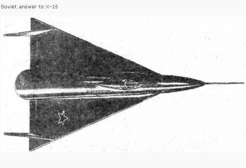

anther misidentification,the Soviet answer to X-15.
