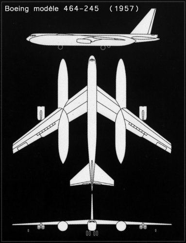

Found in the French forum.avionslegendaires.net.
According to that forum, the original picture comes from the Boeing archives.
Nuclear or Liquid hydrogen powered or like the B-52X "Zwilling" just a fake?! :-\
Maybe our French members can translate the picture caption posted at that forum. :)
Edit: Orthography
Sorry, but as far as I understand it, it's a fake, like the B-52X, the two inner engine pods should have been
replaced by tanks with 157.000 litres each. And the question was asked: How it would be able to take off
with a full fuel load ?
This might work as a study for a liquid hydrogen fuel testbed - 2 x 157,000 litre tanks comes in at about 20 tons, which is vaguely plausible, and if you don't carry a significant quantity of other fuel, four engines might get the aircraft off the ground in a sane runway length.
I have a photocopy of the original drawing that was made from, copied from the D-4500 files at the Boeing archive. It's legit.

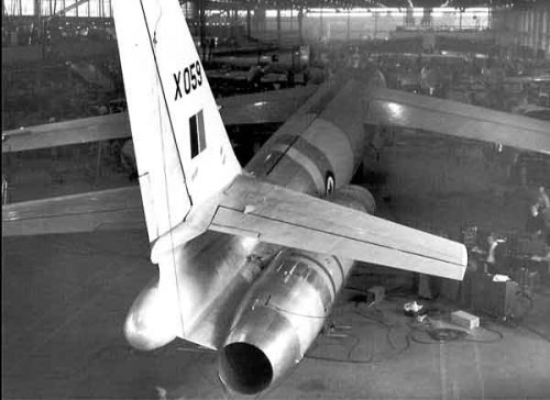

Matej said:
What the hell is that??
http://3.bp.blogspot.com/_vZyHxmcMvtg/TKBxbjDQbFI/AAAAAAAAB6E/4lcgDcUqozA/s1600/dsc_7590.jpg
Greetings,
Canadair CL-52
* * One of the most unusual B-47B conversions was the Canadair CL-52 which was a B-47B loaned in 1956 to the Royal Canadian Air Force
to test the new, powerful Orenda Iroquois
turbojet (rated at 19,250 lbf (85.6 kN) dry, 25,000 lbf (111 kN) afterburning) for the Avro Canada CF-105 Arrow
interceptor
. Canadair Aircraft, the sub-contractor, attached the Iroquois engine to the right side of the rear fuselage near the tail; due to the large exterior diameter of the engine, no other location was feasible.
Flying the CL-52 was reportedly a nightmare. After the Arrow project was cancelled in early 1959, the B-47B/CL-52, with about 35 hours of engine flight tests to its credit, was returned to the U.S. Some sources claimed it was bent out of shape by the tests, but in any case, it was subsequently scrapped. The CL-52 was the only B-47 to be used by any foreign service.
Regards,
AK

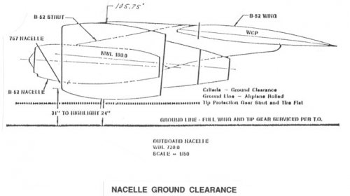

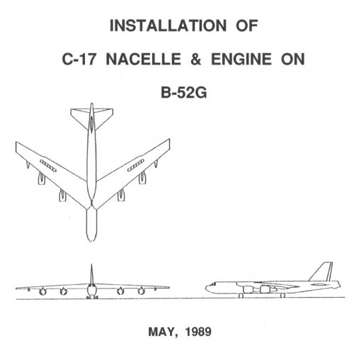

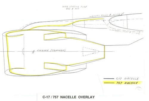

The Advanced Concepts folks a LTV took a look at the re-engine the B-52G using either a
C-17 or 757, nacelle and engine combination in an un-numbered document titled "Installation
of C-17 Nacelle & Engine on B-52G" This would be right in line for interest as C-17 Nacelles and
Pylons were currently in production at LTV.
They found there would be enough ground clearance on the outboard nacelles using either design.
They also discovered that a new pylon would have to be built, they could not use the C-17 pylon as
currently in manufacture as the engine needed to be mounted closer to the B-52 wing.
Also identified was a problem with Asymmetric Power with the loss of an outboard engine.
"The loss of the outboard engines' 40,000 lbs. of thrust on takeoff cannot be handled by
the B-52 as presently configured. The control system's authority with the existing fin/rudder
combination is inadequate."
Proposed solutions included: automatic thrust control to compensate for lost engine, more
throw on existing rudder, larger chord rudder.
Attached are a couple of drawings from the small report.
Source Vought Aircraft Historical Foundation
bill
bill
If I remember correctly the Concord faced potentially similar problems with the loss of an engine.
I wonder if reverting to the early B-52 tall tail would help. I suppose modifying the current rudder is more feasible.

"Also identified was a problem with Asymmetric Power with the loss of an outboard engine."
As many civilian jet engines now have thrust diverters, would such suffice to compensate ? Or would their weight penalty be excessive ??
Aside from perhaps being able to handle adverse runway cross-winds, would thrust diversion at 'full military power' provide VIFF-capability, or simply detach pod ??
