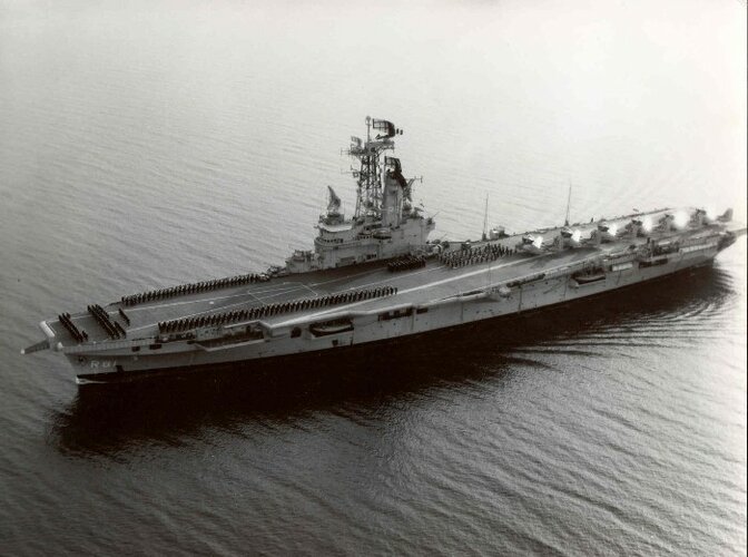

As she was in the Netherlands Navy - note flight deck aft of the island:

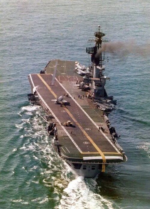

Some time after she was transferred to Argentina, but before 1978, there were a couple of small platform extensions made to the flight deck just aft of the island, to allow two aircraft to be parked there. I can't see them in ones from shortly after her transfer, but they are there later:
In this image from between 1978 and 1980 you can just see them - note the helicopter on the forward one:

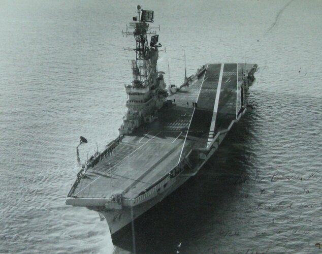

In all of the photos you can see the original stepped fore end of the angle deck the Dutch put on her when they first modernized her.

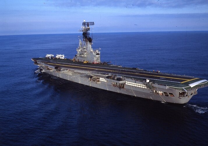

Between 1980 and 1982 the Argentines enlarged the flight deck extensions aft of the island into one section that could hold 3 Skyhawks or 2 Trackers - and improved the fore end of the island to a proper squared-off shape:
Note the length of the catapult... you can see the outline of the angled jet blast deflector plate about halfway between the forward A-4 and the fore aircraft lift. It looks the same as in the first post-transfer photo in this post. The aft aircraft lift is still marked out:

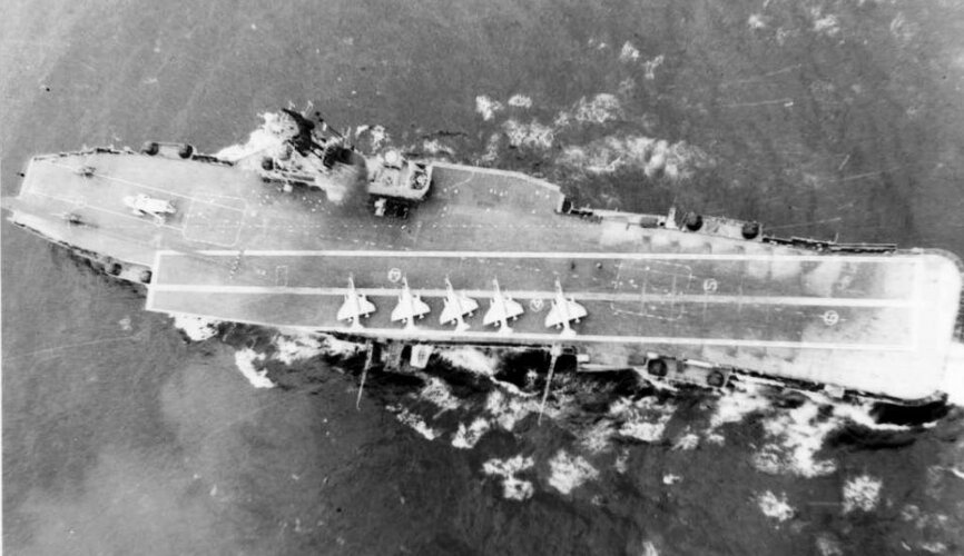

And later we can see the aft lift markings are gone, and there are 3 Super Etendards on the flight deck extension aft of the island, but the catapult looks to be the same length - my understanding was that it had been in poor condition during the Falklands war, and was fully reconditioned afterwards, rather than lengthened, but I'm open to supported arguments to the contrary:

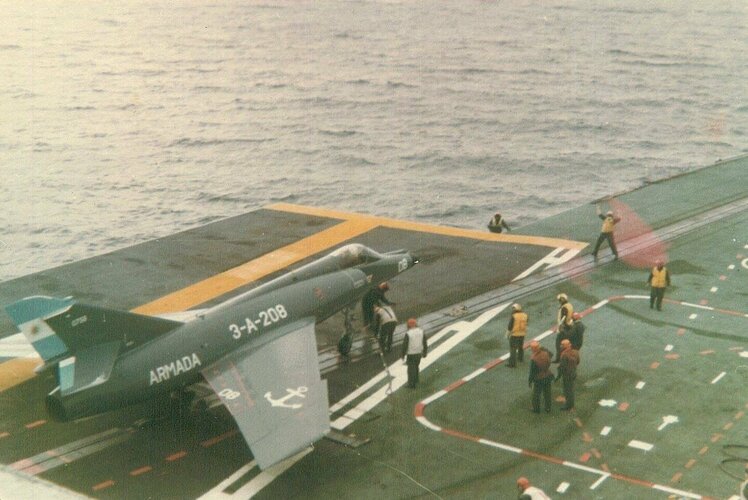

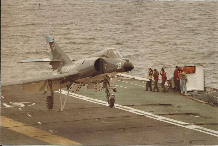

First landing and catapulting of a Sue on 25 de Mayo, in 1983.

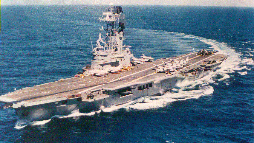

And a photo of the 25 de Mayo probably from the end of the 60s.
  • Argentine Navy Super Etendard (3-A-208, 0758) of 2 Sqn first launch on 25 (1983).jpg
  • Argentine Navy Super Etendard (3-A-208, 0758) of 2 Sqn first landing on 25 (1983).jpg

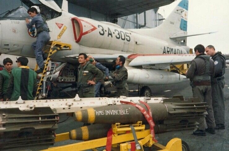

So the details of the catapult modification is still a mystery? I guess it happened after falklands war too because the story of fully loaded A-4Q being unable to take off is well known.
I think the catapult still had the power to launch fully loaded Skyhawks, but the boilers didn't allow the necessary speed to be reached without wind.
