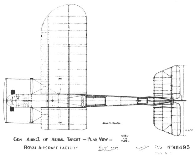

In The Royal Aircraft Factory (P. Hare, Putnam 1990) it is mentioned, in the context of the Royal Aircraft Factory's 1917 'Aerial Target' (a seminal, radio controlled pilotless drone, designed to be launched against Zeppelins and as a flying bomb), that:
One example was later converted to a manned aeroplane by No 3 (Western) Aircraft Depot at Bristol, and was fitted with a wheeled undercarriage and ailerons. As a rebuilt aircraft it was allotted a serial number from a batch allocated for that purpose. It received the number B8962, with numerals similar to those of its original, uncertain identity, and this has caused much ill-founded conjecture among latter-day historians. By 1934 it had been disposed of, and was owned by Mr Ron Shelley of Billericay, but it was broken up without appearing on the civil register.
Does a photograph of this example exist? Does anyone know more about (a) its use by Nº 3 (Western) Aircraft Depot and (b) the apparent plans for it to be used as a civil light aircraft?

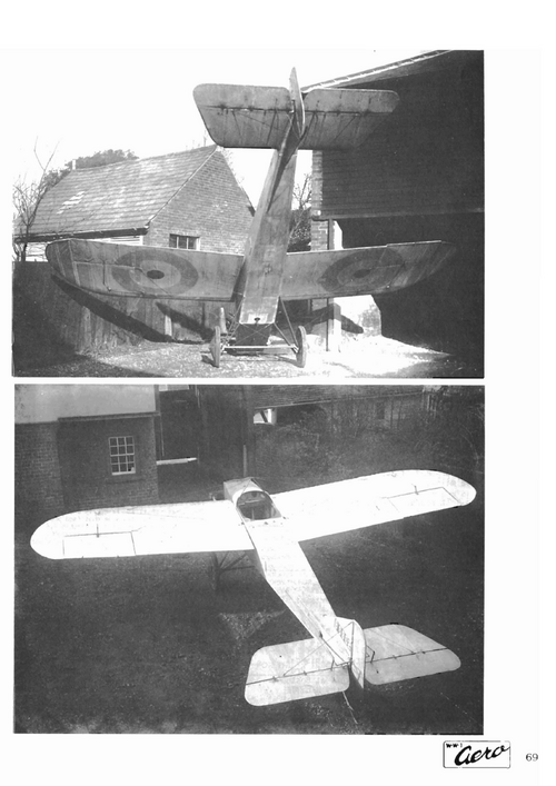

Excellent. Thank you, hesham. The letter and photographs are most interesting.
What is not clear, from the pages that hesham has attached, is who wrote the letter and when. Was it, as is suggested by the heading on page 68, written by Ron Shelley? If not, then by whom? Is the letter an historical document or was it sent to the publisher of the magazine in 1987? If the former, was it written prior to 1934 or subsequent to that but prior to 1987? Also, who took the photographs and/or supplied them to the publisher of the magazine? Finally, does the letter continue onto page 70 (as the table of contents suggests that the following piece starts on page 71)? If it does, would you please, hesham, attach page 70 as well.
Having revisited the letter, evidently it was written no earlier than 1945 because it says:
I kept the rudder and tailplane for a number of years, but they got destroyed before WWII
As to the serial number which appears on the fin in the first photograph, this replicates the last of the series allocated to the unmanned 'Aerial Target' aircraft (A8957-8962) but with a B prefix being subsrituted for the A prefix. B8962 appears to have been part of a block of serial numbers which Bruce Robertson (British Military Aircraft Serials 1911-1979, PSL 1979) describes as being:
Various types rebuilt by Nº 3 (Western) Aircraft Repair Depot, Yate, Bristol .....
but no mention is made of B8962 in the 'remarks' column, from which one might deduce that the serial number was not officially allocated to the manned 'Aerial Target' aircraft and, for that reason, it was convenient to Major Brown simply to apply it to the aircraft to give it a semblance of legitimacy (bearing in mind that it was being kept at RAF Northolt).
