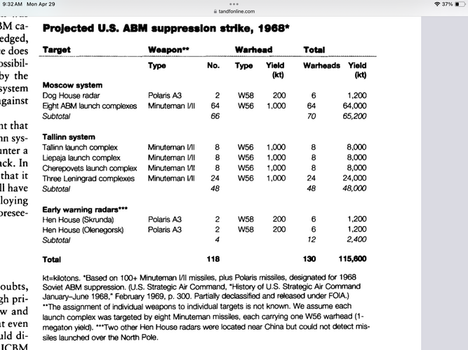

In the 1968 attack plan, the Moscow system was targeted by 66 total missiles carrying 70 total warheads.100 warheads, or 100 missiles?
So 7 Peacekeepers or 9 Trident D5s does the same job. Or 6 D5s with the optional 12x100kT load or 6 Peacekeepers with the Mk12A RVs.In the 1968 attack plan, the Moscow system was targeted by 66 total missiles carrying 70 total warheads.
I don’t know about post 1989 plans and I don’t know enough about MIRV bus footprints to say just 7 or 9 missiles can duplicate the coverage.So 7 Peacekeepers or 9 Trident D5s does the same job. Or 6 D5s with the optional 12x100kT load or 6 Peacekeepers with the Mk12A RVs.

Remember the plans also went after the Tallinn system and the EW radars so it’s covering a lot of area.
