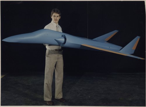

For those thinking the above model (the one circled in red) is McDonnell Douglas' ATF design, here's their original, declassified painting. The wing trailing edge and the rear end of both aircraft are different. Maybe it's an earlier submission, but it would be interesting if a full picture of that model could be revealed. Since it was a Lockheed Martin event, it's probably a Lockheed or General Dynamics ATF design.
On a side note, I wish Jay Miller in his F/A-22 Aerofax book would have properly identified General Dynamics' pre-ATF and ATF designs (pretty much everything from pages 7 through 13) as being their designs, not Lockheed's. I have to say that is a disservice to both the enginers at General Dynamics and at Lockheed from that period. An enthusiast like me knows it, but just anyone picking up the book may not.

Although it was a very high performance vehicle, the Model 252-2BF-3, a typical SX configuration fixed-wing attack aircraft, proved to suffer in the ratings due to lack of firm design and payoff information, Figure 2. Also, the then relatively undefined high-speed performance indicated a wing temperature condition that would require a thermal/structural analysis and materials other than the well characterized epoxy matrix composites
Appears to be a highly supersonic (hypersonic?) attack aircraft design.

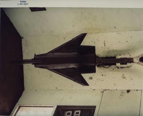

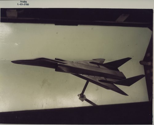

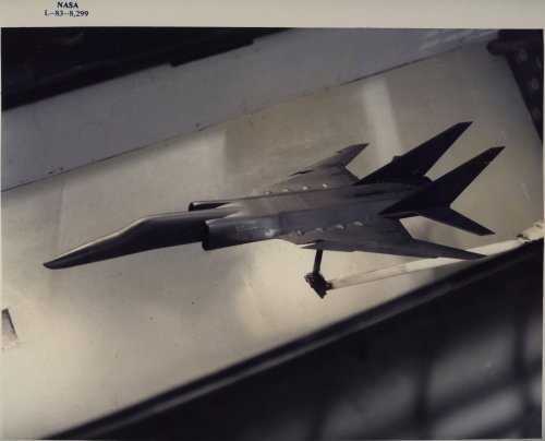

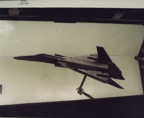

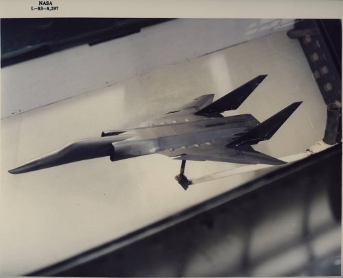

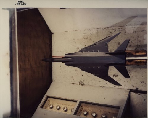

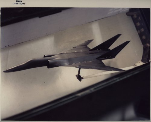

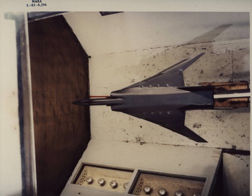

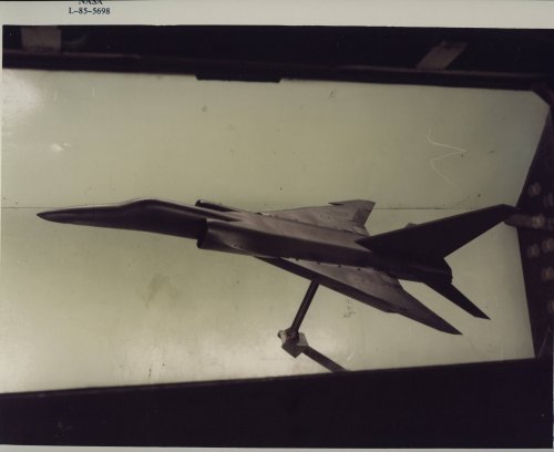

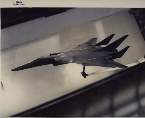

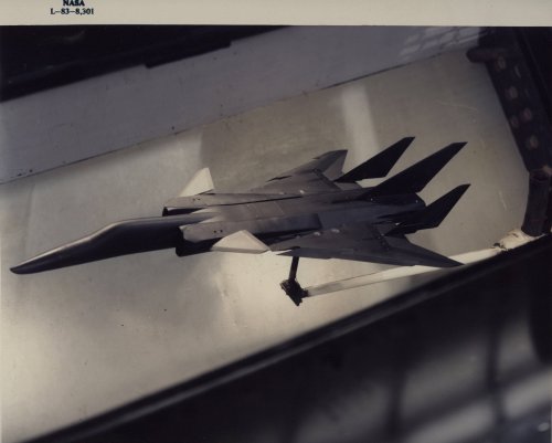

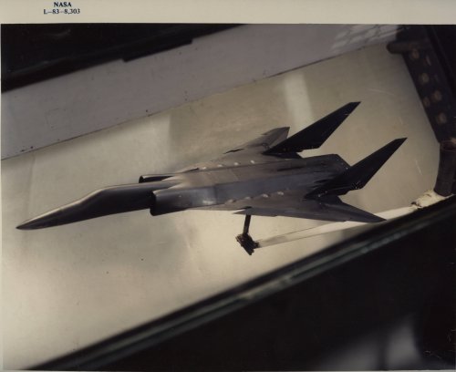

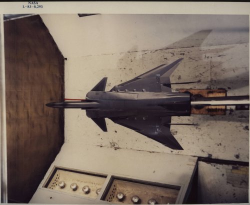

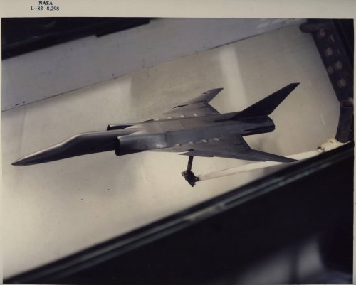

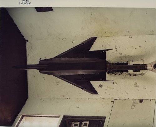

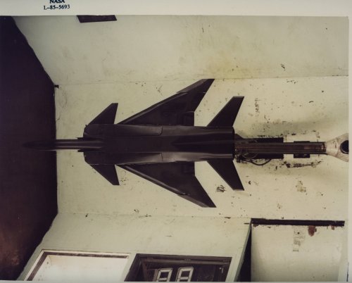

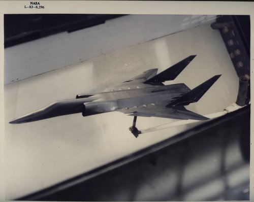

Bunch of windtunnel photos of some early 1980s McDonnell-Douglas (McAir) advanced fighters here:

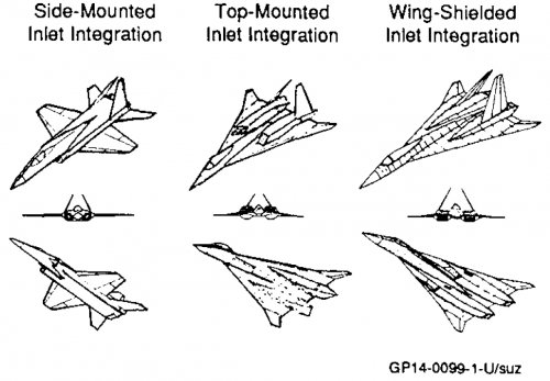

Because I am not a aerospace engineer nor a aerodynamicist I was wondering if someone at SP could help me. You see a lot of fighter concepts with engines "on top of the wings/fuselage" but none that I know of built. Are there any inherent advantages or disadvantages to this arrangement?
Advantage is they can't be seen from below and your lower surface is smoother (a plus when radars are looking at you from the ground). The disadvantage is airflow is problematic particularly at high angle of attack. The only fighter I'm aware of that actually got built with one is the North American YF-107.
The Gulfstream Peregrine 600 prototype also used a variation of that configuration... but it lost out in the NGT military competition.
Now, let's clarify something here: when you say: "on top of the wings/fuselage", you do not mean just that kind of layout, right? I guess the German VFW 614 transport also corresponds to your description... And, no, there never was a fighter with that configuration...

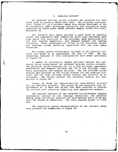

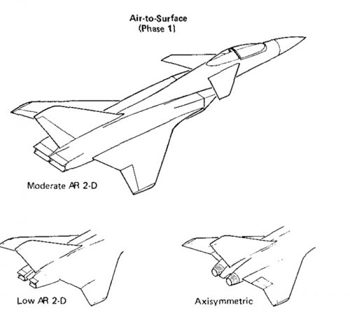

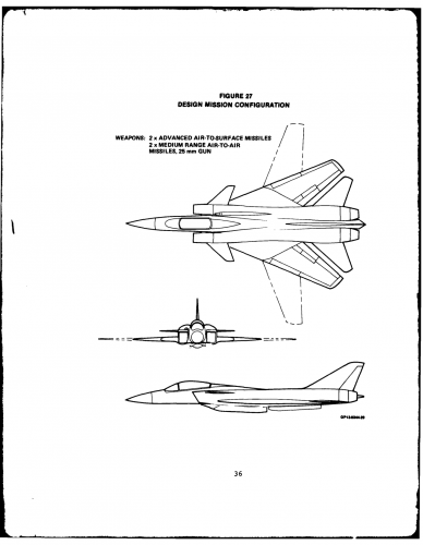

McAir's contribution to the Air To Surface Technology studies (GD was the other half).

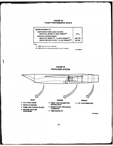

"5. BASELINE AIRCRAFT
An advanced tactical strike aircraft was selected for this study from an existing MCAIR data base. The selected configura- tion, Figure 27, is a variable sweep wing design developed in the Air-to-Surface (ATS) Technology Evaluation and Integration study conducted by MCAIR under AFFDL Contract Number F33615-76-C-3101, Reference 10.
The variable winj sweep provides a good blend of subsonic cruise and supersonic dash capability while also providing good high speed ride qualities at low altitude, good maneuverability for self defense capability, and reduced takeoff and landing
distances. These advantages are offset by the structural weight
and fuselage volume penalties associated with the wing sweep
mechanism.
The weapon system technologies included in the baseline air-
craft are based on an approximate IOC date of 1995. The key technology features of this configuration were shown previously in Figure 14.
A number of alternative weapon delivery tactics are cur- rently being investigated for advanced tactical strike aircraft.
Two potential strike missions are (1) a high altitude, supersonic penetration and weapons delivery and (2) a low altitude, tran-
sonic penetration and weapons delivery. The low altitude strike mission was selected as the sizing mission for the baseline air- craft and the high altitude strike mission was selected as an
alternate. The design mission and alternate mission are sum- marized in Figure 28.
Figure 29 shows the maneuverability requirements selected for the baseline aircraft. The excess PS and sustained turn
re-
quirements at .9 Mach and 30,000 feet were selected to provide the aircraft self escorting capability with appropriate weapons."

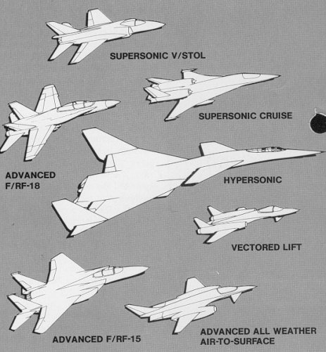

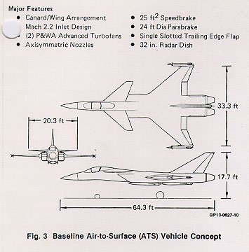

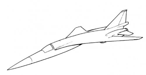

If I didn't know any better I'd say I was looking at a Grumman G-303D / McDonnell Douglas 225 Hybrid.

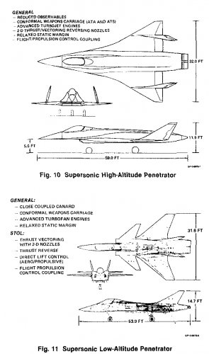

More ATS studies by McDonnell Douglas have already been presented on this forum (some of which share similarities with this one):

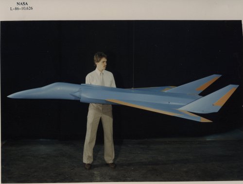

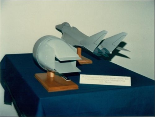

As for the aircraft in the photo, I can only make out the first word in the caption, "MCAIR".

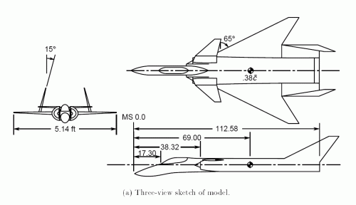

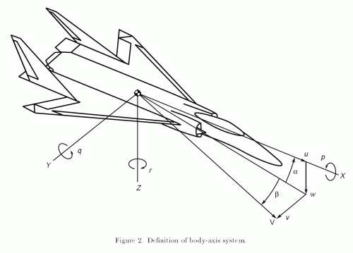

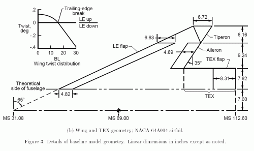

Okay, here goes: "MC AIR Supersonic Persistent Fighter (SSPF) With Pratt & Whitney Spherical Convergent Flap (SCF) Nozzle."
Wind-Tunnel Free-Flight Investigation of a Supersonic Persistence Fighter
Authors: David E. Hahne , Thomas R. Wendel , Joseph R. Boland
February 1993 Technical Paper
Technical Report NASA TP-3258
NASA Langley Technical Report Server ©2003
Wind-tunnel free-flight tests have been conducted in the Langley 30- by 60-Foot Tunnel to examine the high-angle-of-attack stability and control characteristics and control law design of a supersonic persistence fighter (SSPF) at 1 g flight conditions. In addition to conventional control surfaces, the SSPF incorporated deflectable wingtips (tiperons) and pitch and yaw thrust vectoring. A direct eigenstructure assignment technique was used to design control laws to provide good flying characteristics well into the poststall angle-of-attack region. Free-flight tests indicated that it was possible to blend effectively conventional and unconventional control surfaces to achieve good flying characteristics well into the poststall angle-of-attack region.
Download: http://www.cs.odu.edu/~mln/ltrs-pdfs/tp3258.pdf
NOTES:
- Quite a few pictures do not appear in this PDF file, probably withheld from publication.

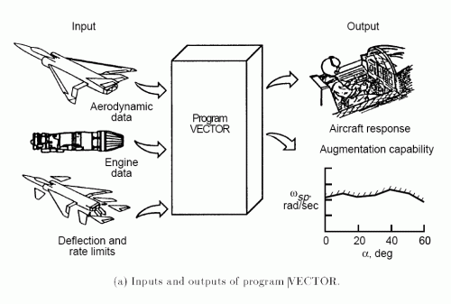

- Interestingly, the SSPF program seems related to the VECTOR program (X-31, second test phase).

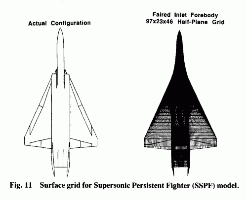

Prediction of Inviscid Supersonic/Hypersonic Aircraft Flowfields
A. Verhoff and D. Stookesberry
McDonnell Aircraft Company, St. Louis, Missouri 63166
JOURNAL OF AIRCRAFT
Vol. 29, No. 4, July-Aug. 1992
Eleven control power predictions were made for the supersonic persistent fighter (SSPF) model of Ref. 12. Calculations were made using a faired inlet forebody geometry. Figure 11
shows the surface grid and the actual model configuration. Predicted elevon control power increments are compared with test data in Fig. 12 for a freestream Mach number of 2.0.
Download: http://81.70.242.211/eab1/manual/Magazine/AIAA Journal of Aircraft/1992/4/Prediction of inviscid supersonic hypersonic aircraft flowfields.pdf

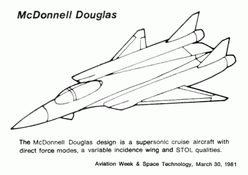

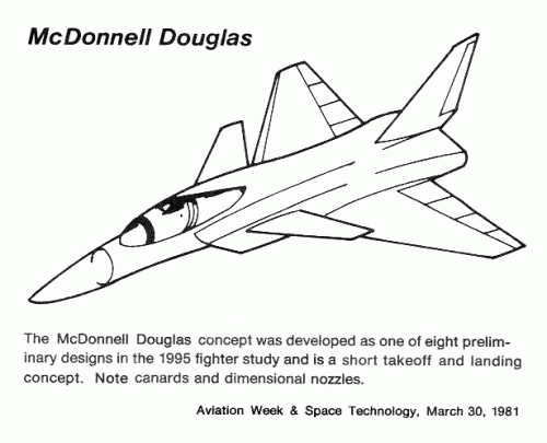

PaulMM said:
This appeared in a 1981 article from AW&ST, along with a second proposal.
I have extracted the text from the article and affixed it to each picture.
