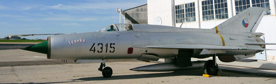

This is one of the few Mig-21 version without an internal gun. It rely only on 2 IR guided air to air missile. As far as I know, early IR missile need to be launched from rear aspect of jet aircraft to be able to get a lock. They can't lock on the skin friction. Does that mean Mig-21PF is completely helpless against piston fighters and bombers?.
Not completely (piston engines aircraft typically do have hot exhausts ports) but trying to get a lock on a manoeuvring opponent in that scenario may be problematic.

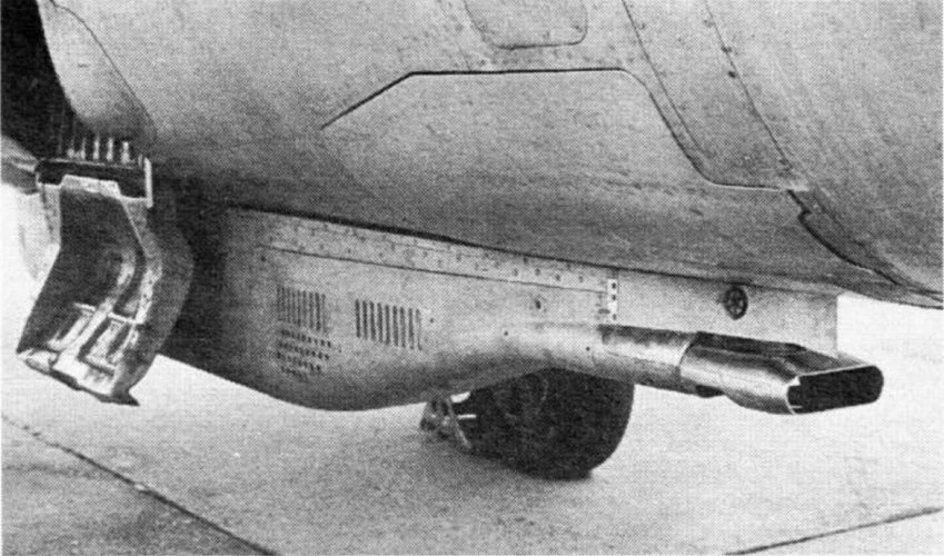

My choice would be the old Canberra vertical machine gun load-out that shot downwards
