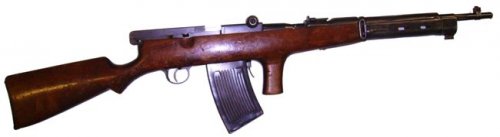

Longshaor said:
To convert to the 7mm would have been more costly.
Only if you want to convert existing 30-06 weapons to the new 7mm caliber. If you're designing from scratch, this is irrelevant.
And simply rechambering an existing 30-06 weapon to the new caliber makes little sense IMNSHO, except perhaps as a temporary stop-gap solution, as you lose the advantages of a lighter and smaller weapon possible with the 7mm.
Regards & all,
Thomas L. Nielsen
Luxembourg
The definition of "Assault rifle" did not originally include any reference to the type of cartridge utilised. It only referred to the matter of selective fire and ammunition source.
Quoting from the book "Assault Rifle", by Messrs. Maxim Popenker and Anthomy G. Williams (ISBN 1 86126 700 2), chapter 1:
"....there is no officially agreed definition of the term [Assault rifle]".
"The broadest definition [of an "assault rifle"] likely to secure agreement is along the lines of: "a standard infantry rifle with selective fire".
Later in the same chapter: "....it is also always magazine fed".
And: "...the term "assault rifle" should arguably be applied only to those weapons which are capable of controlled, fully-automatic fire from the shoulder; this would rule out those selective-fire rifles which chamber the traditional full-power 7.62 or 7.92mm rifle and MG cartridges....".
Thus arriving at the definition I used above: "a semi-and full auto, magazine fed, intermediate-power individual weapon".

Re: British .280 Rifle Circa 1951
zen said:
Or for that matter the Arisaka 6.5mm round?
....which was used in the first ever in-service "assault rifle" (a semi-and full auto, magazine fed, intermediate-power individual weapon), the Fedorov Avtomat:
http://world.guns.ru/assault/rus/automatic-fedorov-e.html
Regards & all,
Thomas L. Nielsen
Luxembourg
Regards & all,
Thomas L. Nielsen
Luxembourg

Weight of Federov Avtomat: 4.4 kg empty, 5.2 kg loaded.
Weight of StG 44: 4.6 kg empty, 5.16 kg loaded
Power of cartridges:
Muzzle energy of 6.5 mm Arisaka Type 30 cartridge fired from an Avtomat: 2,200 J
Muzzle energy of 7.9 mm StG 44: 1,900 J
Muzzle energy of recent proposals for assault rifle cartridges (6.8 mm Rem SPC, 6.5 mm Grendel): 2,400-2,500 J
Muzzle energy of "battle rifles" firing full-power 7.6-7.9 mm ammunition: 3,000-4,000 J (7.62 x 51 NATO is around 3,400 J)
Manageability in automatic fire (from Wiki):
Russian data indicates that when fired in short bursts the Fedorov Avtomat could reliably hit targets having a profile of 0.6×0.5 m at a distance of 200 m. At 400 m the dispersion increased to 1.1×0.9 m and at 800 m it was 2.1×1.85 m. Consequently, burst fire was only considered effective up to about 500 m

the FA IS A BATTLE RIFLE NOT an Assault Rifle
its too heavy
its too awkward
it is not manageable in full automatic fire
cts are the Federov is NOT an assault rifle.. it shoots a cartridge that is NOT intermediate
its too heavy
its too awkward
the Federov is by all definition a BATTLE RIFLE
