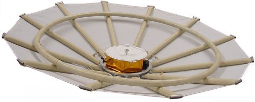

Done. Meanwhile, here are a couple of other images.
