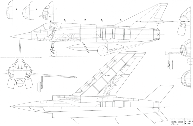

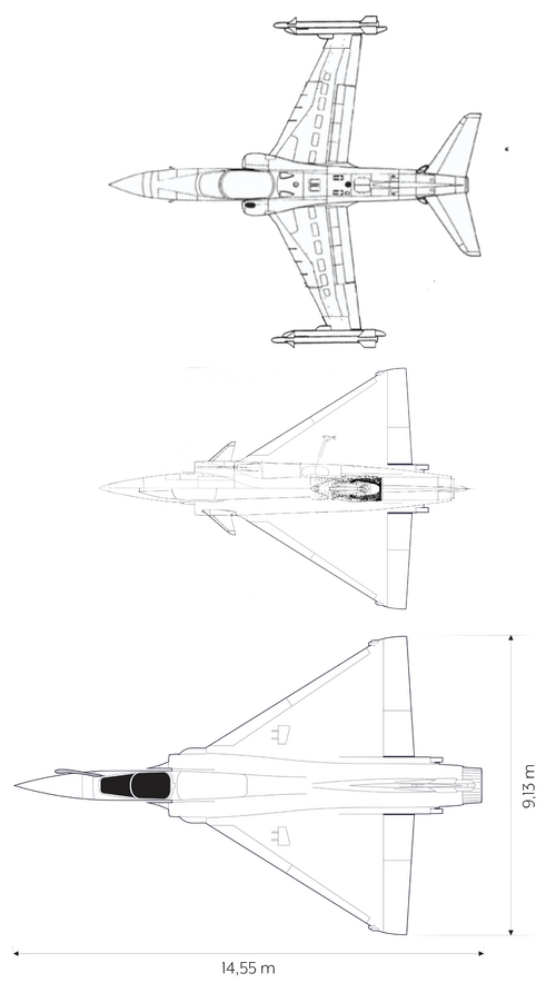

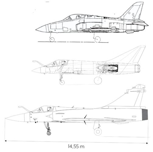

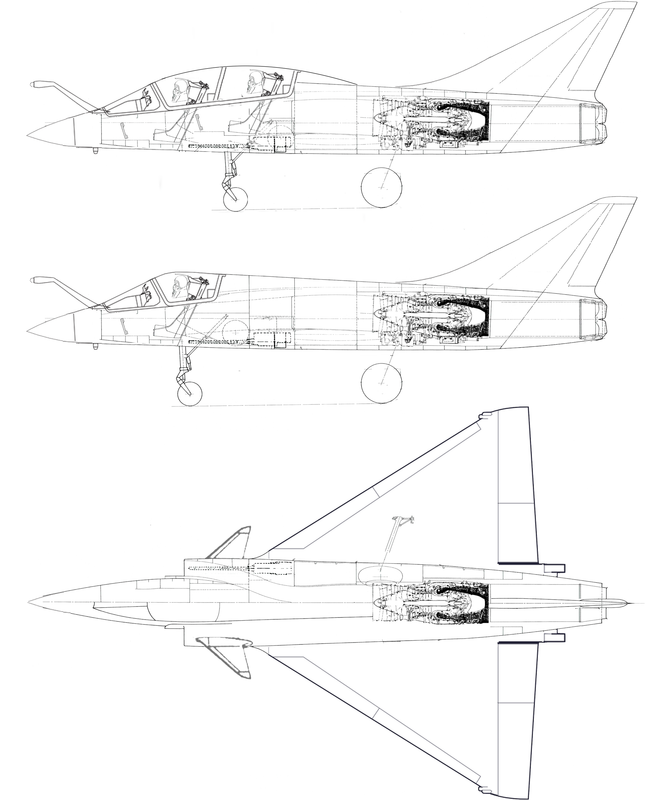

Taking a shot at this from a slightly roundabout angle.
1) What if I started with the tiny Etendard VI, Dassault's contender for NATO's 1950s lightweight tactical strike fighter competition?
2) Replaced the Orpheus turbojet with a modern F404/M88 engine (without afterburning)... almost identical size and weight
3) Added 30 years of Dassault aerodynamic experience (delta + fly-by-wire + canards)
4) And included an optional 2nd seat trainer (as originally planned by Dassault)?
This leads to a 3.9t empty trainer / light attack fighter, optimized for low transonic drag, with a high T/W ratio (5-5.5t of dry thrust), good internal fuel fraction (1.8t of fuel), 25% reduction in fuel consumption vs. the 1950s/60s, and high maneuverability. Oddly reminiscent of the diminutive Mirage I & II. It would likely be able to supercruise (Mach 1.2?) and serve as a back-up fighter, lead-in trainer, and carry 1-2 tons of air-to-ground weapons.
Drumrole... introducing the Dassault "Zephyr":
More pics below, including comparisons to the original Etendard VI, Hawk 100 and Mirage 2000.
1) What if I started with the tiny Etendard VI, Dassault's light attack contender for NATO's 1950s lightweight tactical strike fighter competition?

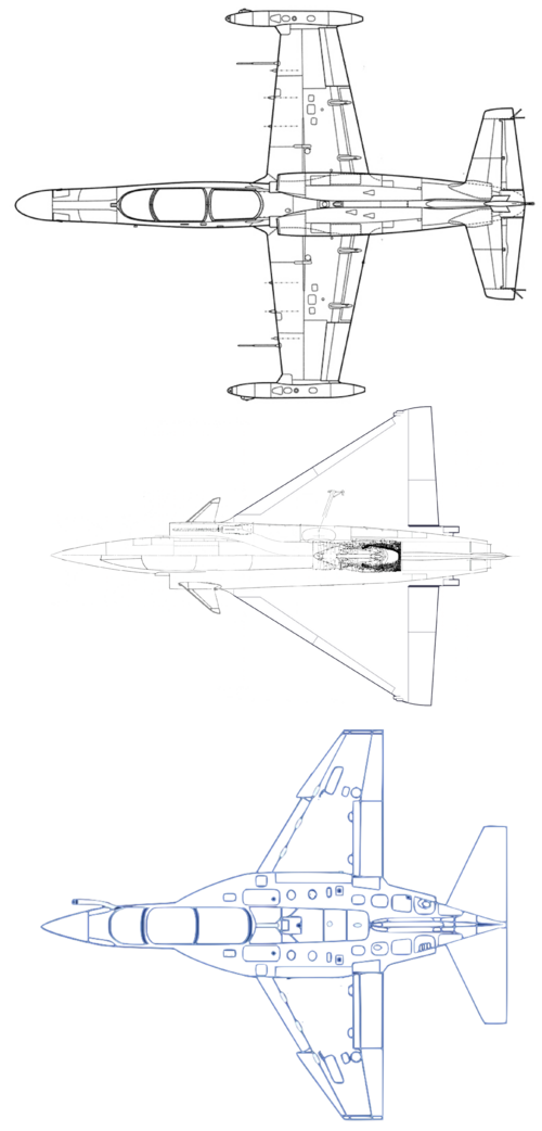

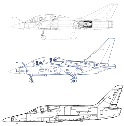

Thought I'd add a side-by-side comparison of 2 of the small light attack/trainers mentioned on this thread - the Leonardo M-346 and Aero L-159 ALCA.
As a bonus, I added my transonic delta-canard "what-if", the Dassault "Zephyr", which uses the same general dimensions as Dassault's Etendard VI and Mirage II... amazing how small those fighters were, smaller even than the 2 trainers above. It looks suitably "fighty"... I wish I could sketch it out in 3D, but that's beyond my skills!
Zephyr B vs M346 vs L-159 200px=1m.png Zephyr B vs M346 vs L-159 top 200px=1m.png
