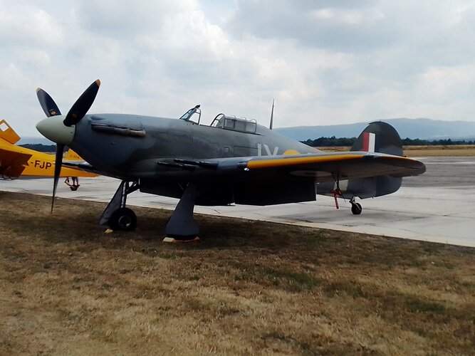

In August, the only flyable Hurricane Mk.IV was lost. Pilot did not survive.
My picture from about hour before the accident:
