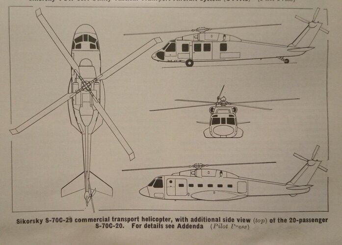

Sikorsky was designing big-cabin S-70 variants even before the UTTAS had flown. So it's a cute story, but that's about it :)

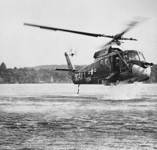

S-70C-29 from 1973.
