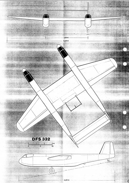

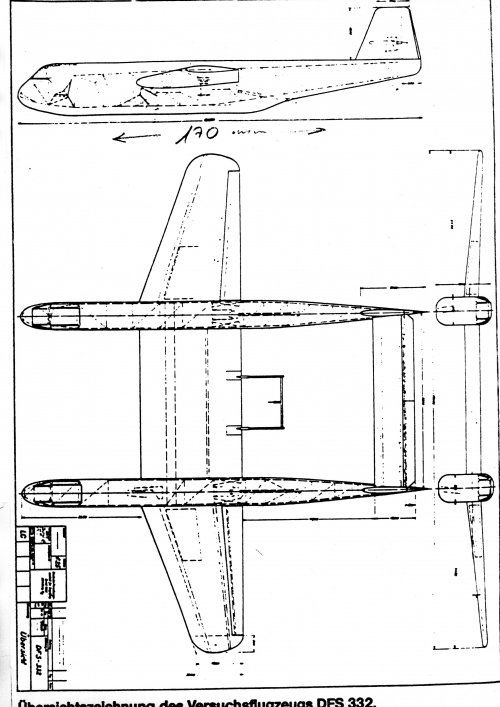

DFS 332 (Initially designed with 2 fuselages, so not a true "Zwilling")

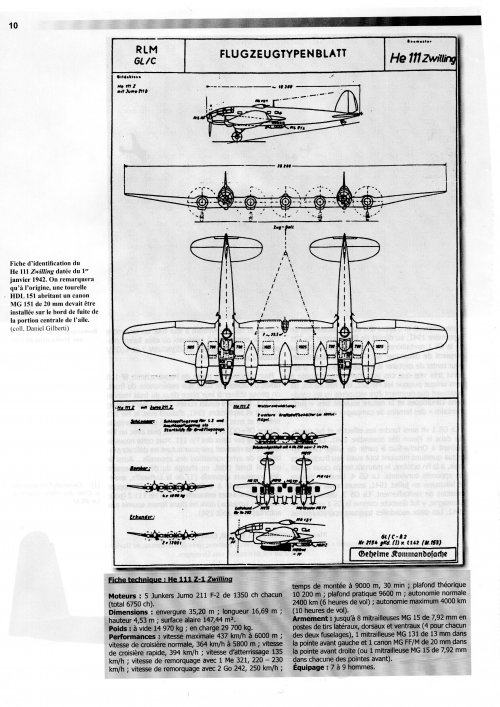

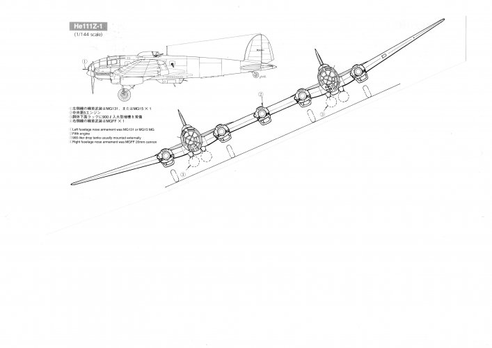

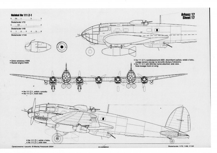

Heinkel He 111Z

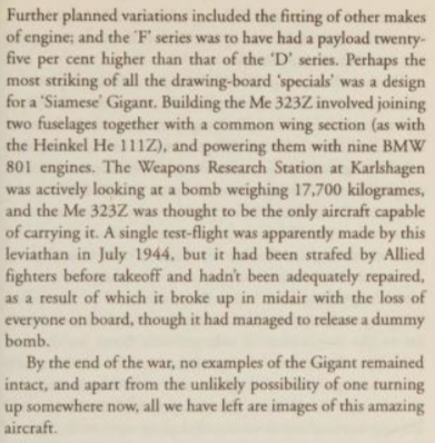

Messerschmitt Me 323Z (Speculated)

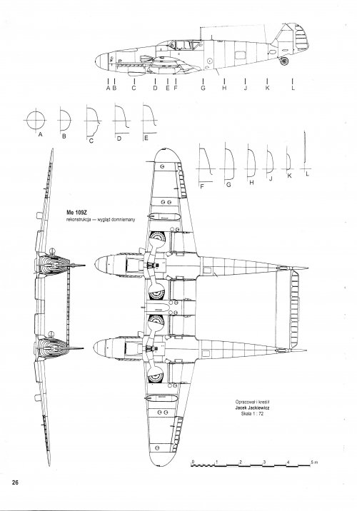

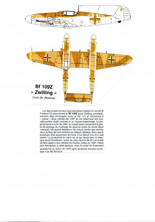

Messerschmitt BF 109Z (Built but not flown; destroyed in a bombing raid)

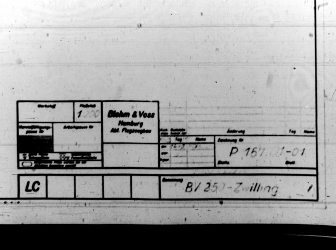

Blohm & Voss BV 222Z

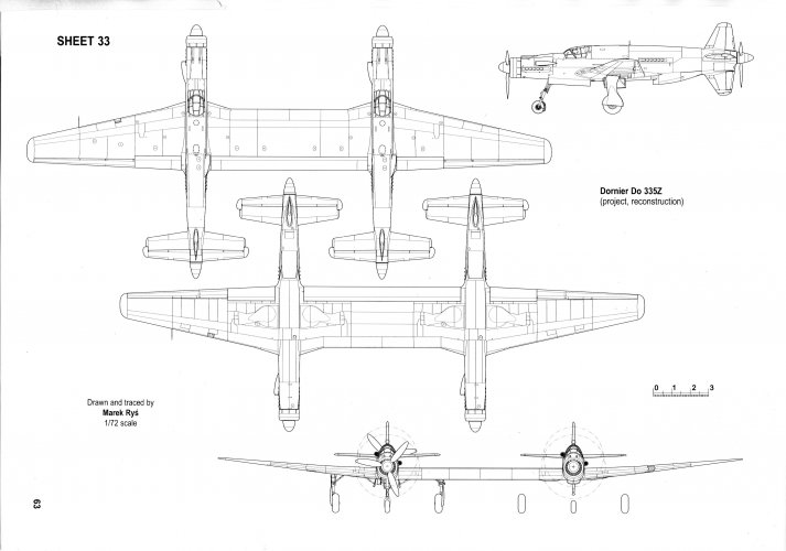

Dornier Do 335Z (Also Do 635/Heinkel P 1075)

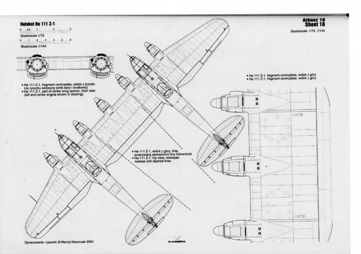

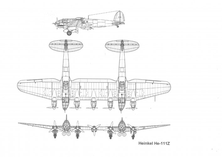

Heinkel He 111Z-2 (He 111Z bomber variant)
Heinkel He 111Z-2 (He 111Z reconnaissance variant)

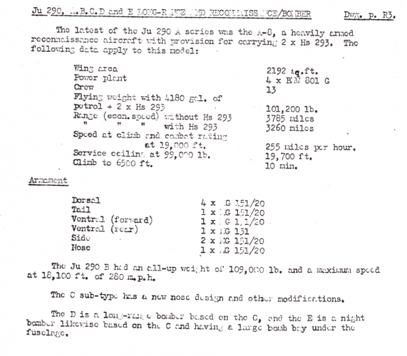

Junkers Ju 290Z

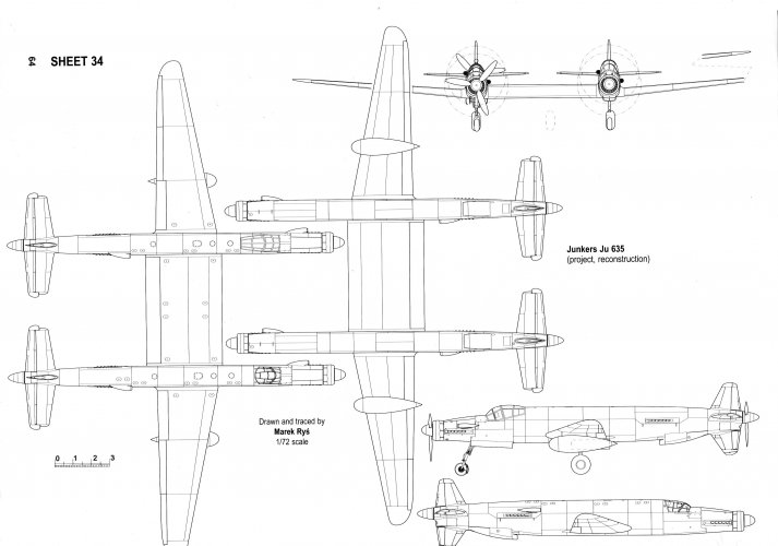

Junkers Ju 635 (Twin Do 335 with significant changes)
Messerschmitt BF 109ZZ (Zwilling Zerstörer (Destroyer))

Junkers Ju 390Z

DFS 203 Zwilling transport Glider based on DFS 230 (build and tested)
the DFS 332 was completely new design aircraft

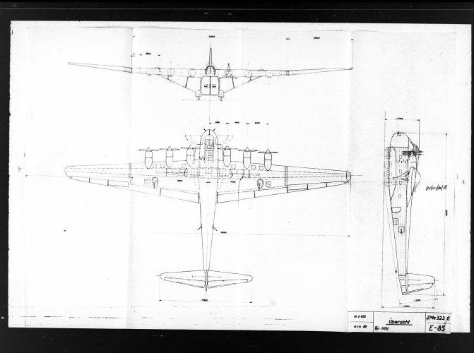

There is no Me323Z however there is the Z/Me323-F
the Z stands for Zeppelin GmbH who build the F series of Me323
to make place for more projects at Messerschmitt
Like Me 609 study the Zwilling version of Me 509
seem the Z label on Z/Me323 let to mistake in some literature to Me323Z ?
Heinz J. Nowarra Die Deutsche Luftrüstung 1933-1945 Band 3
Would fully second Michel here, including his explanation, how this this designation came into being.
Have searched for the "Me 323 Z", too, and yes, it's mentioned in some sites, including Wiki, but I couldn't find it in the other publications I have, not to mention just a single photo, that could be regarded as a prove, that this version ever existed.
What is mentioned in nearly all sources, is the excessive effort demanded from the pilots to steer this aircraft, with sometimes up to 80 kg of pressure needed on the control wheel. In a twin version, this may not have been doubled, but it certainly wouldn't have been reduced, and it's hard to imagine, that power assisted controls would have been incorporated into, what would have been a flexing and wobbling vehicle.
The ZMe 323F and Me 323Z are two different projects. The latter was a twin fuselage variant consisting of 2 E-1 airframes. It was reportedly constructed in the summer of 1944 as a carrier for a 17.7 tonne bomb. It made only one flight, and dropped a dummy of the weapon, which lead to an inflight breakup. There exist no photographs of it, so I will label it "speculated" in the post. Other sources claim it was a modified Me 323 with a He 111Z acting as a tug, which seems more plausible, but likewise unverifiable due to lack of documentation. The one and only way to confirm its existence is to obtain the Me 323 logs and records, which I do believe still exist, but have no idea where to access them.

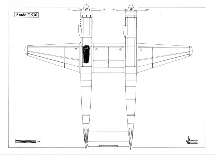

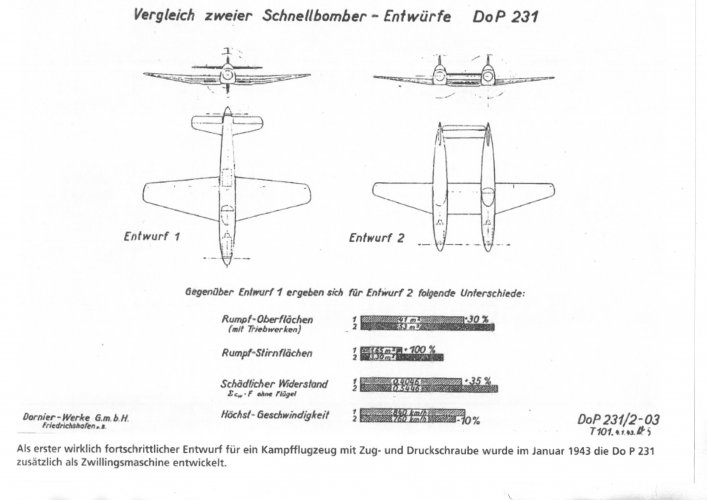

Dornier proposed the project P 231/2 in November 1942.

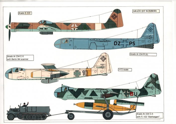

Also in November Arado proposed the E 530, a single-seat high-altitude pressurized bomber designed to compete with the Bf 109 Zwilling for the DB 603 G engines and with the Junkers Ju 86 R-2 high-altitude bomber that had been banned from flying over England since October, to avoid being intercepted by the new high-altitude Spitfires.
The E 530 was expected to be able to fly at an altitude of 11,300 m and 760 km/h carrying an SC 500 bomb.
In order to carry out precision attacks in level bomb mode, Arado developed a new radio navigation system that guided the high-altitude bomber until 30 km from the target, at which point the pilot connected the three-axis Patin PKS autopilot and the Lofte tachometric bomb sight. Both devices acted together, driving the airplane according to the pilot movements over the bombsight. The bomb was automatically released when reaching the point predicted by the EGON system, controlled by a pair of Freya ground radar stations. A combination of the FuG 16 Zy, FuG 101 radio-altimeter computed the automatic bomb releasing.
In December 1942 the E 530 project was rejected in favour of the Me 410, but during a conference in Karinhall, on March 18, 1943, Göring warned the representatives of the aeronautical industry that he would not approve any new project until the requirement in the 1942 specification was met.
Arado E 530 technical data
Wingspan: 16 m, length: 13.9 m, height: 4.9 m, wing area: 35 sq. m, max weight: 10,200 kg, max speed: 760 km/h, service ceiling: 11,300 m, range: 1,850 km, power plant: two Daimler-Benz DB 603G, 12 cylinder inverted Vee liquid-cooled piston engines, each rated at 1,900 hp. with GM-1 power boost, armament: none, payload: one SC 500 bomb on external rack, electronics: FuG 16 Zy, BZA-1, Lofte 7K, Patin LKS 7, FuG 25a and FuG 101a.

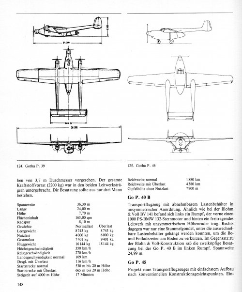

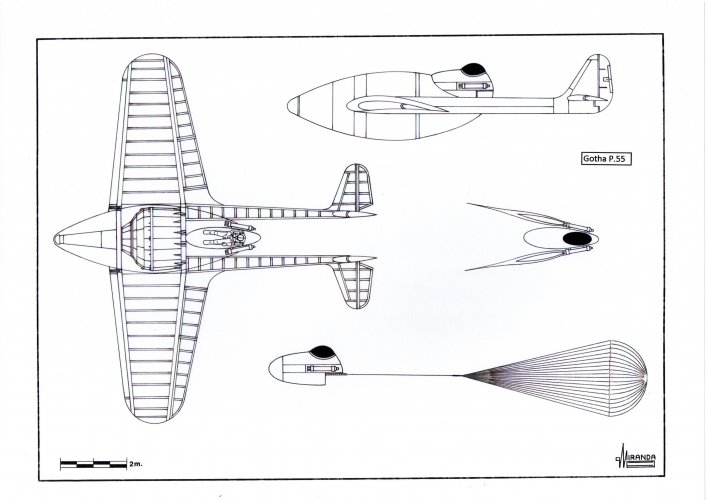

Gotha P.55
It was a twin-boom expendable glider project, with a ballooned fuselage specially designed to contain a heavy load of explosives.
The anti-armour version of the P.55 could carry a warhead SHL 3500 Schwere Hohlladung (hollow charge) capable of destroying a capital ship. The SHL 3500, with 2 m of diameter and 3,500 kg weight, was also used by the Mistel composite-bombers. It contained 1,700 kg of explosive Füllung 95 activated by an extensible probe of 1.8 m called Elephantenrüssel (Elephant's trunk) with four impact fuses at its end.
The Pulkzerstörer version of the P.55 could carry up to 3,000 kg of HE possibly of the RDX type. The glider had to be towed by a He 177 bomber to the vicinity of the bomber stream and released between 1,000 and 1,500 m over the flight level of the enemy planes. The pilot drove the P.55 inward of a 'box' and triggered the cockpit ejection mechanism consisting of two Schmidding 109-543 solid fuel rockets 150 kp thrust each.
The capsule had a design based on the Personenabwurfgerät system developed by DFS for the release of agents into enemy territory. It was stabilized and slowed by a parachute located behind the pilot and could float for later recovery by a U-boat or seaplane. The warhead could be detonated by a radio signal from the He 177 mother plane by a Marder radio-fuse developed by the Orlich Institut for the air-to-air bombs Henschel Hs 293H. The explosion at a defined altitude could also be programmed by a barometric fuse type Baro-1 or an acoustic trigger Stimmgabel that was activated when the sound of the engines of the bombers reached certain intensity.
Technical data
Wingspan: 11.23 m, Length: 9.85 m, Maximum Speed (dive): 900 kph, Glide Ratio 1: 2

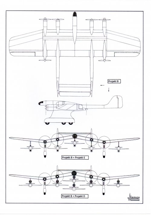

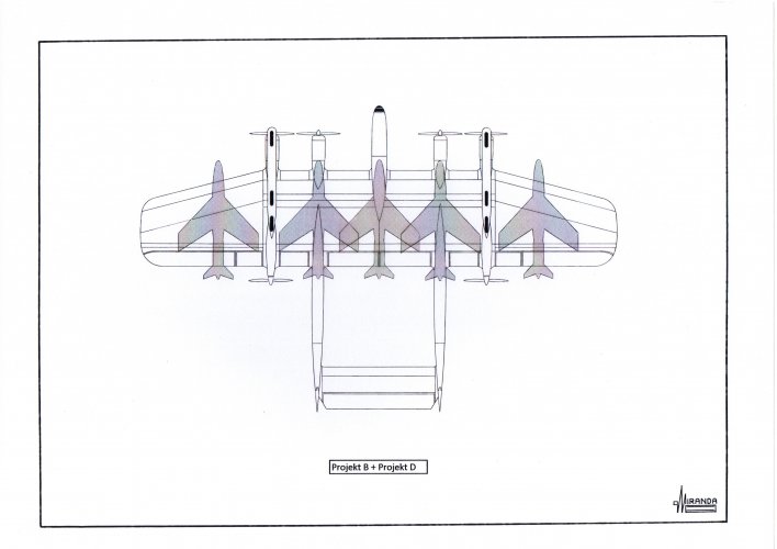

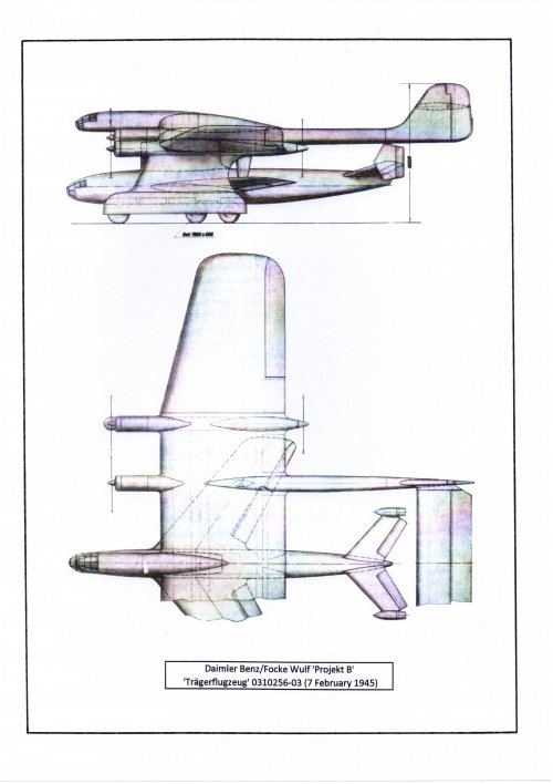

Daimler Benz Schnellbomberträger
In the winter of 1942-43, it was formed a joint study group for the development of the one long-range composite bomber that would be capable of attacking both the Soviet industrial plants beyond the Urals and the cities and naval bases in the east coast of USA. The study group was integrated by Dipl. Ing. Fritz Nallinger and Ober Ing. Übelacker of the Daimler Benz firm and Dipl.-Ing. Kurt Tank of Focke Wulf.
The first design developed by the group in March 1944 was named ‘Projeckt A' number 01-891658 and consisted of a Trägerflugzeug upper element and a Schnellbomber lower element. The first was a giant transport aircraft powered by four HeS 021 turboprops, with 3,300 kp thrust each, mounted on pylons over the 60 m span wing. It was equipped with a huge fixed undercarriage with six 1880 x 680 wheels and enough ground clearance to carry a large load suspended under the fuselage. The Tragerflugzeug crew was of just two men; it weighed 135 tons and had a range of 17,000km. Its length was of 42 m, its height of 14 m and its wing area was of 555 sq m.
The lower element was a bomber of 83 tons, powered by two BMW 18 turbojets with 3,450 kp thrust each, 42 degrees swept wing, with 26.16 m span, and butterfly tail, capable of flying at 1,000 kph with a crew of two men and 5,000 kg of bombs. Its length was of 33.6 m, its height of 4 m and its wing area of 166 sq m.
In May 1944, the RLM ordered Daimler Benz to partner with the firm Heinkel in the construction of the HeS 021 turboprop that had been chosen to propel a long-range reconnaissance version of the Arado Ar 234. Problems with the starter motor and with the design of the reduction gearing for the airscrews delayed the project and the RLM choose to support the construction of the BMW 109-028 turboprop by mid-1944.
The cancellation of the HeS 021 also marked the end of the Projeckt A, but on February 7, 1945, the joint study group presented Projekt B number 0310256-03 to the RLM, a shortened version of Trägerflugzeug with a take-off weight of 122 tons and 73,500 kg payload, propelled by six DB 603N piston engines with 2,750 hp each. Projekt B was designed with a wingspan of 54 m, a length of 35 m, a height of 11.2 m, and a wing area of 500 sq m.
The Schnellbomber also evolved to suit the performances of the mother plane by reducing its size to a wingspan of 22 m, a length of 30 m, a height of 7.3 m. and a wing area of 140 sq m. On December 11, 1944, it was presented to the RLM in two versions - Schnellbomber and Aufklärer - under the name of Projekt C number 0310256-05. The bombing version retained the capacity to carry up to 5,000 kg of bombs at 1,000 kph, although its weight was reduced to 70 tons; their engines were replaced by a single DB 109-016 turbojet of 13,000 kp static thrust, adopting the undercarriage of a Ju 287.
To improve lateral stability the Schnellbomber was equipped with twin vertical tailfins that in the reconnaissance version were replaced by others of ‘butterfly’ type.
With 52 tons of J-2 fuel, Aufklärer could fly 9,300 km with a crew of two men and two photo-reconnaissance cameras Rb 75/30. To increase the range it was considered to use an axial-flow turbofan DB 109-007, specifically designed for a low specific fuel consumption of 1,720 kilograms per hour.
To fight against the Allies convoys in the Atlantic Ocean it was expected that the Trägerflugzeug could carry five Henschel Hs 295 antiship missiles; but in late 1944 the electronic jamming equipment of the allies could void the Germans radio guidance systems. On January 10, 1945, the OKL received a proposal to replace the missiles by a new type of S.O. Flugzeug (suicide airplane) called Projekt E number 0310256-04. In this project, each plane carried a hollow charge warhead SHL 2500 of 1.4 m diameter and 1,800 kg of K1 fuel for its turbojet engine HeS 011. It had 8.5 m of wingspan, 9.2 m. of length and 3.2 m of height. Its estimated range was of 2,000 km and it maximum speed of 1,000 kph.
There also existed a project of a more powerful version, first described in January 1946 as Projekt F in the R.A.F. Report No. 2383 A.I.2 (G) and as Projekt D or Lenkbomber by later German sources. It was a suicide bomber of 10.26 tons, powered by a DB 109-007 dorsal turbojet of 1,275 kp static thrust, with 4,000 kg of J2 fuel and provided with a hollow charge warhead SHL 3500 Holladungssprengbombe activated by a nose probe of 1.9 m, extendable to 2.6 m before impact. It could fly at Mach 0.82, reaching transonic speeds in terminal dive. Lenkbomber had 9 m of wingspan, 13 m of length, 3.10 m of height and 20 sq m of wing surface
Research on the DB 109-007 was paralyzed by the RLM in May 1944, suggesting an earlier date of design for the Lenkbomber.

Dornier

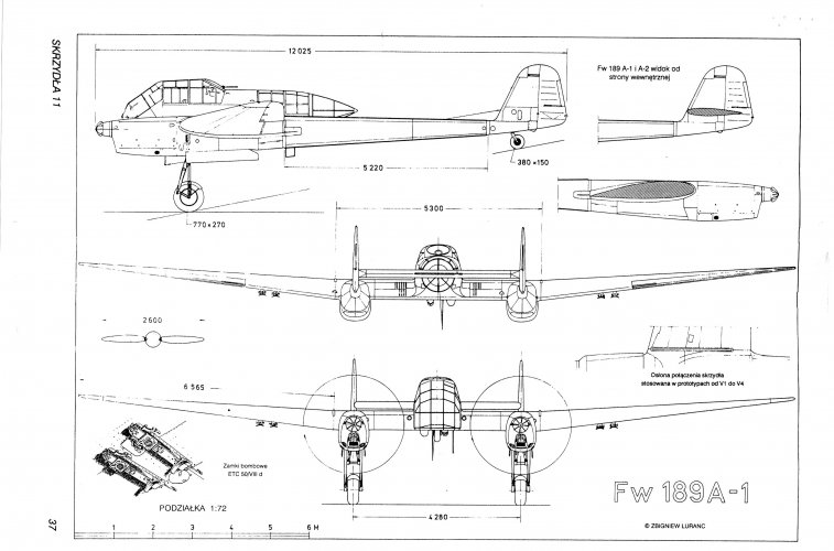

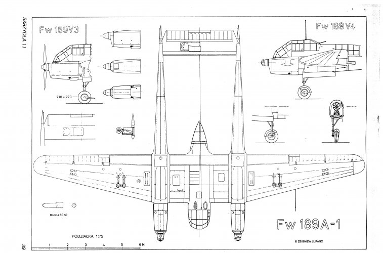

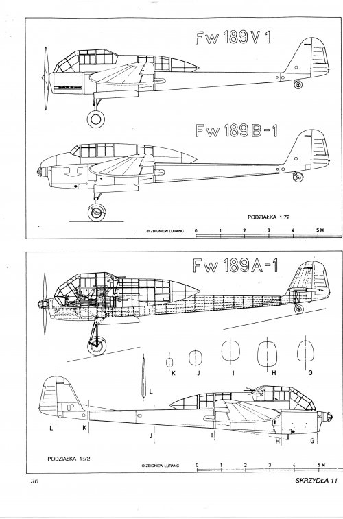

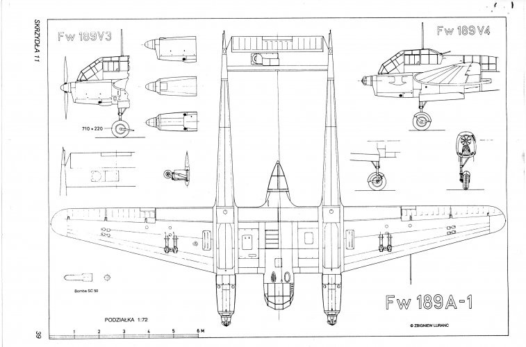

Fw 189

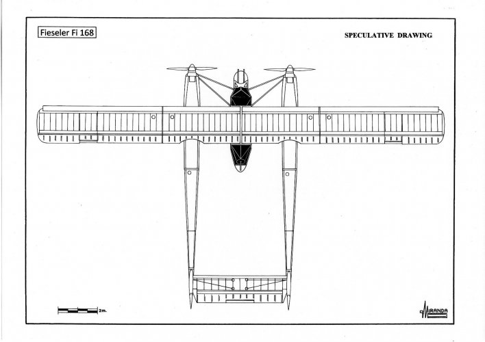

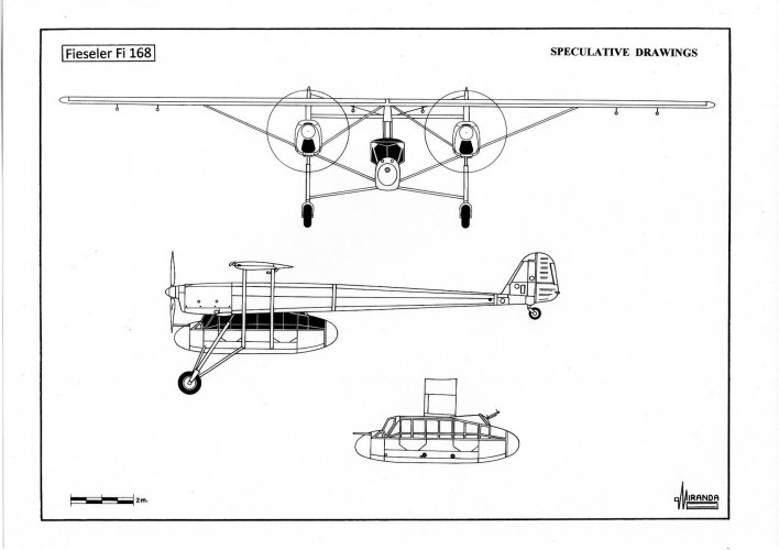

The Fi 168 Panzerjäger was a ground attack version of the Fieseler Storch powered by two Argus As 410 engines.
Construction of the prototype began on September 1, 1938, with the mock-up being inspected by RLM technicians in April 1939.
After the Hs 129 was chosen for mass production, the project was cancelled in September 1939.
Fieseler Fi 168 technical data
Type: two-seat tank destroyer, wingspan: 20.9 m, length: 12.55 m, height: 3.6 m, wing area: 58 sq. m, max weight: 4,630 kg, max speed: 246 km/h, range: 450 km, power plant: two Argus As 410, 12 cylinder, inverted-vee, air-cooled engines , each rated at 465 hp, armament: two nose mounted 20-mm MG FF/M cannons, two nose mounted 7.9-mm MG 17 machine guns and one 7.9-mm MG 15 rear firing machine gun.

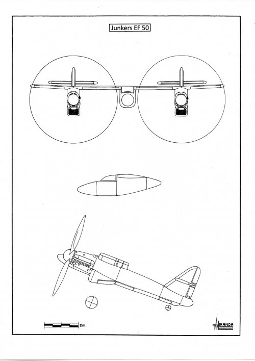

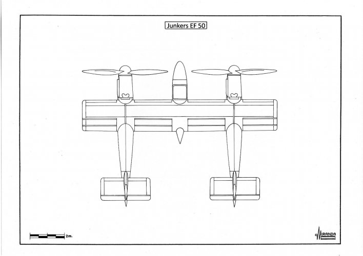

Junkers
Hugo Junkers was so impressed by the capabilities of the Fieseler Fi 145 Storch that envisaged the study of an ultra-STOL armored Schlachtflugzeuge design parallel to the Fi 168 Panzerjäger, searching a solution for the ‘Air Flivver’ problem of stall/spin accidents.
Systematic experiments to determine STOL principles were conducted at the Junkers aero-dynamical institute in Aachen and one wind tunnel model was tested, under the project designation EF 50 (Entwicklungs-Flugzeug).
The new aircraft was designed to be powered by two Daimler-Benz DB 600 engines, driving two-blade, low-speed, five meters of diameter rigid propellers. That would result in a step angle while the aircraft standing on the ground.
Engine power was delivered to the propellers via two-speed gear boxes; the port propeller rotated in clockwise direction and the starboard propeller rotated counterclockwise, providing symmetric airflow over the entire wing surface.
The EF 50 configuration offered an exceptional low speed maneuverability to elude any fighter and the installation of rear-firing weapons was not considered necessary.
The square armored fuselage should provide good yaw stability and spin dampering due to its flat sides.
Leading-edge slats and double-slotted trailing-edge flaps (inspired by earlier 1930 Junkers Doppelflügel) were fitted to control the wings airflow at high angles of attack.
Junkers EF 50 technical data
Type: single-seat STOL project, wingspan: 11.5 m, power plant: two Daimler Benz DB 600, 12 cylinders, inverted Vee, liquid cooled engines, each rated at 900 hp, rotor diameter: 5 m.
Great stuff, but I think, we should stay with the original definition of „Zwilling“, given by Adler in his very first post : „… constructed by joining two existing airframes with a central wing“, contrary to twin boom aircaft.
„Zwillinge“ generally were a kind of a stop-gap measure, relatively quick to build, while twin-booms were constructed as such from the start.

Using the definition of a 'Zwilling' having to consist of two fuselages of existing aircraft, I believe the list looks like this:
Aircraft built:

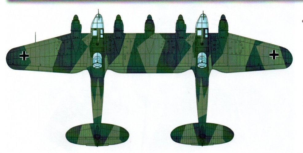

Heinkel He 111Z
Never-built projects:
DFS 203 (DFS 230 fuselages)
Blohm & Voss P 167 (BV 250 Zwilling)
Messerschmitt Bf 109 Z
Messerschmitt Bf 309 Z

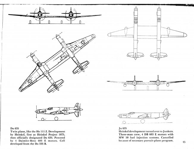

Heinkel P 1075 (Do 335 Z)
Junkers Ju 635 (this used bits of Do 335 fuselages, rather than complete fuselages, but still)
Broadening the definition of 'Zwilling' to include twin-fuselage designs based on non-production model fuselages, we can add the following:
Aircraft built:
DFS 332
Arado E 530
Blohm & Voss P 166
Dornier Do P 231 'Entwurf 2'
Heinkel unnamed twin-fuselage project of October 8, 1942
Hirth Hi 23
Jacobs-Schweyer Jas P 5
Junkers EF 109
To address the other designs mentioned individually:
Messerschmitt Me 323Z - no evidence for this.

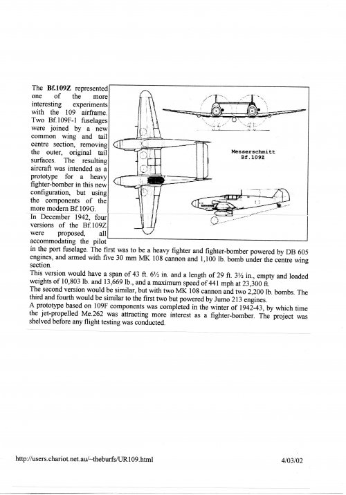

Messerschmitt Bf 109 Z actually being built - no evidence for this either.
Blohm & Voss BV 222Z - no evidence.
Junkers Ju 290Z - no evidence
Messerschmitt Me 209 Z - mentioned by Milch in a GL meeting as something that might be desirable but no evidence that Messerschmitt ever worked on it. The Schnellbomber contest had been won by the Do P 231 before the Me 209 fully succeeded the Me 309.
Me 409 - a Bf 109 with DB 628 engine.

The DFS 332 was constructed as a twin fuselage design mainly because it was the best configuration for testing different wing designs using the centre section.
There was a ZMe 323 F, ZMe 323 G, ZMe 323 H and lastly the Z SO 532.
But there is no evidence whatsoever for an Me 323 Z. No mention in any primary source.
Aircraft built:
Heinkel He 111Z

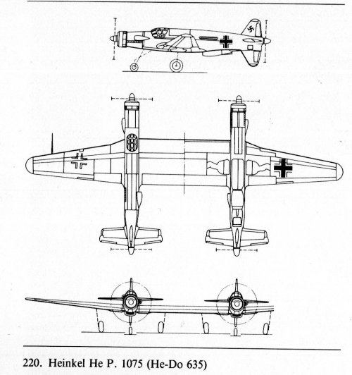

DFS 332

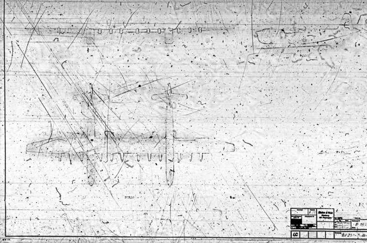

Hello and thank you. Mr. Dan, would you happen to have any more information on the DFS 203 and BV P.167? I could not find any documents relating to the former, whereas the BV P.167 is only referenced in a single drawing attached below. (Originally posted by @kiradog in https://www.secretprojects.co.uk/threads/blohm-und-voss-bv-238-drawings.4712/ )
DFS 203 - this is covered in Luftwaffe - Secret Projects of the Third Reich.
Blohm & Voss P 167 - there's a lot of primary source information available about a lot of obscure Blohm & Voss projects, but not this one. The only known evidence of it is that drawing. I did, however, scan it from the microfilm myself with a bit more clarity. Even then, the original is just too faded to get any more detail out of it.
Interesting that the nose of the port fuselage appears to be different from the nose of the starboard one, making it asymmetrical.

The Me 323Z is very related to the story of the German "17.7-ton bomb" I've been (very casually) digging into lately. You can read about that over in its thread, but here's the abridged version: the 323Z seems to originate in the book Last Talons of the Eagle: Secret Nazi Technology Which Could Have Changed the Course of World War II by Gary Hyland and Anton Gill. Being overly interested in this whole thing I finally just set up an account on archive.org as the book in question is available for their stupid one-hour loan thing. And here's what I've got:
A single test flight was apparently made by an Me 323Z at the Karlshagen test grounds sometime in the latter half of July 1944, carrying a dummy of a 17,700kg (there it is again!) bomb that was successfully dropped. However, the aircraft had been damaged in the days prior to the test by Allied strafing, and insufficient repairs caused it to catastrophically break up in midair. Construction-wise it was built the same as the He 111Z, with two fuselages joined by a common wing section, and powered by nine BMW 801 engines in place of the four or six Gnome-Rhône 14Ns of the regular 323. That would be a notable increase in power, 801s were rated at 1550-1950hp compared to the 1100 of the Gnome-Rhône, and might have been enough to get a Gigant-Zwilling off the ground. No mention is made of whether it actually was able to take off without assistance. And if any photos of the 323Z were taken, none are known to survive.
Yes, the 323Z seems to be indivisibly linked to that equally unproven 17.7-ton bomb. A bit strange to me, that a book with the subtitle "Secret Nazi Technology Which Could Have Changed the Course of World War II", so implying, that this regime was at least in some parts better, and more efficient, than it obviously was in reality, comes up with a project, that in my opinion, makes the Nazis look quite dumb.

The Blohm & Voss P 167 exists as a single drawing (and it also appears on both versions of the company projects list) and it would still be more believable to say that the P 167 was built and flown - because there is at least some evidence that it was 'real'.
