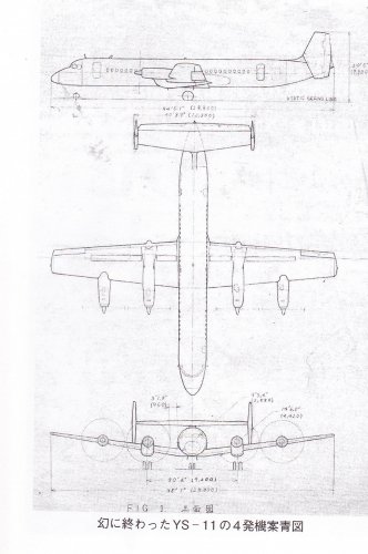

Hi!
YS-11 plan with 4 engines. (No detail data.)
Source : Maru magazine special edition "JIRO HORIKOSHI WAY OF THE ZERO FIGHTER" in 15/8/2013
Wow thanks my dear hesham! :)
So this was a double powered YS-11! :eek:

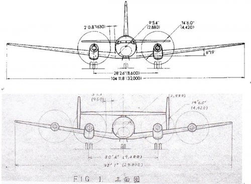

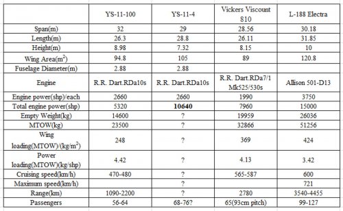

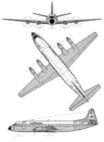

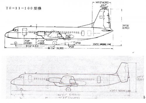

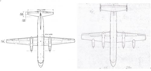

Hi! YS-11 and YS-11-4 in each view are almost same scale.

Hi!
From Japanese wikipedia.
YS-11S (YS-11-4) was a short-take-off-and-landing type of YS-11.
This airplane carried four engines and the tail stabilizers were largely modified.
The range of this airplane was 900 km, and taking off and landing was possible for the runway of a 600-m class.
This airplane was planned in order to bid for the international competitive bidding(1970) of the STOL passenger plane used for the short distance city suburbs route of American Airlines.

What strikes me, is the capacity of both designs. Whereas the YS-11 is credited with about 60 pax,
the VFW 614 had just a capacity of 40 !

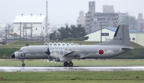

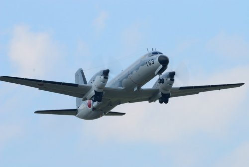

Hi Super YS(YS-11EA).
YS-11 with T64-IHI-10 engine.
Japanese airline pilots said that YS-11 was a under power aircraft.
Sorry YS-11-4 is simply my mistake. I mean YS-12-4.
But I can't find the name of YS-12 in Japanese sources. :-[
