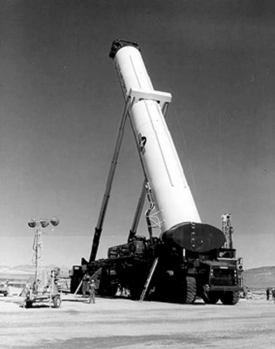

sferrin said:
It's when they go crazy like this:
that it's a problem. Supposedly that thing was well over 500 tons (I seem to recall 800 tons). Why on God's earth it needed to be so heavy I have no idea.
This was a weird case, for sure. Some of the size is because it's double-ended and totally redundant. It was meant to drive around an MPS road network and needed to reverse direction without turning around, and I think both tractors could move the whole vehicle. Also, MX was a huge missile (pushing 100 tons) and the mobile versions probably came in a pretty heavy capsule for protection from environmental hazards.
I think this version was designed for use in the vertical MPS scheme, where the transporter-elevator had to move the missile around, then raise it up and insert it into a hardened vertical silo. It's not a full-on TEL, I believe, but in some ways worse because it has to carry the gear to insert or extract the missile from a silo as well.
This shot makes me think it could launch it too:
I think it's (unintentionally) deceptive. This is capturing the Transporter-Emplacer at the point where it has elevated the capsule to just past 45 degrees. It would then slide the bottom of the canister forward to bring the whole unit to vertical. Then it would lower the capsule into the silo through a hole in the middle of the chassis.
The following link is primarily about the guidance system that would keep the two tractors following the same track around curves and control the positioning of the vehicle above the silo. But it also has a brief description of the elevation process (page 4 of the original document, page 5 of the PDF).
http://www.minutemanmissile.com/documents/MXTransporterEmplacer.pdf
Interesting. I was unaware of a scheme to shuttle amongst silos, just the horizontal shelters. Thought maybe this was a demonstration showing the transporter could elevate and launch the missile if it got caught out in the open during an attack.
There are so many variations of launcher and basing schemes for MX that it's really hard to keep track. They did look at the DASH relocation option, where the missile could be moved rapidly from one launcher to another on warning. And that was complicated because depressed-trajectory SLBMs could catch missiles on the move in the open, rendering all the shell game and hardened shelters moot.
I don't think they ever had a version where the TEL could launch in the open, but it might be possible. The issue would probably have been accuracy. Back in pre-GPS days, accuracy could suffer considerably without having a really well-surveyed preregistered launch location.

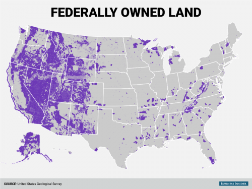

Unless you have a truly continuously mobile force, the largest contiguous area of Federally owned land is still small enough so that
a depressed trajectory blind barrage bombardment from one SSBN could (for a practicable launcher hardness) destroy the entire mobile force.

Why would you pile your entire mobile force into one tiny area? Also, Midgetman was designed to survive a somewhat near miss. As your map shows, there is a LOT of federal land that could be used. No way, not even if they were chucking Tsar Bombas by the score, could one SSBN blanket that entire purple area with enough overpressure to disable every Midgetman (or analog) in it. The unknown is how hard was the Midgetman launcher. Also does the US launch on warning? I'd think with today's technology, it would be relatively easy to make a visual confirmation with plenty of time for US ICBMs to be on their way before warheads started landing.

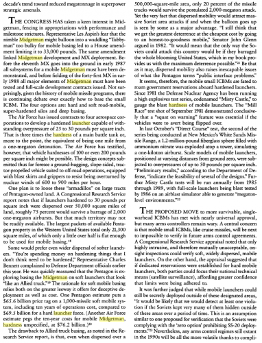

Hmm. Here's a pretty interesting writeup of the problem:
edit: (From Bulletin of Atomic Scientists Nov. 1984)

*If* the mobile launchers are continuously mobile then yes one SSBN could not blanket the area.
But continously mobile was not the plan for Midgetman; it was disperse on warning.
Midgetman was only hard when hunkered down which means you need pretty high quality RV arrival time data.
The large areas that have suitable climate and terrain and are owned by the federal government are limited.
