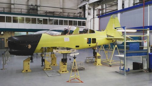

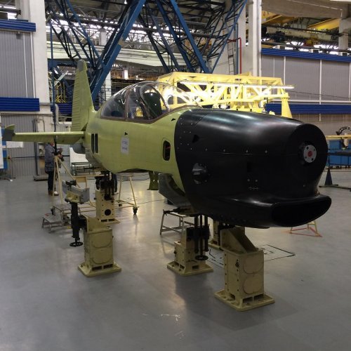

Prototype of the Yak-152 under construction...

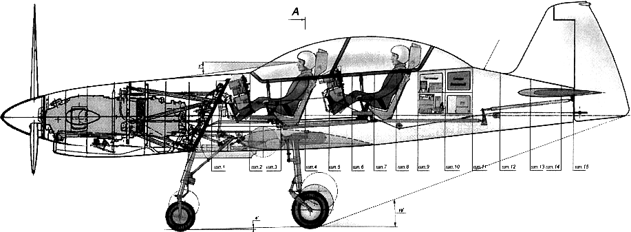

Here I leave the link of the speculative schematic section of Yakovlev Yak-1000
http://www.secretprojects.co.uk/forum/index.php/topic,23005.msg279736.html#msg279736
New Yak-152 Trainer Will Come With Alternate Powerplants
by Vladimir Karnozov - June 22, 2016, 7:39 AM
The Irkutsk Aviation plant (IAZ) of Irkut Corporation has mated the fuselage with the wing of a prototype Yakovlev Yak-152 twin-seat weaponized piston trainer. The project was revealed at the Singapore Airshow and is said to be on track for first flight by year-end. Both piston and diesel-powered versions are planned.
The fuselage is a semi-monocoque all-metal construction except for the engine cowling, which is made of carbon-plastic. Wings are made of aluminum alloys. Yakovlev says the extensive use of metal is for simplicity of manufacturing, ensuring low costs, as well as for ruggedness and ease of repair.
The prototype is powered by a diesel from Raikhlin Aircraft Engine Developments (RED) of Germany. It is available in two versions, 300 (A05/V12) or 500 hp (A03/V6). The latter provides sufficient power for the Yak-152 to fly with four underwing weapons pylons and up to 550 kg [1,100 pounds] of munitions on them. In one of the possible configurations, the inner attachment points would be occupied by rocket pods or R-73 air-to-air missiles, and the outer ones with a 50/100 kg caliber (110-220 pound) bombs. On a reconnaissance mission, the Yak-152 can take pods for aerial photography, radiation, bacteriologic and chemical warfare.

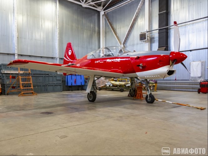

Irkut has rolled out the first Yak-152 prototype and the aircraft is said to be making its maiden flight this month.
Source with picture: https://www.facebook.com/valeriy.borz/posts/1141699539229776
https://www.flightglobal.com/news/articles/first-flight-for-yak-152-trainer-430070/
