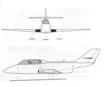

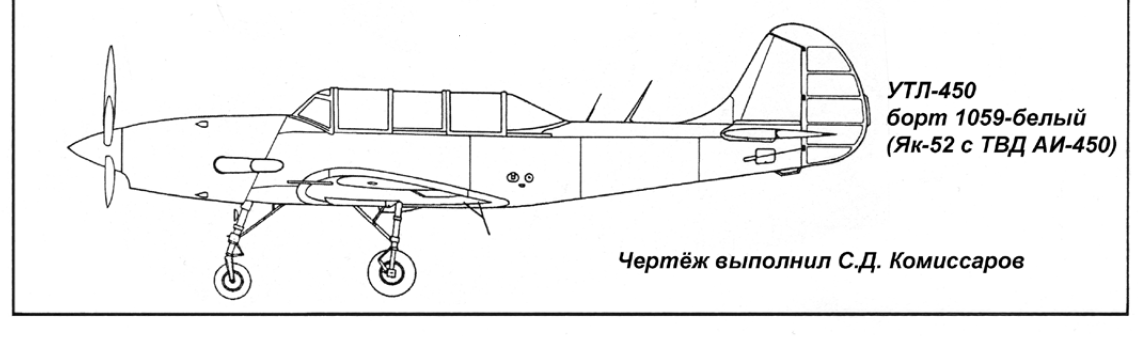

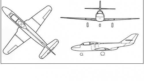

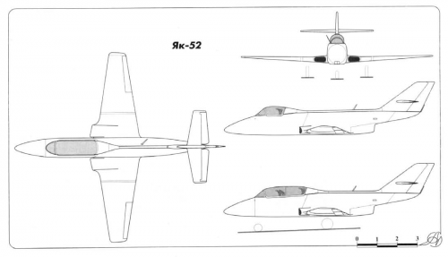

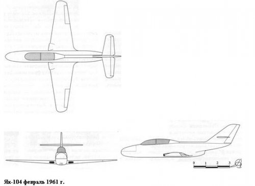

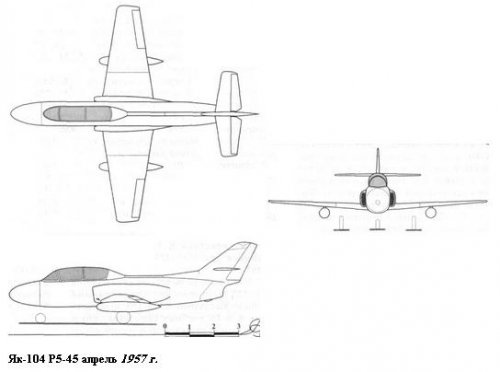

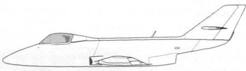

At 1 and 2 photo project the training samolet Yak-30
At 3, 4, 5 photos in 1971 was offered the project Yak-52 (the first aircraft with this designation) based on the Yak-30, but with a new engine, AI-25. The plane had two options: a double training session and single aerobatic. Yak-52 (photo 4) had to compete with the successor of the L-29, who had the same engine as the AI-25. But further work on the Yak-52 was not
early design to YAK-30.

Aviatsia i Vremya Magazine (February/March 2012) had a couple of articles about the development of Yak-104 ...
Yak-104 - Design started February 1957, mock-up completed August 1957. Originally proposed with R5-300 engine but ended up with RU29-300. Development authorised by SovMin resolution July 1958, same time as TS-11 and L-29 were being developed.
Yak-104D - A design with refinements to fuselage, wing, undercarriage and cockpit as a result of instructions from A.s. Yakovlev. This model was redesignated Yak-30.

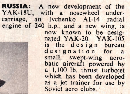

From FR 3/1958,
here is a small info about Yak-105 ?.

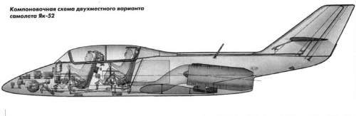

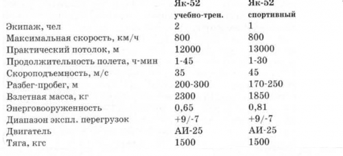

Some more on the first Yak-52 project for a jet trainer mentioned in Igor_Mich's earlier post.
The data table shows the details for the twin-seat trainer and aerobatic single-seat versions.
Source: Aviatsia & Kosmonautika (A+K) Magazine January 2003

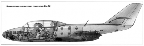

Nice find my dear Cy-27.

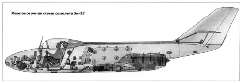

Two more Yakovlev trainer artwork side views to compare with the one in my earlier post. These are for the Yak-30 and Yak-32 (should have been posted earlier, but I forgot to attach them).

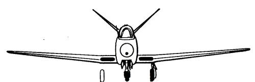

In my files,
the early Yak-104 had a front intake instead off two side intakes,need confirm ?.
hesham said:
In my files,
As I know this Project was from 1952,and refined as anther one in 1955,but
no drawings survivor ?.

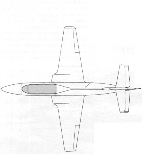

From Kryl'ya Rodine 2024-3/4.
