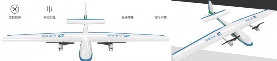

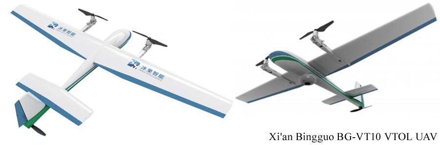

Xi'an Bingguo BG-VT10 - Tilt-rotor VTOL drone, twin tilting rotors/propellers, vertical rotor/propeller beneath tail. Tail rotor is for trim during take-off and landing.
Performance: Speed: 50-80 km/h; Ceiling: 5000 m; Working Altitude: 3000 m; Wind Resistance: Level 5; Control Radius: 30 km
Maximum Battery Life/Endurance: 90 min
Construction: Composite material; carbon fibre propellers/rotors
Power: (??)
Dimensions: Span: 2.2 m; Rotor Diameters: Main 2.15 inches (55 mm); Tail 1.14 inches (29 mm)
Weights: MTOW: 9 kg; Max Payload: 2 kg
Sensor: Sparkle Tech EOT-140A3 gimbal camera (Sony CMOS);* 1.8 kg; IR & TV
-- * CMOS = Complementary Metal Oxide Semiconductor
-- 1080P full HD 23.4 million pixels, PDAF through-the-lens autofocusing

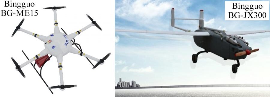

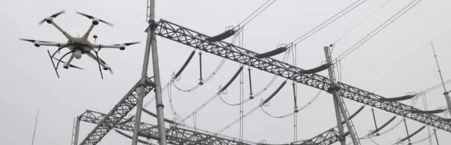

Xi'an Bingguo BG-ME15 - 201? surveillance hexacopter. Operational in 2018 performing environmental protection monitoring flights over newly-installed high-tension transmission lines and local substations. (The powerline inspection role is now being done by hybrid BG-MH30s.)
"BG-ME15 carries a five-slot tilt camera for aerial photography". I'm assuming that "five-slot" refers to the E/O's five-lens multi-spectral camera.
Performance: Max Speed: 50 km/h; Cruise: 10 km/h; Payload: 6 kg
Maximum Battery Life: 1 hour
Construction: Composite carbon fibre material
Power: 6 x (??) electric motors
Dimensions:
Weights:
Sensor: Sparkle Tech EOT-140A3 gimbal camera (Sony CMOS); 1.8 kg; IR & TV
Sensor: Shenzhen Viewpro Z10F gimbal camera; 10X zoom
Sensor: (make?) 5-lens multi-spectral camera (water pollution analyis)
_____________________________

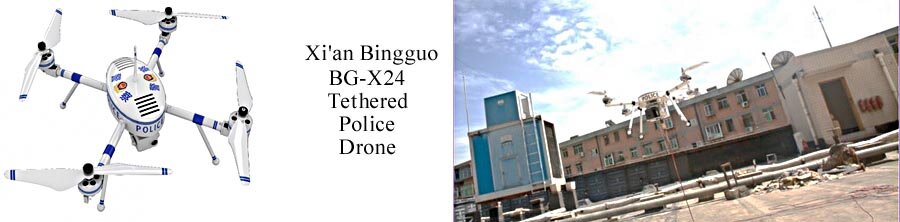

Xi'an Bingguo BG-X24 - Tethered surveillance quadcopter, 24 hour endurance due to tether incorporating ground power cord. Single operator, designed to be packed "in the trunk of a police motorcycle". Intended for police operations: Urban monitoring, traffic direction, facial recognition.
Performance: Speed: 29 km/h; Ceiling 50m (limited by power cable length)
Maximum Battery Life: 24 hours (continuous work) with tether power cable
Hover Accuracy: Horiz. ±1.5m Vert. ±1.5m
Power:
Construction: Carbon fibre composite material; carbon fibre propeller
Dimensions: Wheelbase: 450 mm; Propellers Diameter: 12 inches (309 mm)
Weights: MTOW: 3 kg ; Payload: 500 g

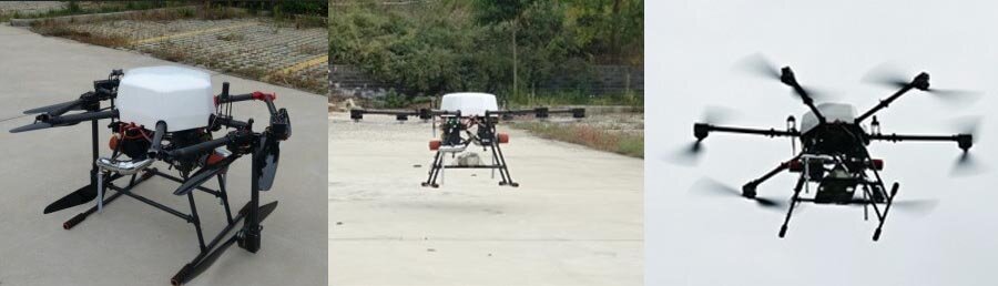

Xi'an Bingguo BG-MH30 - 2015 free-flying surveillance hexacopter, petrol-electric hybrid drive. Aka 'Bingo-MH30'. The 'first generation' BG-MH30 was developed in 2015. The 'third generation' BG-MH30 introduced variable-pitch rotors. There's no mention of a 'second generation'.
Performance: Max speed: 10 m/s; Cruise: 8 m/s; Max ascent: 3 m/s; Max descent: 2 m/s; Ceiling: 2000 m; Wind Resistance: Level 4
Maximum Battery Life: 4 hours
Power: Petrol-electric hybrid (no details provided)
Dimensions: Frame deployed: 1650x1650x750 mm; Folded: 1150x1150x750 mm
Weights: MTOW: 35 kg; Payload: 14 kg; Fuel: 6 kg (fuel consumption 3 kg/h)
Propellers: Carbon fibre material; Propeller Diameter 32 inches (813 mm)
Data Transmission: 50 km

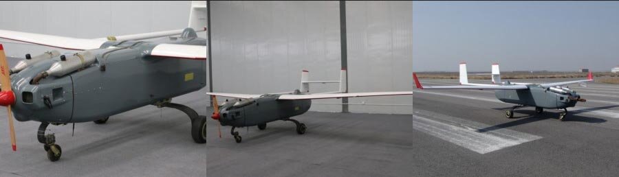

Xi'an Bingguo BG-30 - Low-winged, twin-boomed pusher with fixed wheeled undercarriage.
Performance:
Maximum Battery Life: 8h
Power: "Advanced aero-engine imported from Germany"
Dimensions:
Weights:
Sensors: HD PTZ pod with 30x optical zoom and 1080p full HD video recording
Data Transmission: 30 km high-definition image real-time return
Xi'an Bingguo BG-JX300 - High-winged, twin-boomed pusher with fixed wheeled undercarriage.
Performance: Max speed: 220 km/h; Cruising: 150-180 km/h; Climb Rate: 4 m/s; Ceiling: 7000 m
Endurance: >10 hours (full load); 1600 km at 160 km/h; Radius: 800 km
Construction: Carbon fibre composites and aviation aluminum alloys
Power: 1 x 630 cc two-stroke HO2 tractor engine
Dimensions: Span: 7 m; Length: 4.3 m; Height: 1.7 m
Weights: MTOW: 350 kg; Airframe Weight: 270 kg; Max Payload: 80 kg;

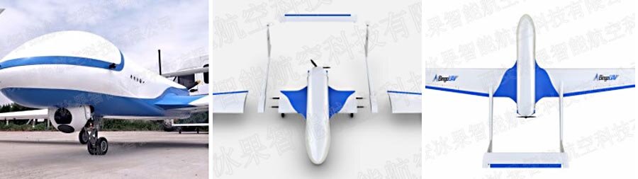

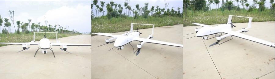

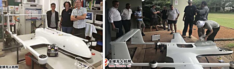

Xi'an Bingguo BG-V45 - Low-winged twin-boomed pusher VTOL (with 2 x lift-rotors on each boom and pusher prop at the rear of the pod), fixed skid undercarriage. Promo text suggests that the original designation may have been 'BG-35' .
Performance: Max speed: 140km/h; Ceiling: 5000 m; Wind Resistance: Level 5
Endurance: Full Fuel = 5 hours (fuel tank 10L); Control Radius: 50 km
Construction: Carbon fiber composites and aerospace aluminum alloys
Power: (Presumably petrol for pusher prop + electric for 4 x lift-rotors)
Propeller Diameters: Pusher: 20 inches (508 mm); Rotors 32 inches (813 mm)
- Propeller construction optionally available in wood or carbon fibre
Dimensions: Span 4.1 m
Weights: MTOW: 45 kg; Max Payload: 10 kg
Sensors: Undernose electro-optical turret
Data Transmission: 30 km long-distance data transmission
_____________________________________________
So, does anyone have more Xi'an Bingguo products?
