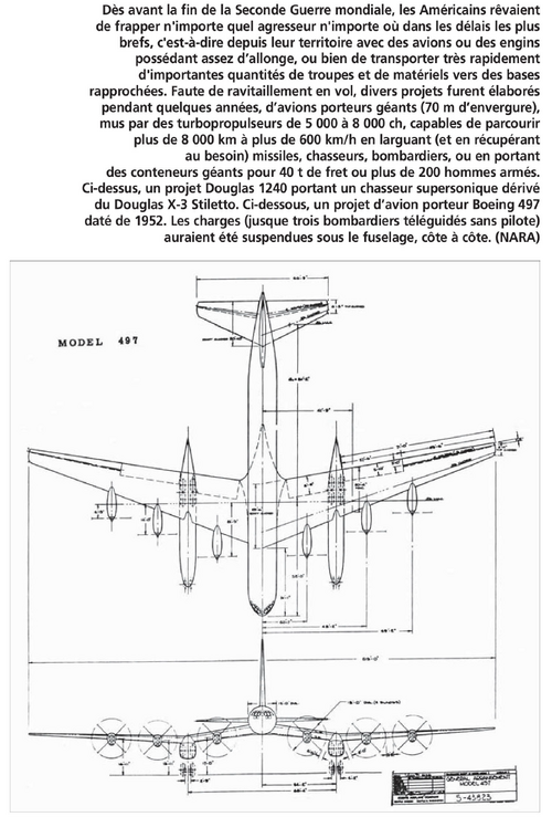

Boeing Model 497 picture here:
http://www.secretprojects.co.uk/forum/index.php/topic,8036.0.html

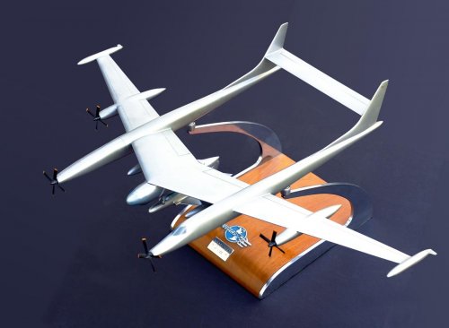

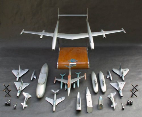

The Douglas entry was the Model 1240, a twin-fuselage design based on the wing of the Douglas Model 1211-J bomber proposal. Shown here is the Douglas 1240 concept model with various parasite aircraft, missiles and payloads. The high-speed penetration bomber component has three engines and no landing gear, as it was expected to return to its mother ship, politely loitering outside enemy airspace during the weapons delivery run.

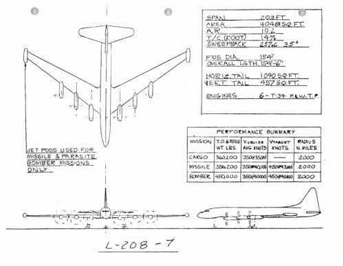

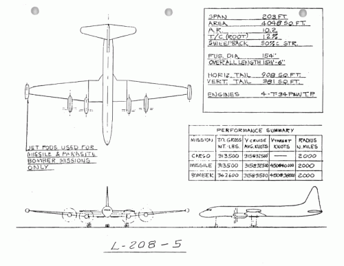

Here are the Lockheed L-208-5 and -7. The -8 version was to be a straight-winged -7, and was apparently the only iteration that met the requirements.

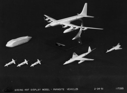

and for comparison here the Boeing Boeing Model 497 picture
Are there nose air intakes or glazed noses? It seems there are jets in the fuselages of this twin-fuselage big plane: the two external jets may be not enough power.
These are four turboprops. The propellers are removed and sitting in front of the model, behind the landing gear. Wingspan and thrust centerlines are identical to those of the Douglas 1211 (B-52) bomber proposal. There is only one, asymmetrical canopy on the port fuselage.

Are there any three-views (or at least a side view) of the Boeing 497, and if so, can anyone here tell me where I might find one?

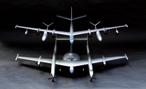

This photo shows the Douglas Model 1211-J bomber (top) from 1950 and the Douglas Model 1240 (bottom) from 1951. Note identical thrust centerlines. Props on the 1240 are all pullers, not contra-rotating. Model 1240 was configured like an oversized Fairchild XC-120 Pack-Plane.
You might be right. It appears there was also a choice of powerplants between jets and perhaps turbo-props. I can't explain the present of the four sets of propellers otherwise.
My take on that is that the model is shown in a disassembled state, I imagine that it is solely turboprop powered. Note also the landing gear lying on the floor. I doubt that is an optional extra ;)
Hole in the ground, you are correct. Unlike the Model 1211-J, the 1240 had no turbojets, not even optional ones. Just four big turboprops. Look for a comprehensive monograph about this little-known competition and the Douglas Model 1240 in particular, due out sometime this year. This was a big, bold and ambitious program, even by the visionary standards of 1950s America.

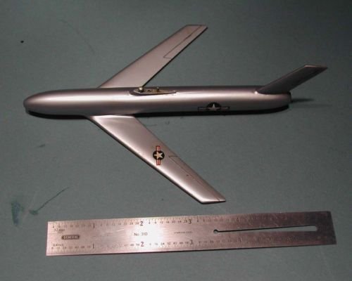

...may be a model of a proposed "parasite" cruise missile that would have been carried by a proposed Convair Nuclear bomber. It has no identifying marks but has an attachment on the top to fit on to a larger mother model. It measures about 6" in length and is of metal construction and is in excellent condition.

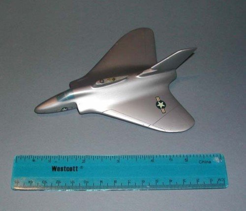

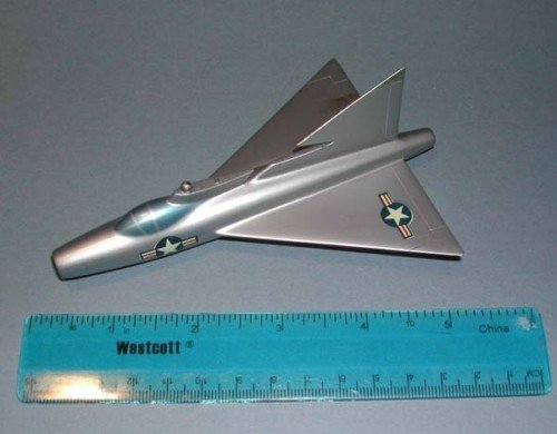

This is a model of a proposed "parasite" fighter that would have been carried by a proposed Convair Nuclear bomber. Very similar in design to the XF-92. It has no identifying marks but has an attachment on the top to fit on to a larger mother model. It measures about 5" in length and is of metal construction and is in excellent condition.

This is a model of a proposed "parasite" fighter that would have been carried by a proposed Convair Nuclear bomber. Very similar in design to the F4D Skyray. It has no identifying marks but has an attachment on the top to fit on to a larger mother model. It measures about 5" in length and is of metal construction and is in excellent condition.

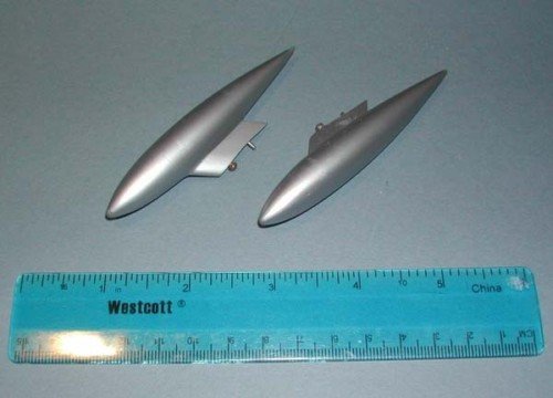

Don't forget the fuel tanks...
[link no longer active]
These actually seem to be identical to the accessories from the Douglas Model 1211-J model owned by John Aldaz as seen in American Aerospace Archive 5 - MOTHER SHIPS, PARASITES & MORE: Selected USAF Strategic Bomber, XC Heavy Transport and FICON Studies, 1945-1954
Northrop XSSM-A-3 Snark missile
Convair XF-92A parasite fighter
Douglas XF4D-1 Skyray parasite fighter
Droppable fuel tanks

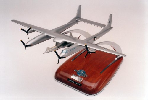

Move over, White Knight II. Here comes the Douglas Model 1252, with over 50 years' head start! Shown here as a launch platform for the Navaho intercontinental missile, from North American Aviation.
Note the astro-inertial navigation system window on top of the Navaho.
