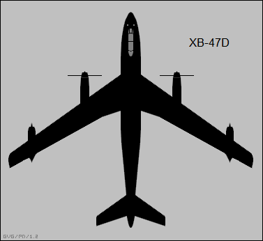

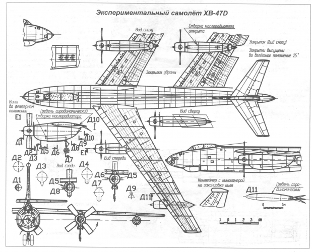

Was production of the B-47D (turboprop) ever considered? From what I have read the speed of the D model was very close to the jet powered model. How did the aircraft's range compare with other versions of the B-47?
Does anyone have a decent 3-view of this aircraft?
Thanks,
Fishjay (Lester)

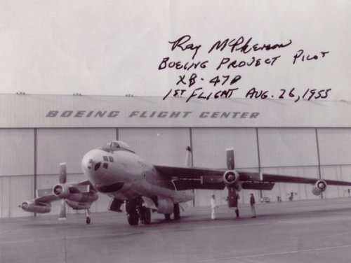

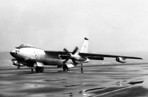

I actually came across the first mention of the XB-47D here on this site in a previous thread in which it was not the topic of the thread, but mentioned in the thread. I do not have too much info on the beast, but I thought that it would be fun to modify a scale model of a standard B-47 to the XB-47D. I will share what I have found on it, though it is not much more that what I have been able to find after a few nights of searching on the web. Are there any more detailed pictures that are had out there. More specifically of the engine installation. From what I have read, there were a handful of prop installations tried. The only numbers that I have found have been a general mention of a 15' diameter 4 blade prop with a 24" chord. I have found some general information on the Curtis Wright YT49W-1 and YT47W-1 turboprop engines. I did find it interesting that the YT47 was slated to have almost double the SHP while actually burning less fuel. Comparing the YT47 vs the YT49 the SHP was 11400hp vs 8500hp with 6380lb/hr vs 6815lb/hr respectively at takeoff condition. I do believe that it was the YT49 that made it into the aircraft for testing. It seems that the major element that would have effected fuel consumption in such a was was the increased pressure ratio of the YT47 over the YT49 (12:1 vs 6:1). I have some pdf documents, but they are too big to upload. The are found though on the following website http://www.alternatewars.com/SAC/SAC.htm. If you have not been to this website I would highly recommend that you do. The individual that scanned this documentation does post here, though I do not remember his screen name. There is great information on many aircraft, engines, and designations on this site.
I am very much interested in the variations from the standard bomber to the XB-47D. The areas that I do know are the revised engines and outrigger gear, the fairing over the tail turret, a flap modification, and there is a large antenna on the top of the tail that does not appear to be present in other models. Thanks for your help.
Adam

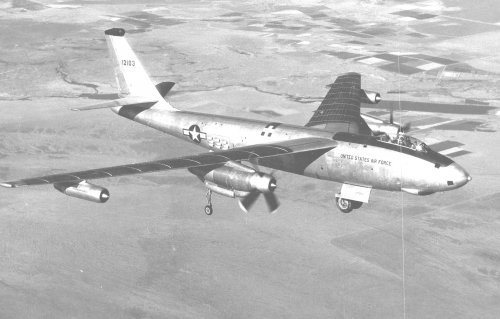

I'm not sure if I have more pictures, but I would guess the large fairing on the top of the vertical tail isn;t for an antenna, but, rather a camera fairing for recording during flight testing.
'Boeing's B-47 Stratojet', Alwyn T. Lloyd, Specialty Press, pp.186-89.
cheers,
Robin.
I will have to try and find that book, though is can you give any clue to the contents of those pages? Is it mostly documentation, or is it pictures? I am interested in both but accurate diagrams and pictures are most helpful in this case. As for the fairing on top of the vertical, I too think that it could be a camera, I have one more picture which I forgot to post last night which shows the top of the wing painted presumably black. It is also tuffed. There is a little window to the side of that fairing, and this appears as if it would give a good angle to see the tufts of the wing. I also noticed that the outrigger gear do not appear to be modifications of the originals, but new sturdier units.
Adam
