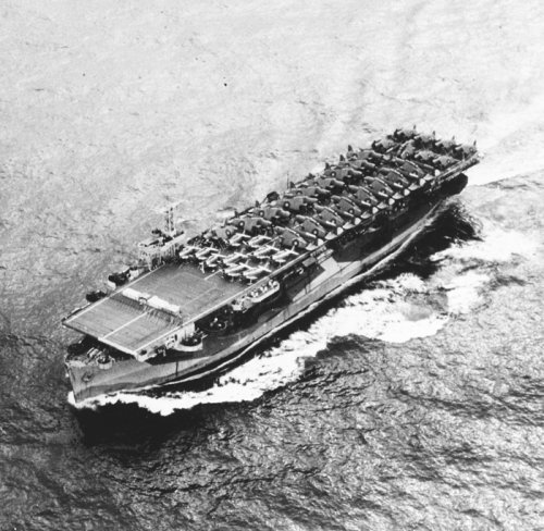

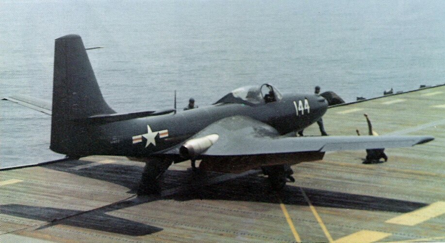

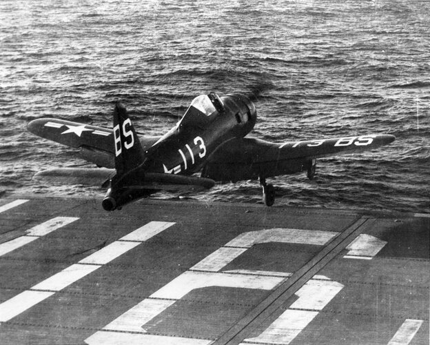

Otherwise, my research has enabled me to find that FR Fireballs have been operated from various escort-carriers, including the USS Bairoko (CVE-115), the USS Charger (CVE-30), the USS Wake Island (CVE-65), the USS Badoeng Strait (CVE-116) and the USS Rendova (CVE-114).
But the FR Fireball was not a real jet aircraft.

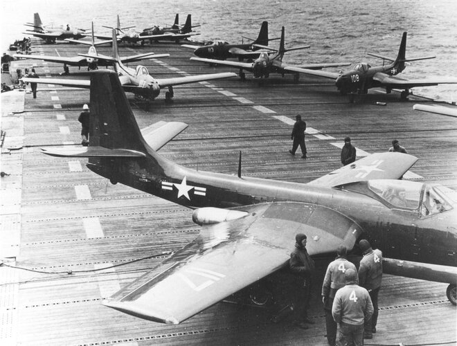

I was surprised to discover that the USS Saipan (CVL-48) operated FH-1 Phantoms of VF-17A in 1948.
It was around 200m long, making it the smallest aircraft carrier to have operated jets.
The Saipan had a long career as an aircraft carrier, until October 1957. But I have not found any other jet operations aboard her other than that of VF-17A.
US Navy FH-1 of VF-17A during qualifications on Saipan (CVL-48) (May 1948).jpg US Navy FH-1 of VF-17A on USS Saipan (CVL-48) (6 May 1948).jpg

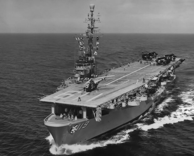

The Commencement Bay-class carrier USS Point Cruz (CVE-119) also operated S2F-1 Trackers of Antisubmarine Squadron (VS) 25.
USS Point Cruz (CVE-119) with HO4S-3S of HS-4 & S2F-1 ov VS-25 (25 June 1955).jpg USS Point Cruz (CVE-119) with HO4S-3S of HS-4 & S2F-1 ov VS-25 (January 1955).jpg
