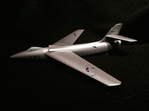

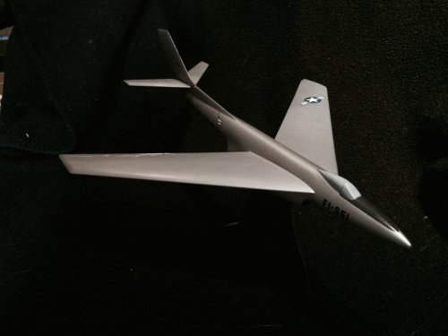

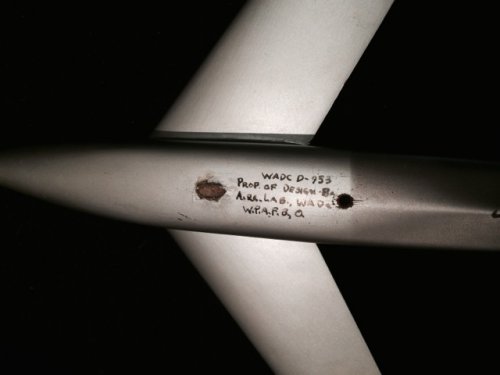

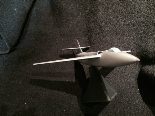

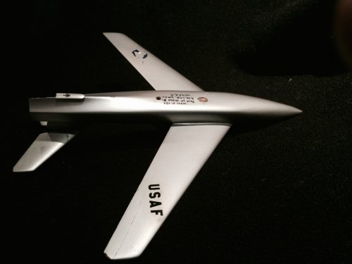

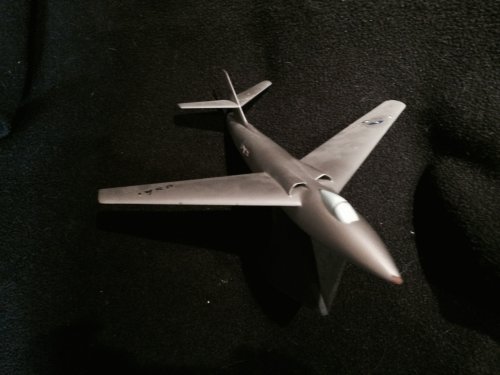

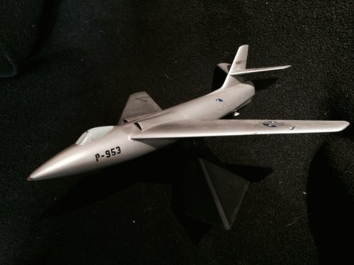

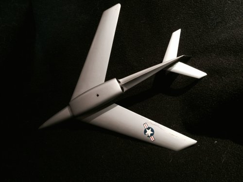

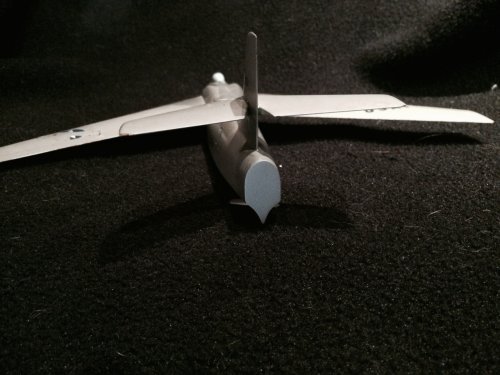

Here are some I be no one has ever seen.... Maker unknown and any insight would be great. Found at a local hobby shop in a box, long forgotten. Owner of the shop says they came from the collection of a Northrop Engineer, but these are most decidedly not from the Northrop model shop. Note the label that is hand written on model 2:
Washington DC Design D-0953
Property of Design Bureau
Air Research Labs Washington DC
Wright Patterson Air Force Base, Ohio
MODEL ONE is a twin centered engine configuration..... Fighter? Bomber? Interceptor? Let the debates begin.
MODEL TWO is a supersonic seaplane. Had the small tail ski, but the main ski/skid is long gone. Have fun and I wait with great anticipation the findings of the group.

"D-953" looks like a Douglas designation... and the design has a definite Douglas feel to it.
Very interesting projects Allysonca,
but they also wrote on one Model "P-953",and may be P designation was for Curtiss-Wright.
My thoughts were Douglas as well. The paint and the canopy treatment are consistent with other Douglas in-house models that I have have collected over the years. The silver looks to be spot on but the blue canopies are close, but not quite a match.
Interesting find. I would, however, suggest that this concerns a study only and that they needed some baseline concepts of a VTOL aircraft. In other words, it was never intended to build anything like that.
Yes my dear Jos,but only exercise Models.

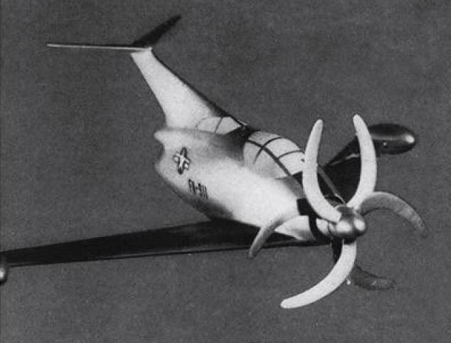

Does this strange project say anything to anyone? I don't think I've ever seen anything weirder, especially considering the "FN-" prefix on the model indicating a fighter project. Tall swept T-tail, second cockpit in root of said tail, very short fuselage, swept-wings,two contra-rotating props with three boomerang-shaped blades on each. Spontaneously I'm thinking "Republic", but it's really just a hunch with little to back it up.
I have to admit to instantly relating to a film prop or REALLY good/bad carpet.
I'm 100% sure I've seen that before. Just need to remember where.......
Never seen such design. Do you have a source?
Clearly not a "pre 1945 project" so it should be moved to the proper forum section.
It looks Republic for association with the XF-84H because of the contra-rotating propellers, the turboprop engine and the T-tail.
Who knows...supposing that's a real project.
To me it doesn't looks like a fighter, at least an air superiority fighter. The aft canopy seems to be accesible from the fuselage only, making difficult an emergency escape. And why a second member would be needed?
Also, what about the undercarriage configuration? The wing roots start almost from the nose...
Outsize props, stumpy fuselage. Could it be a tailsitter?
It does look sci-fi indeed, which is what really struck me, because it's from a serious magazine.
Please try and remember! ;)
Yep. It's from an 1953 item (from Aviation Week, I believe). I isolated it from the other designs because 1°) they seem to be mostly bombers, and 2°) they are not as remarkable, offbeat or unseen. The design is described there as "an early all-weather turboprop fighter fitted with three-blade counter-rotating propellers of swept blade design, later obsoleted by very thin straight blades." See attachment.
Oops! Been away too long from the forum. I should have known better than making that rookie's mistake! Please move this to the appropriate section.
Indeed.
To me it doesn't looks like a fighter, at least an air superiority fighter. The aft canopy seems to be accesible from the fuselage only, making difficult an emergency escape. And why a second member would be needed? Also, what about the undercarriage configuration? The wing roots start almost from the nose...
Definitely. I was thinking parasite fighter at some point, but the T-tail kind of contradicts that, unless of course it was not to be fitted under a bomber's wing, but at the wing tips.
I thought about this as well, but the absence of any kind of reinforced area or pod at the tip of the tail makes it unlikely.

The T-tail reminds of Hans Multhopp's designs (Ta 183; after the war he worked at Martin - see several Martin concepts which reflect his design imputs). Could it be from Martin?
The page's description answers that,
From 'early', 'all weather', you know that a second crewman will be required for operating the radar, so, they are in aft cockpit with pilot in forward cockpit. Several other aircraft have used similar separated cockpits arrangements, Bristol Beaufighter and Fairey Gannet come to mind.
Yes.
"Make me be a plastic model kit which has nice crew guys, nice cockpits with moving parts for crew access, operating retractable landing gear, a removable hatch over the nicely done engines, and contra rotation gearing for the props which will spin in a breeze".
