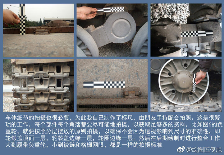

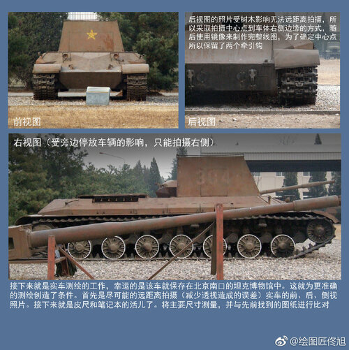

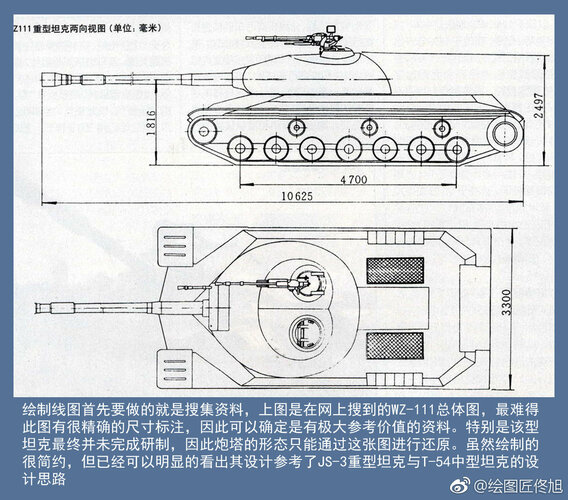

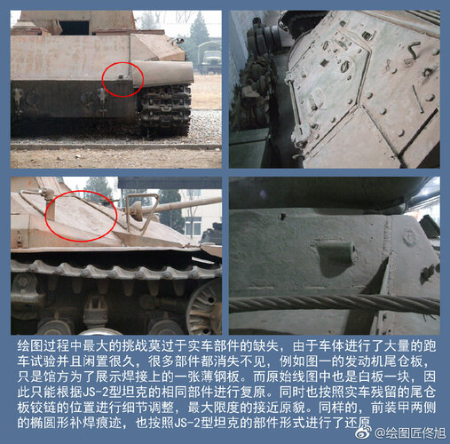

Here is some thing about how WOT build heavy tank 111
Early concept
Real vehicle has a lot of differences with the earlier concept,Front armor and track supporting wheel
Measure Size
The missing part , modeled with reference to IS-2
Turret, based on early concept,details from the Type 59,shield references the T-34/85
Early concept
Measure Size
