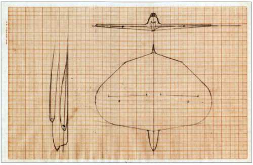

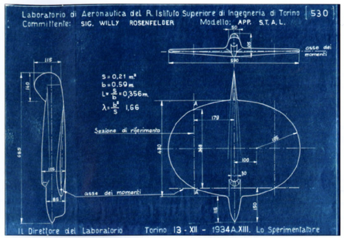

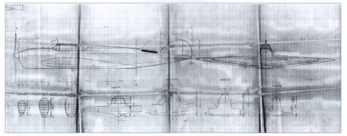

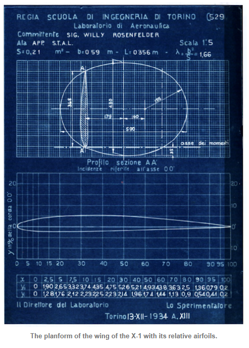

Some information on the first projects (X1 to X4) of the S.T.A.L. (perhaps Societa Torina de Aero Legero, but realy needs comfirmation) of the following website:
http://planetoplano.blogspot.com/2017/04/rosenfelders-flying-wing.html
Who knows more on the other aircraft designed by Rosenfelder and this company?
Thanks in advance
