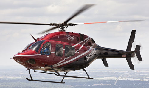

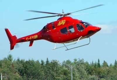

finally, you get the classical patent protection of your efforts for some period of time. A certain helicopter manufacturer in Texas was recently sued for patent infringement by a certain helicopter manufacturer based in several European countries, and the Texans lost. As a result, a certain US helicopter was not able to use a widely recognizable landing skid configuration that has become a "brand" image for the originator of the concept.
Before law suit:
After law suit:
